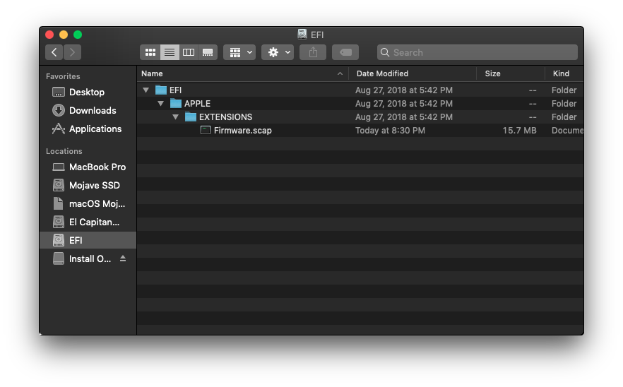

Has anyone figured out how to get rid of the EFI boot option at startup when booting onto an APFS disk after patching the EFI chip using APFS ROM Patcher 2.0? I have gone through the mounting process, but it does not show the booting files that I would delete to get rid of it.

Has anyone figured out how to get rid of the EFI boot option at startup when booting onto an APFS disk after patching the EFI chip using APFS ROM Patcher 2.0? I have gone through the mounting process, but it does not show the booting files that I would delete to get rid of it. View attachment 780365
This is a glitch with the ROM patch itself. I will be updating it in the future if I find a solution to this, but unfortunately, being at college away from my house makes testing quite difficult.

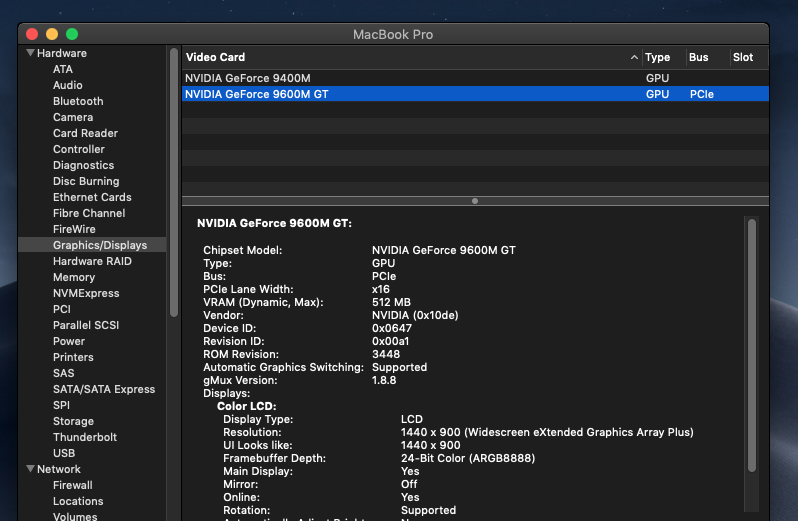

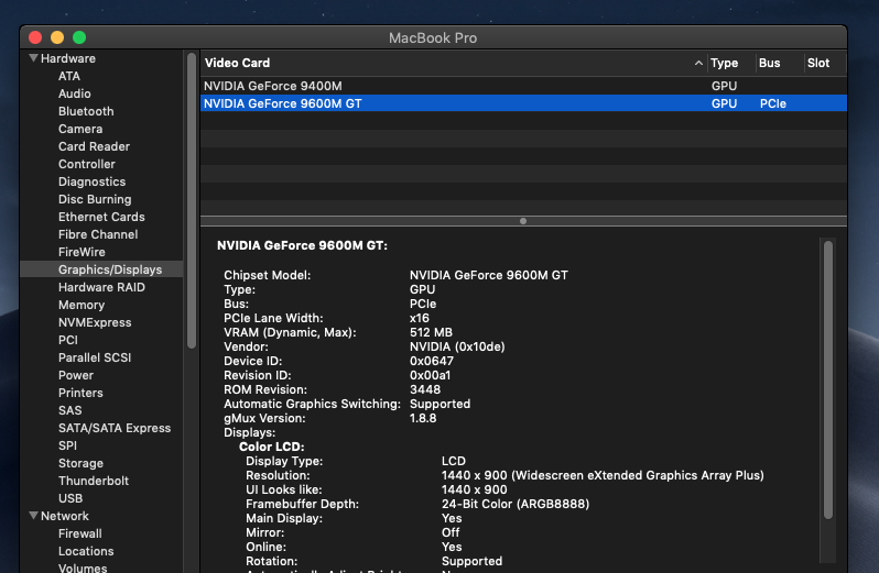

MacBookPro5,3 with "switchable" Graphics Display.
Can expert folks in this thread please explain on these two and if issues (acceleration, etc.) exist as far as Mojave is concerned?
Thank You.
Thank You.
No issues on 9400M/9600M GT based systems with Mojave (except for the minor graphics anomalies in light mode as all non-Metal GPUs produce). You can use the Energy Saver pane of System Preferences to switch GPUs.

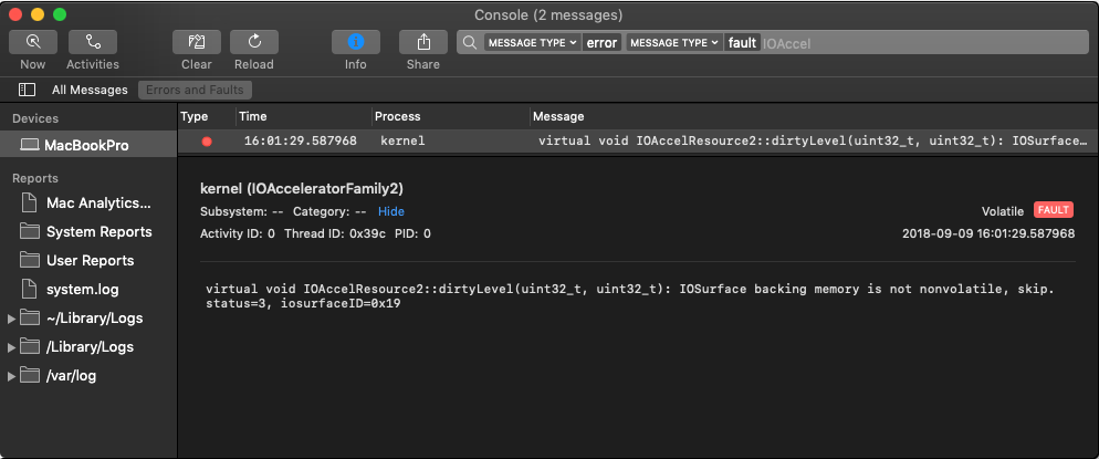

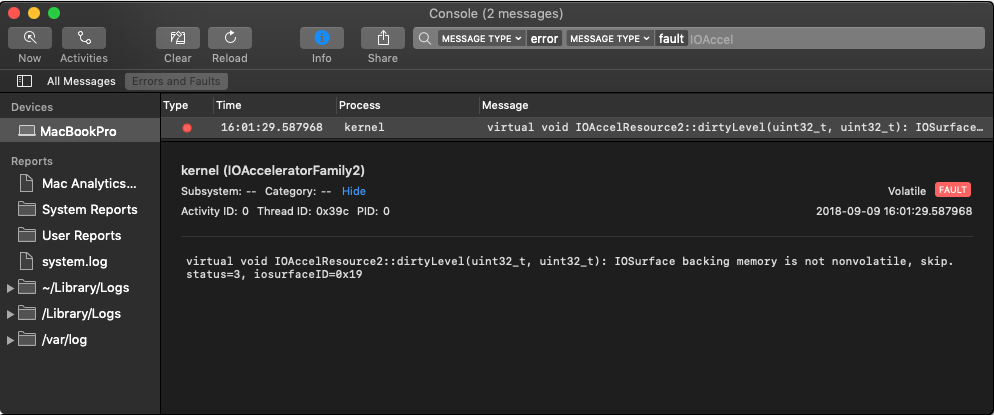

Well, normally.. using CoreDisplay stock binary from 10.14 Beta; what error appearred on Console's log when switching from Dark to Light mode was:
Code:
WindowServer (IOAcceleratorFamily2)...
...but, with CoreDisplay from 10.13.4 what I get is:
Code:
kernel (IOAcceleratorFamily2)...
So, I think.. a weird grayed Top Menu Bar with LightMode appearance is not caused by CoreDisplay (though, I could be wrong for sure). Graphics acceleration under 10.14 Beta (18A384a) are still working fine with 10.13.4's CoreDisplay (on my case), but.. it doesn't fix this Top Menu Bar issue. FYi only.

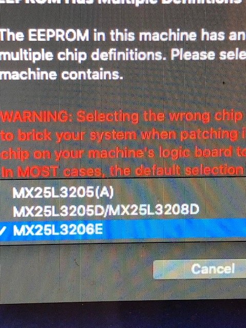

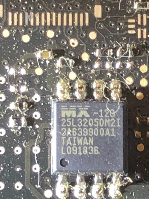

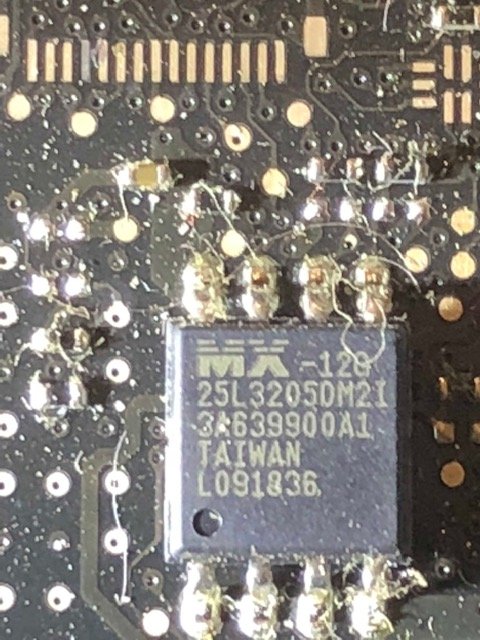

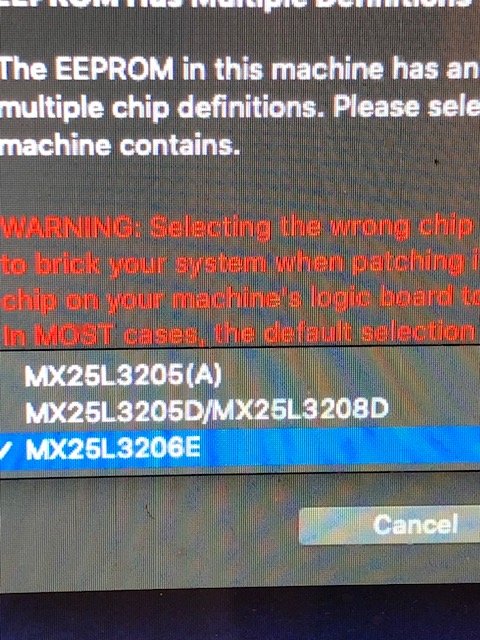

Actually I have 2 questions:
- I have MacBook Pro mid 2009 5.5 and I install Mojave latest beta on ssd formate APFS and it boot APFS with patcher and I receive updates . so I do not apply rom patch .. what is the issue if I stay like that and not take the risk to patch rom beside those text shown in the boot .
- Second question I try to patch rom I got 3 choices for my rom ID ( picture attached ) and I make picture from MB so which one I must choose not to damage it .

View attachment 780392 View attachment 780393 Actually I have 2 questions:
I would advise to NOT risk, and stay HFS+ with Mojave, or with APFS "Software" EFI patch.
Should be the second choice, but many here (me too) have bricked similar machines even taking the "correct choice".
But the user "victor30r" asserted had bricked with very similar as your machine, un-bricked with firmware restoration cd, and then re-done the APFS ROM patching and successfully obtained APFS working natively.
Here the conversation: Intel Macs Firmware Restoration CDs
victor30r answer
(follow the conversation from there and, if you don't speak the victor30r's language, use the translator as I did)
I also advise you not to risk if you don't exactly know what you are doing; I did it with a MacBook Pro 5,3 (choosed the second opinion btw) and bricked my machine – 200€ for the repair service, that included the replacement of the chip itself. Be also aware that the Firmware Restoration CD doesn't work with all Mac models.
Code:
Code:
The main menu bar is mostly controlled from the HIToolbox framework (within Carbon). There you can eliminate the weird grey menu bar so it displays white in Light and black in Dark. An easy "workaround" if you can live without menu bar transparency.
While, as per your previous explanations, the vibrancies, in particular "light mode" greyed "windows-side-bars" in Finder and core Apps are controlled into the Appkit.framework , if tomorrow GM will be released, could you release a preliminary beta "hybrid light mode" ?

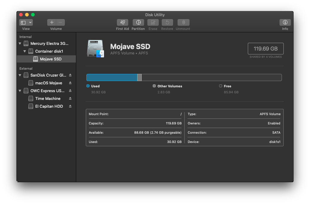

Strangely, the Convert to APFS option in Disk Utility only converts single HFS volumes at a time so you end up with the recovery partition outside of the container for the converted APFS partition. Apple hasn't current a tool yet that allows APFS partitions to be moved across containers or merging containers.
So what happens if you go ahead and convert the recovery partition to APFS?
Reactions: TimothyR734
It would end up in its own separate container instead of the normal partitioning of...

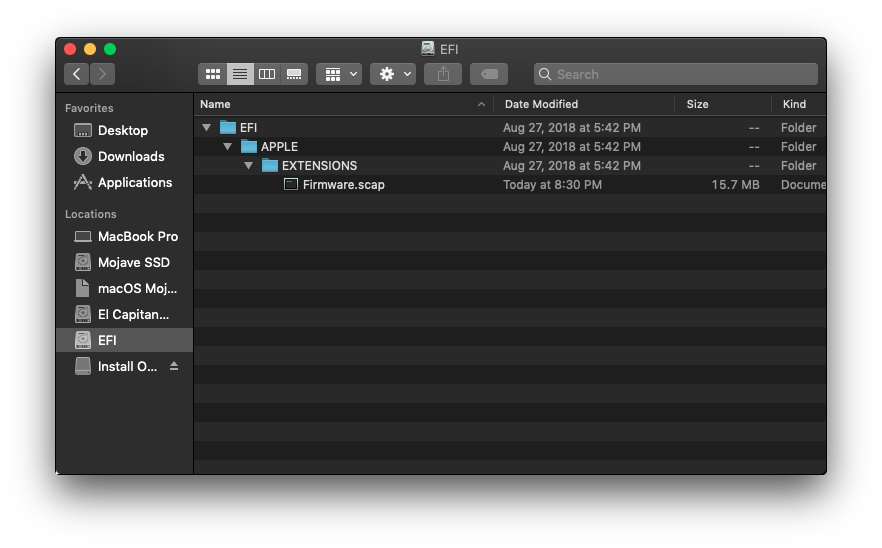

I ended having to destroy the gpt partitioning and reformat as APFS from scratch in order to purge all traces of the APFS patching even after manually removing the installed files. It actually is advantegous to clean install from a freshly partitioned disk. Strangely, the Convert to APFS option in Disk Utility only converts single HFS volumes at a time so you end up with the recovery partition outside of the container for the converted APFS partition. Apple hasn't current a tool yet that allows APFS partitions to be moved across containers or merging containers.
I’ve done some investigating and what i came up is what it does when you convert to apfs is just move the OS volume and the VM into the container, keeping the recovery partition outside of it and not creating the Preboot at all. It isn’t until you do an installation (update, reinstallation or clean installation) of OS that it moves the recovery partition into the container and creates the Preboot volume. I have screenshots that I will edit and post once I get home.
EDIT:
Before install:
Post Install:
Out of curiosity, how did you destroy the gpt partitioning completely?
