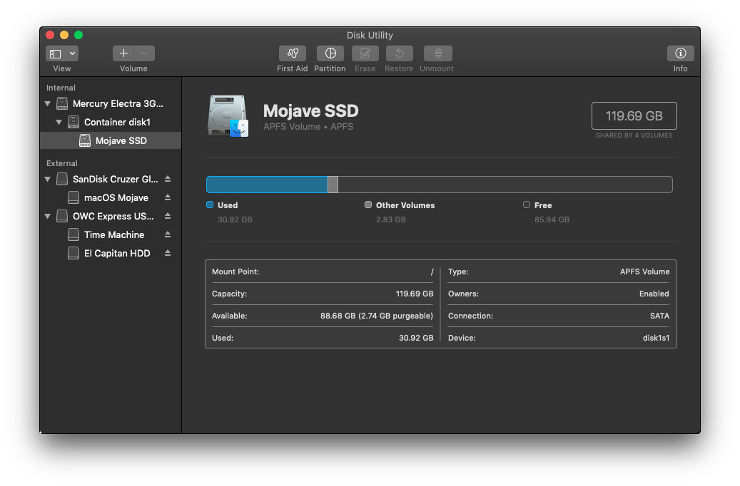

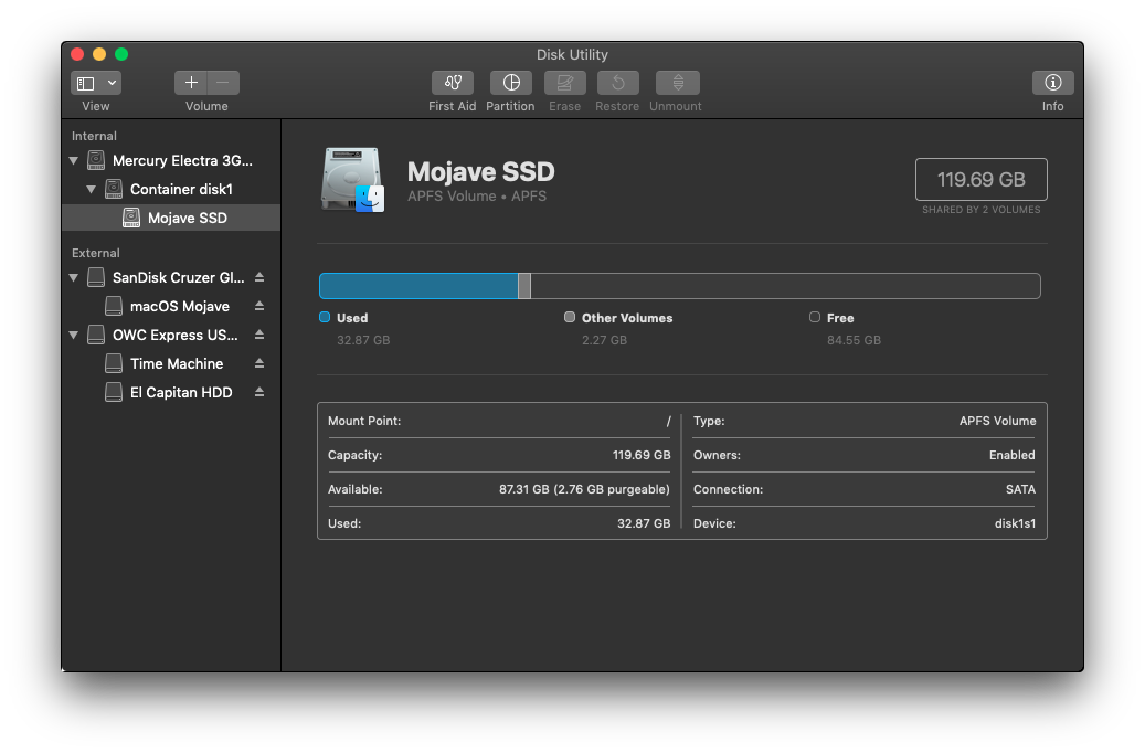

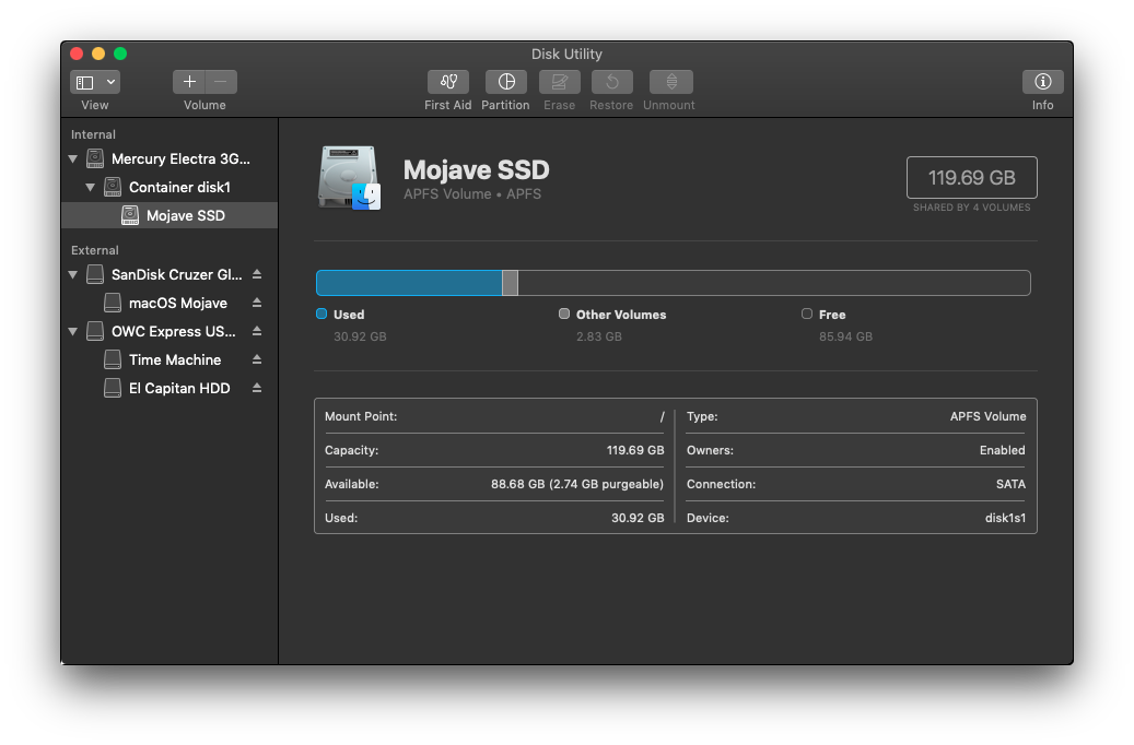

I’ve done some investigating and what i came up is what it does when you convert to apfs is just move the OS volume and the VM into the container, keeping the recovery partition outside of it and not creating the Preboot at all. It isn’t until you do an installation (update, reinstallation or clean installation) of OS that it moves the recovery partition into the container and creates the Preboot volume. I have screenshots that I will edit and post once I get home.
EDIT:
Before install:View attachment 780464
Post Install: View attachment 780465
Out of curiosity, how did you destroy the gpt partitioning completely?
It is fairly easy. Re-format the whole HDD (or SSD) on MBR with Fat32, then re-format with GPT with APFS or HFS+. For Hackintoshes with Clover, this is the best way to remove all traces and start from scratch.
