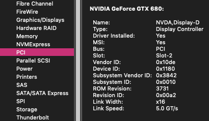

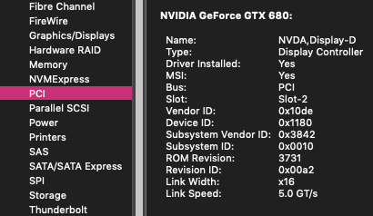

PC GTX680 flashed to Mac efi rom seems to get 5GT/s in Slot 2

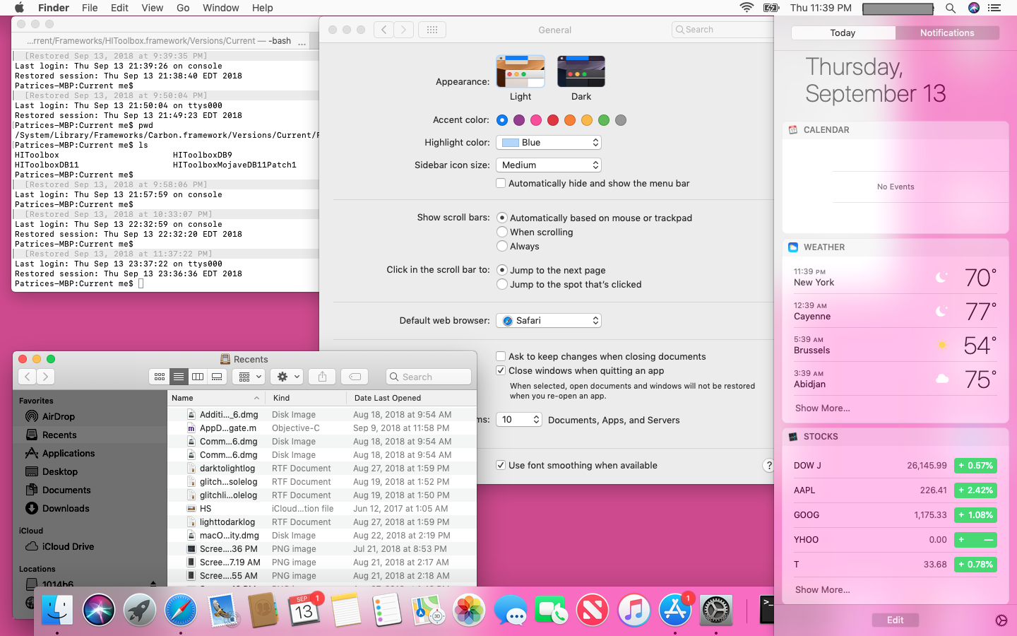

Okay, my mac mini 5,2 won't update, booted off the usb stick and reran the post install program ensuring the update patch option was selected.. Rebooted and alas, it will not update to the PB10 which is considered the probable GM.
Had to start from scratch, the patcher DID download the latest potential GM, installed along with deselecting the video card patch in the post mac install app and all looks good.
That's odd, my Mac mini 5,1 updated from PB9 to PB10 flawlessly today from the OTA update offered internally by System Preferences. Same as with the update to PB9 last week, there was no need to interrupt the update process to reinstall dosdude1's patches before my machine completely restarted into the newest version.
Just like the PB9 update, the only things missing/broken after the restart were sound (no output - although, curiously, input seemed to be working) and Night Shift (no pref pane). Simply had to run the Patch Updater from inside PB10 to reinstall Legacy Audio and Night Shift patches (I actually reinstalled all of them, to keep it simple) and, then, reboot. Afterwards, everything working as it should be.
Don't know actually what the differences are between the Mac mini 5,1 and the 5,2 -- probably different graphics cards, maybe other things too -- but one wouldn't think they were that great to completely stymy your update attempt.
Am curious now as to what is actually occurring during these latest updates. Are the Legacy Audio and Night Shift patches the only ones that are still getting overwritten during the updates -- or are the other patches, like Software Update, SIP Disabler and Legacy Video Card, no longer needed on my machine? Was Legacy Video Card patch ever needed on my Intel HD 3000-based Mac mini 5,1 in the first place?
Just to clarify, you are testing under macOS and not BootCamp Windows 10, right? I ask because what I had read about PC ROM'ed GTX 680 was that under macOS you would get 5 Gbps but under Windows you would get 2.5 Gbps. So flashing the card gets you option boot on macOS and 5 Gbps on Windows.
I’m on a Mac Pro 3,1 which is card’s speed is negotiabled at startup with EFI. Since that is missing, it keeps the lanes x16 but justs at 2.5GT/s speed. So the bump to 5GT/s does not occur. If it was a 4,1 or 5,1 it would bump when called upon. All testing on Mac.
I have a Windows setup on another 3,2 but it’s a flashed and modded AMD card thst rush 5Gt/s on Windows and Mac just have a driver limitation on that card with Mojave and really Sierra and High Sierra.
What is weird is when I really tax the card in Heaven benchmark or in Fortnite the speed does get better. Got Max 120fps in Fortnite and hovers around 60-74fps. Max FPS in Heaven was 75fps And had some really high readings at times with Cl!ing with Metal. When I get those really good rates will check the speed. Could just be using more lanes.
I also got really crappy rates times as low at 3fps in Fortnite and 17fps in Heaven. So kinda weird performance. When that started it seemed to stick. Then taxing the card with the highest setting in Fortnite would increase performance.
Heaven benchmark renders really well with the Titan.
Also what is strange is Fortnite runs the same as my Maxwell Titan X thst was flashed but did not pay as much attention to when it ran at 5GT/s. I sold the card because of cost and was bored because there were not web drivers for it yet.
Overall I lucked out with the Kepler Titan card. For it being about 5 years old it’s still a stout card and in everyday use the UI keeps up nicely. The 5GT/s is more of a vanity thing than anything.
I also noticed that almost all other devices on the PCI chain run at 2.5GT/s this includes CPUs, WifFi and Ethernet.
Only my OWC PCIe 1TB SSD runs at 5GT/s but uses two lanes.
I also have a 2TB RAiD0 SSD that uses 4 500GB drives on two SATA 2 slots and each runs at 2.5GT/s but since it is using two slots I essentially get SATA 3 or 5GT/s speeds.
In everyday operation honestly in a video card you do not really see or feel the difference between a card at 2.5GT/s at x16 or a card at 5GT/s at x16. All you can do is measure the throughput.
I also get good speeds from CPU to GPU. Around 22Gb/s.
A new issue with the Mojave GM installed on my mini 5,2. Sleep doesn't work. Doesn't sleep at the programmed time, even stranger is I can't force it to sleep, I.E. click on the , select sleep and nothing happens.
Okay wizards, how do I fix this?
Reactions: TimothyR734
If it's the model with an AMD Radeon HD 6xxx series GPU, sleep mode will not work due to lack of graphics acceleration.

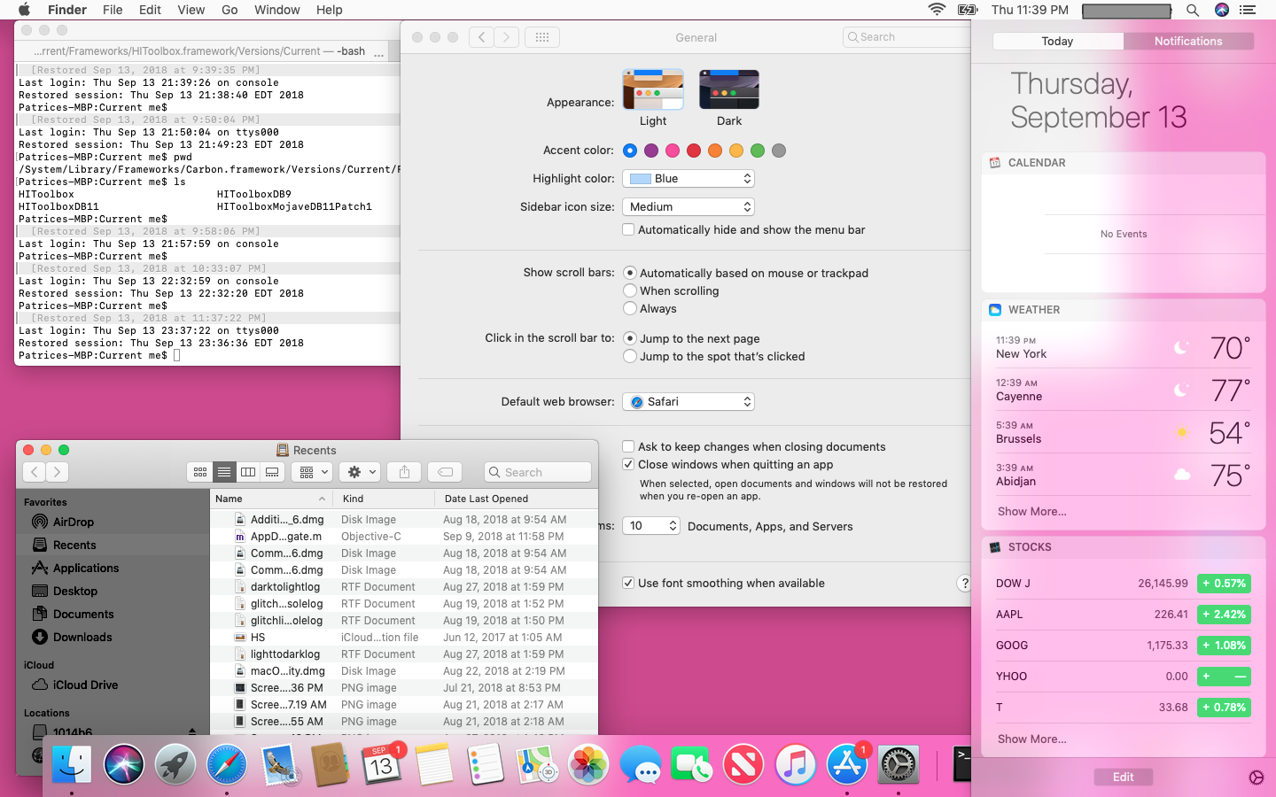

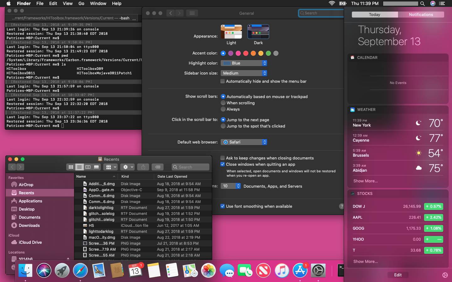

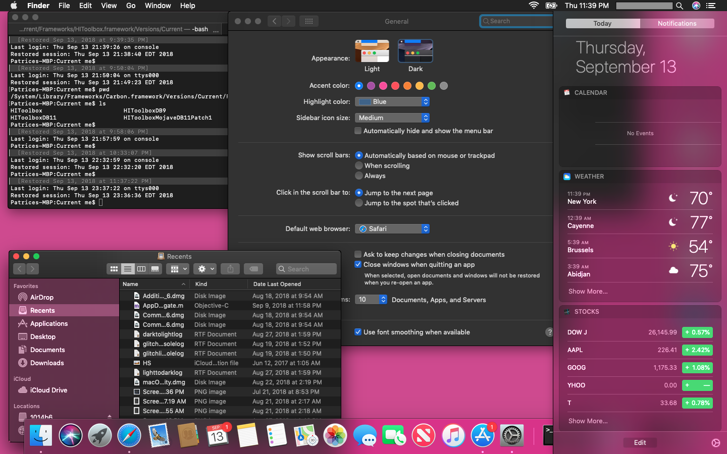

While reduceTransparency is a legitimate workaround for the ugly grey menu bar, I find that it has too broad a system impact: effectively zapping transparency all over the place - especially the dock etc. You're left with a dock and notification sidebar panel (for example) that are barely visually functional. At least for my poor eyes...
I found a software switch in HIToolbox that simply turns menu bar transparency OFF. Unfortunately it is not available as a setting, environment variable or default - the equivalent of an HIMenuBarOpaque application plist setting would have been really nice, but Apple doesn't always make this easy.
Anyway, it's a one byte patch that easily (and harmlessly) flattens the menu bar to white or black (Light or Dark mode) but preserves all other functional transparencies. See below:
Screen Shot 2018-09-13 at 11.39.44 PM.png Screen Shot 2018-09-13 at 11.39.25 PM.png
PM me if you're interested in the details or want to test the HIToolbox DB11 patch. At least it takes care of the grey menu bar (without affecting general transparency/vibrancy) which in my opinion is the most egregious aspect of the Light mode bug.
As far as AppKit and the ugly sidebars (in Finder and other apps), swapping Light mode processing for Dark mode is still an option (per my previous screenshots) but has some side effects I am not pleased with: dark window bars and obscured function bars in some apps. I've found that these "modes" are not consistently implemented - for example while my "Hybrid" mode looks good for the Finder AppStore and Xcode, News and iTunes look a little quirky. Still work in progress.

View attachment 781474 View attachment 781475

Yes, I'm interested in testing your patch, thank you.

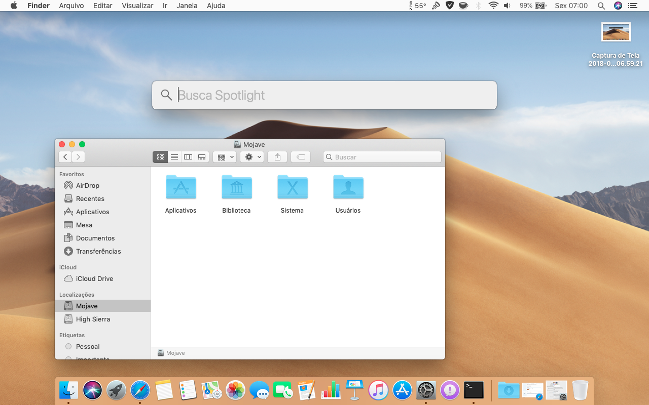

I can assure my "hybrid reduce transparency" keeps all the stock "light mode" transparencies for Dock and Notification Center, even switching the "dark mode" its stock ones are kept, and until a restart or logout they will work fine.
Please re-check I've added some screenshots: Mojave hybrid reduce transparency for light mode
edit:
It seems to work even after the sleep lock screen, just don't switch between users and it still stay on hybrid transparency.

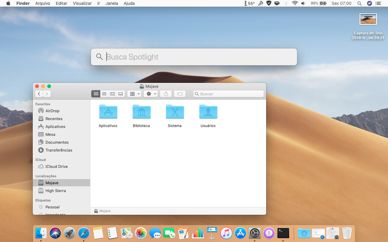

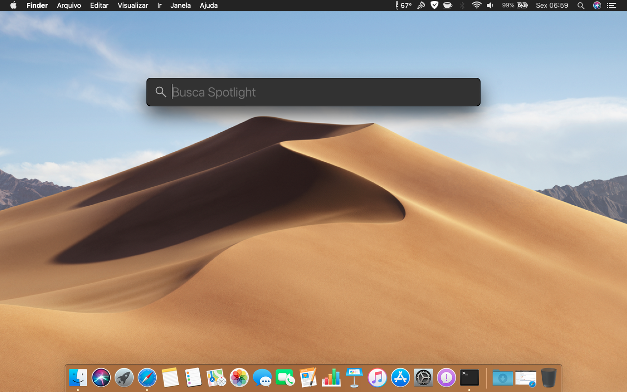

The only thing that interests me is the transparent Dock and joking with its solution I got something interesting too, instead of finishing the Finder I did the reverse process.
Enable transparency reduction in the System Preferences.
At the terminal:
defaults write com.apple.universalaccess reduceTransparency -bool false
killall Dock; kill NotificationCenter
killall Finder (only on Darkmode)
and I had an excellent result.
the lateral corners were removed (Spotlight).

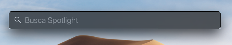

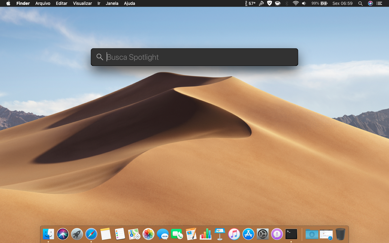

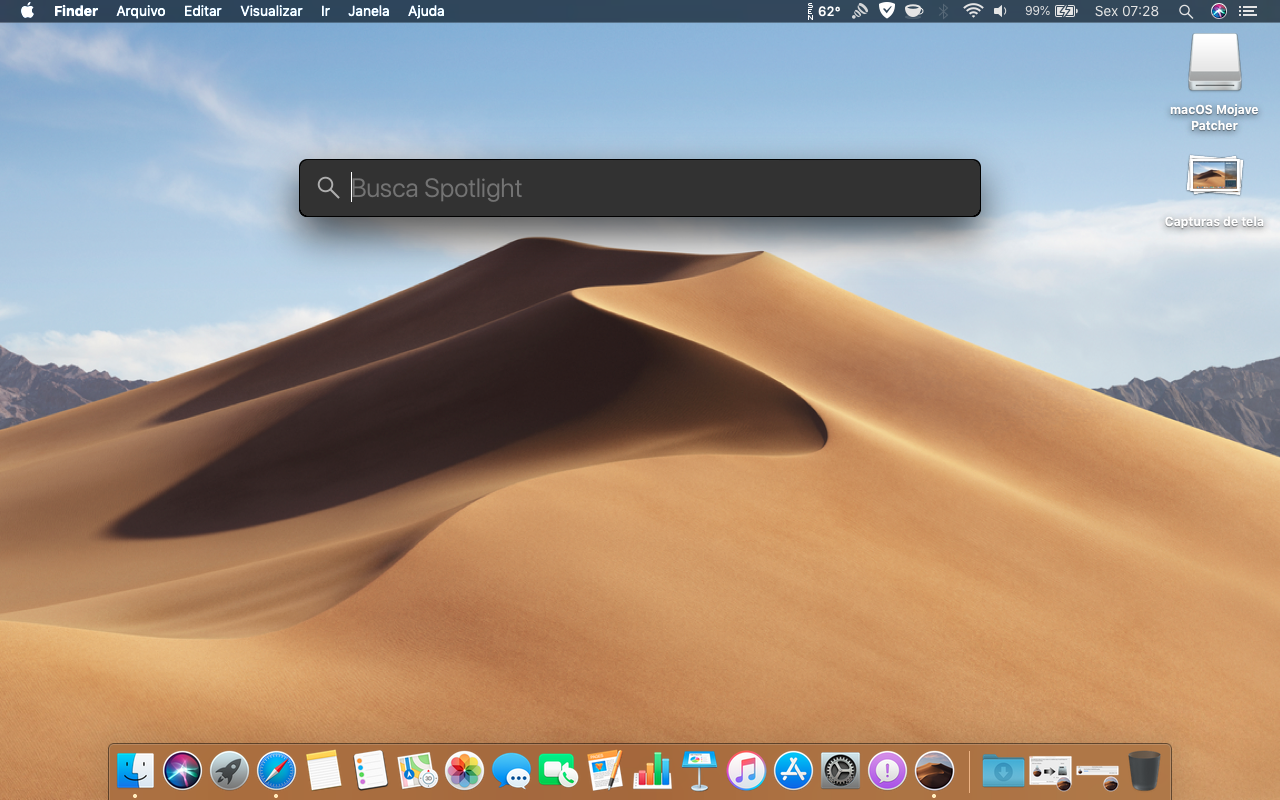

[doublepost=1536919348][/doublepost]
[doublepost=1536920972][/doublepost]

I enabled the reduction of transparency, I made the command:
those lateral corners are gone.
[doublepost=1536919348][/doublepost]View attachment 781600 View attachment 781601
Yes, it makes sense, you did the opposite reasoning, but first applying my Terminal reduceTransparency true is mandatory to make those following commands to work properly, otherwise Finder won't be affected by full opacity. Unless you applied first the global reduce transparency from the Accessibility prefpane.
Agree on killall Finder (only on Darkmode), to bring back the Finder transparency in dark mode, but if you use the mojavehld.command just type the choice number 2, it will be there again with the stock dark mode (and light mode too, they can't be split).
Anyway I don't understand yours "lateral corners", I mean I don't have them at all.

Ok, I've re-checked, Spotlight app manages itself its own blur shadow, so for those used my method, just type from Terminal to obtain transparent shadow under Spotlight search:
killall Spotlight
I'll update my previous script.
edit:
fixed on the previous post, thanks for pointing out the "Spotlight" shadow border issue.
killall Spotlight
edit:
