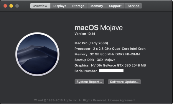

The GTX 680 works great on the 3,1 running macOS Mojave which was installed using dosdudes amazing patcher. :)

Several users are using the GTX 680. I believe any Kepler Nvidia card will work. I am running the GTX Original Titan 6GB card (Kepler) and it's running extremely well. No tearing or artifacts. works with Mojave drivers out of the box much like the 680. Mine is a PC Card, unfleshed for Mac. runs x16 2.5GT/s. flashed cards on the Mac Pro 3,1 run at 5.0GT/s when called upon a task that requires it.

I managed to find a GTX 680 Mac Card for £119.99 on Ebay, reckon I will take the plunge, should get it after Mojave is released now.
If it's a true mac edition (non-flashed) the transition should be seamless. No vibrancy or Light mode glitches. You'll be pleased.
