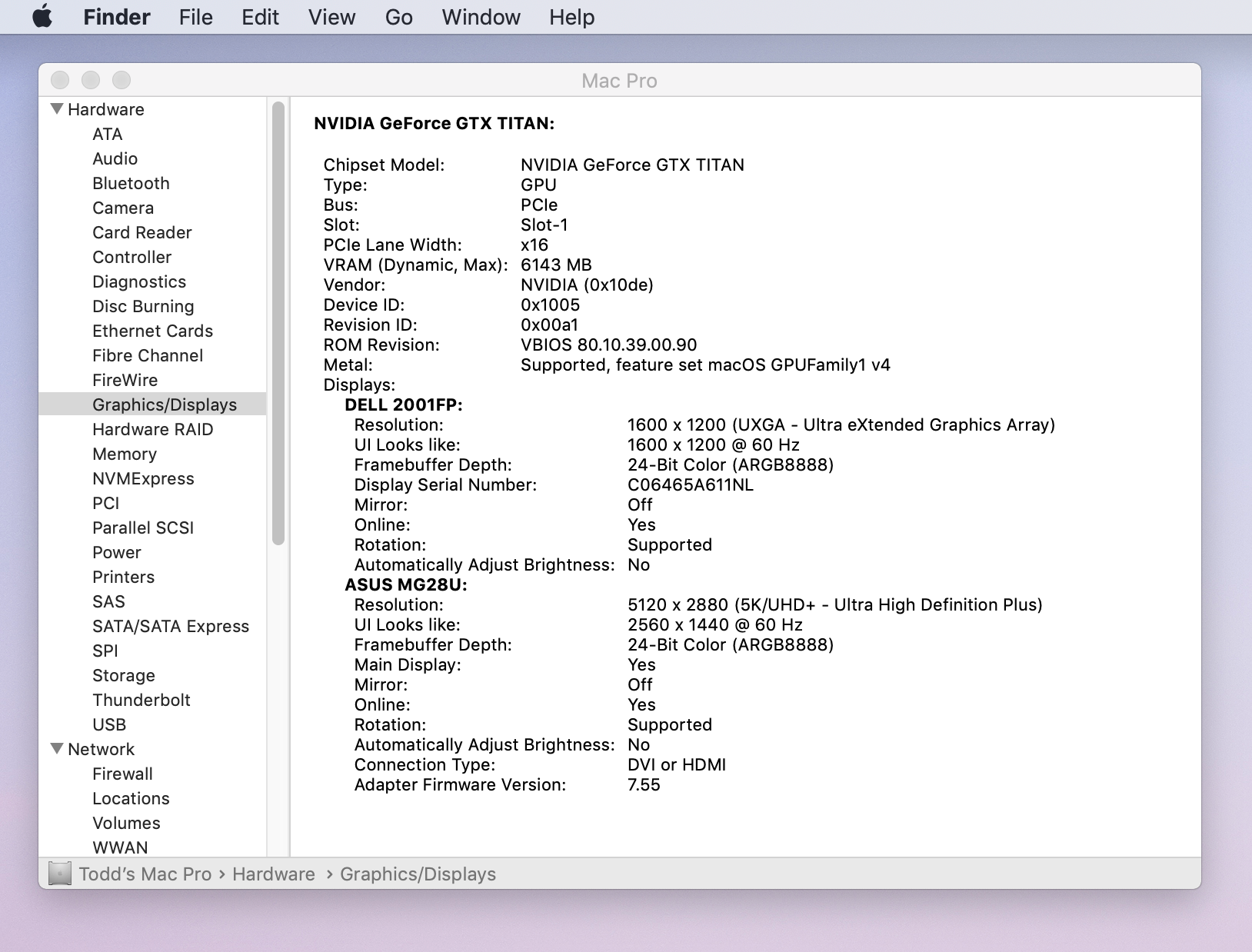

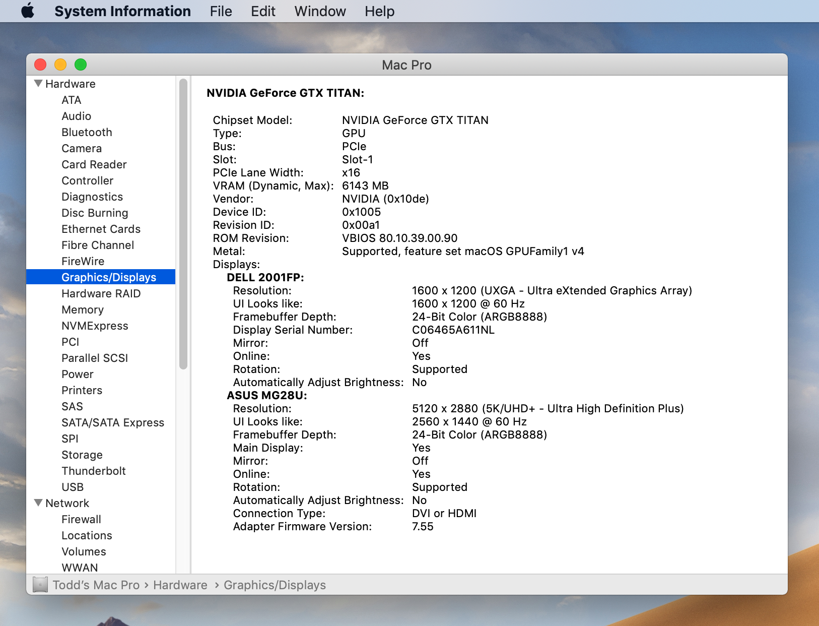

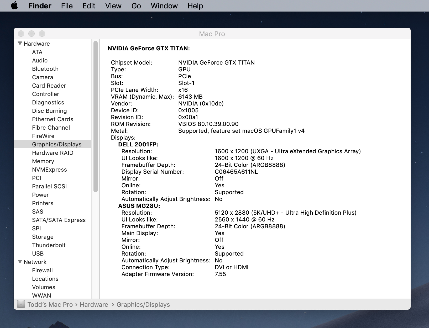

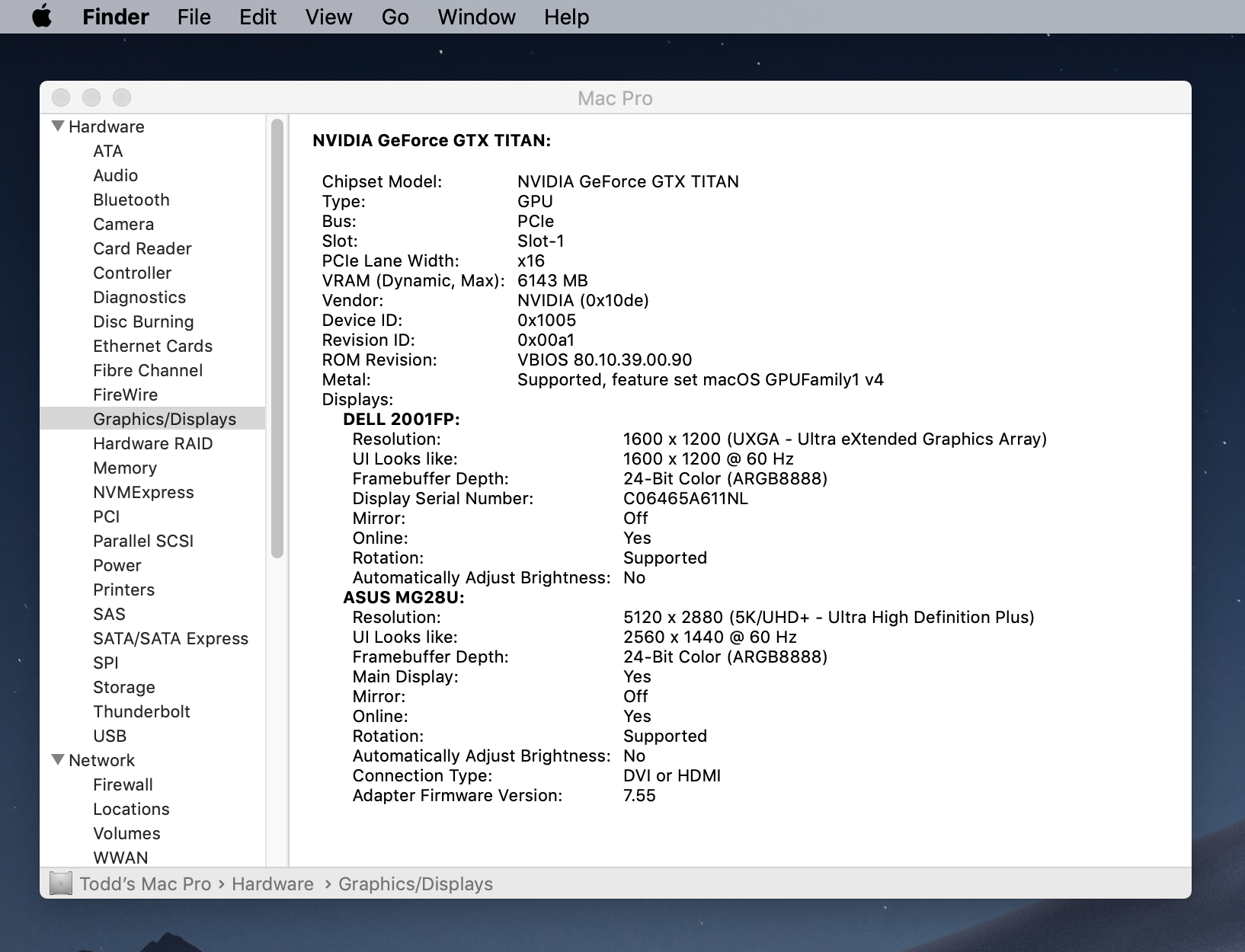

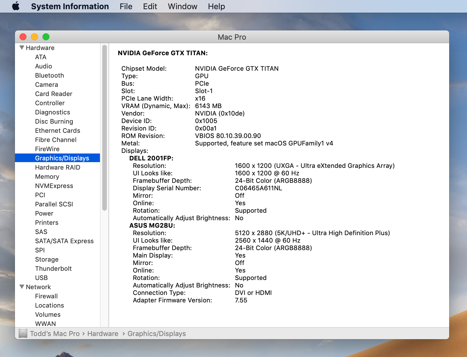

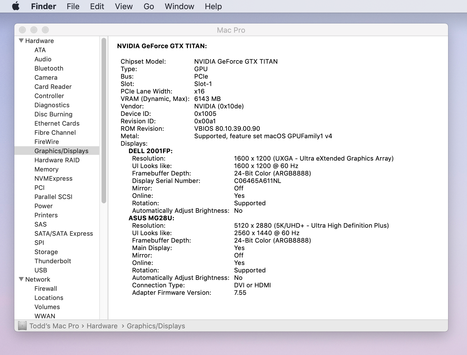

A graphical alternative to getting light mode to work:
By the way since the menu bar shows the background you could make a background image that has a white layer on top of the background image. This would be another workaround for light mode and it would not require swapping frameworks or kexts. I could make a photoshop action that does this or possibly make a webpage in javascript that could do this as well. This would just kill dynamic backgrounds unless there is a way to make these with the menu bar area fixed in the dynamic background.
