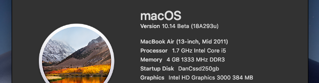

Update on Mojave testing on this unsupported MBAir 13" mid 2011
Instead of using USB thumb drive for the boot partition, now I am utilizing an External SSD drive. Performance is much faster.

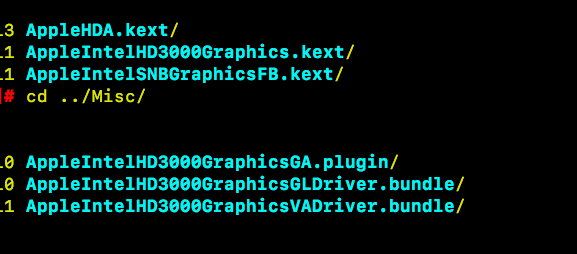

Also, fixes to bugs encountered (namely no sound, graphics issues like in maps, and others), I copied the following kext, bundle and plugin files from High Sierra
Testing will go on. I'm actually liking Mojave and will be my main MacOS as betas are made available.

Try to remove from Mojave disk path S/L/E all HD3000 kext, leave only AppleIntelSNBGraphicsFB in conjuction with AppleIntelHD3000 just this two kext, reboot in safe mode holding shift key targeting the Mojave disk.
If remove all kexts hd 3000, and copy two kext AppleIntelSNBGraphicsFB with AppleIntelHD3000 its loadind in vesa mode with glithes and lags
This is the only way at moment, with Framebuffer enabled just achieve VRAM and maybe some resolution switches but don't expect less glitches and lags.

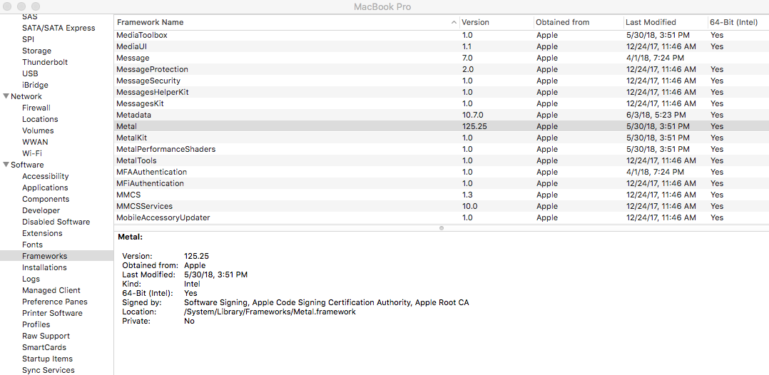

Metal is definitely supported by my hardware in High Sierra:
My question is has anyone got it to work yet in Mojave?
[doublepost=1529340655][/doublepost]I don't think support for Metal 2 was the reason that Apple set the support cutoff where they did.
No, it's not. Try some tests (gfxbench metal from app store, or opengl extension viewer from app store), or use google. Metal only supported on Radeons from GCN arch. On your screenshot, we see only a loaded framework. If you have a Metal supported GPU, system profiler tells it to you under the "Graphics/Display".
