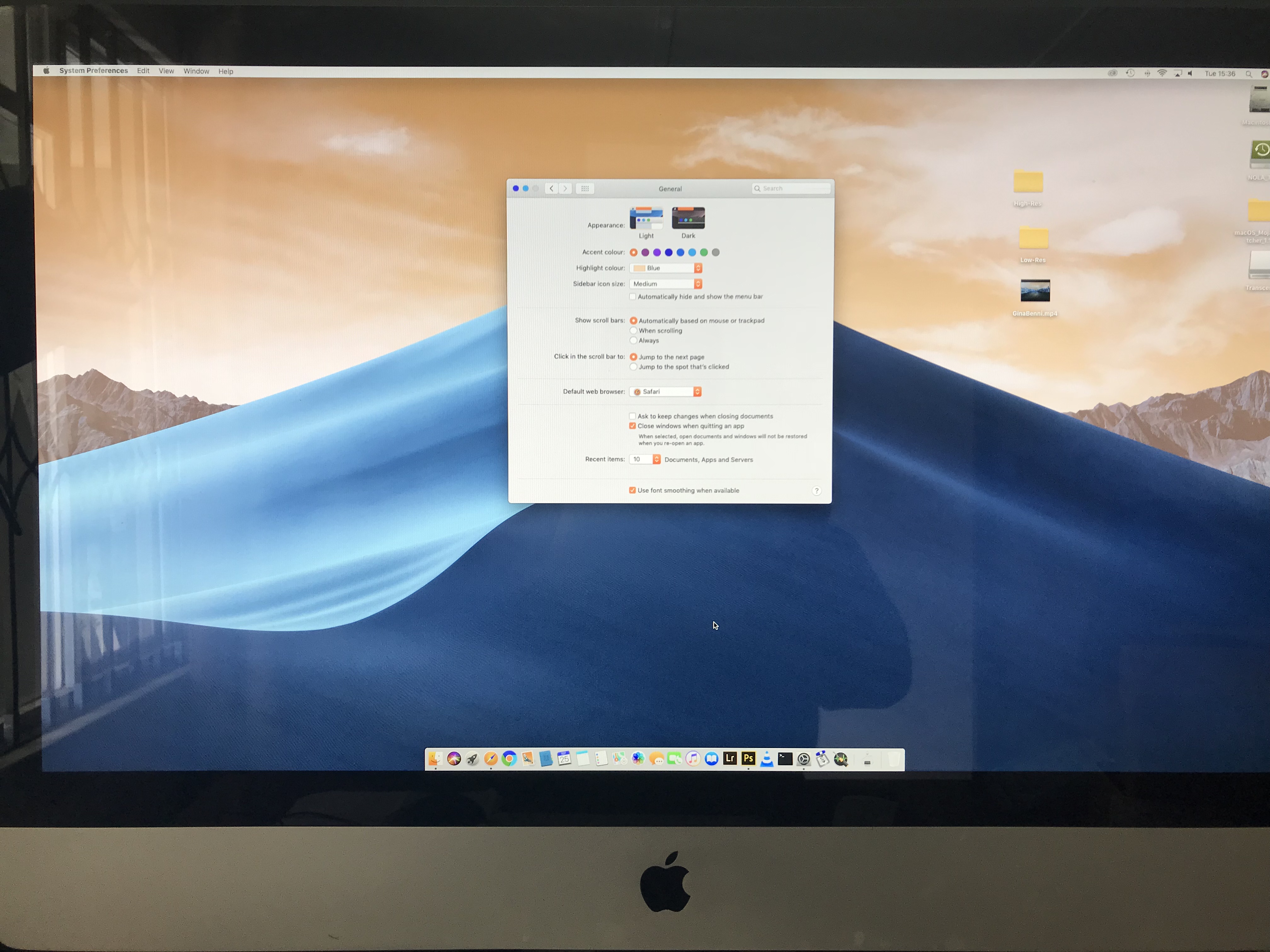

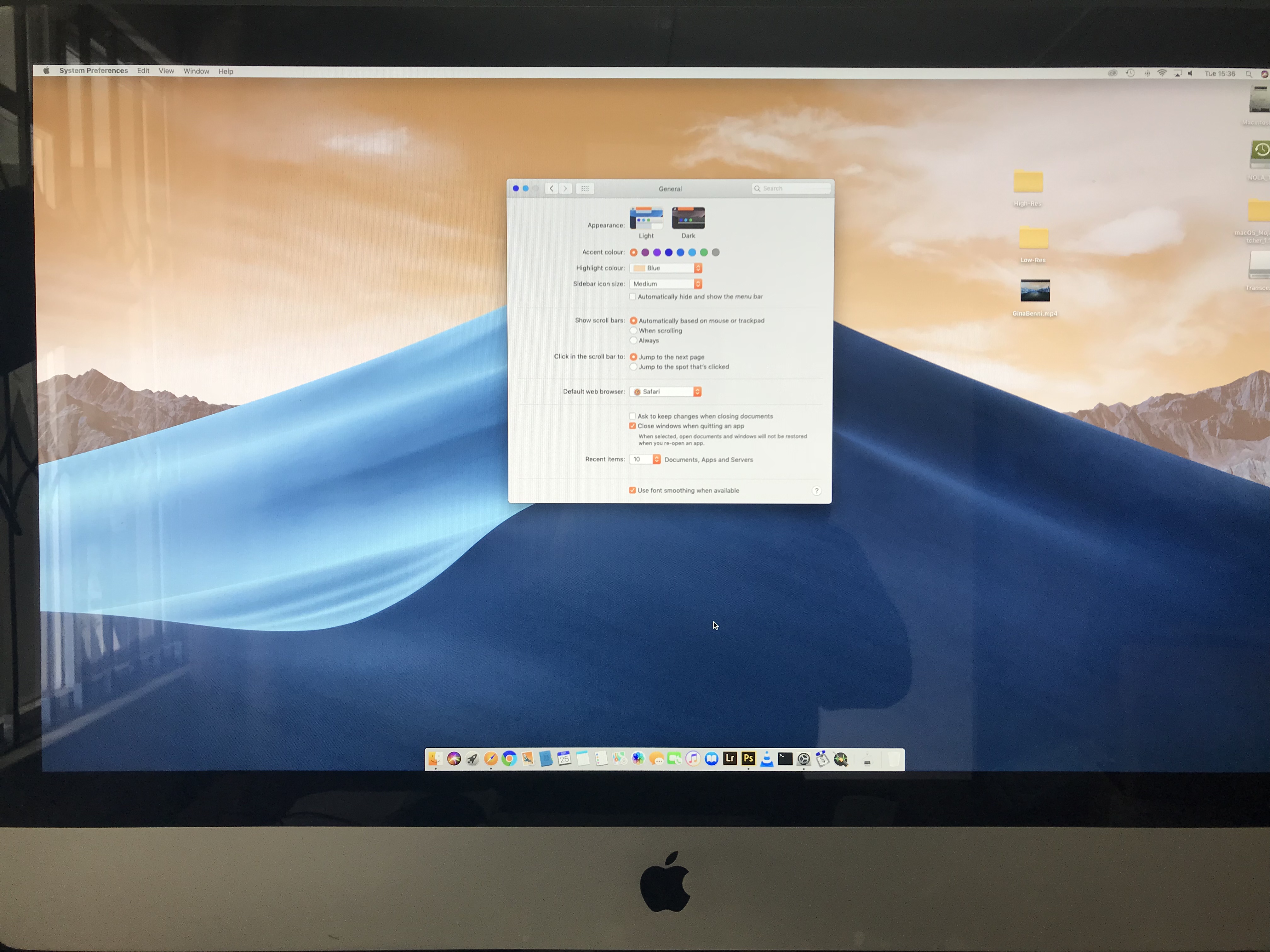

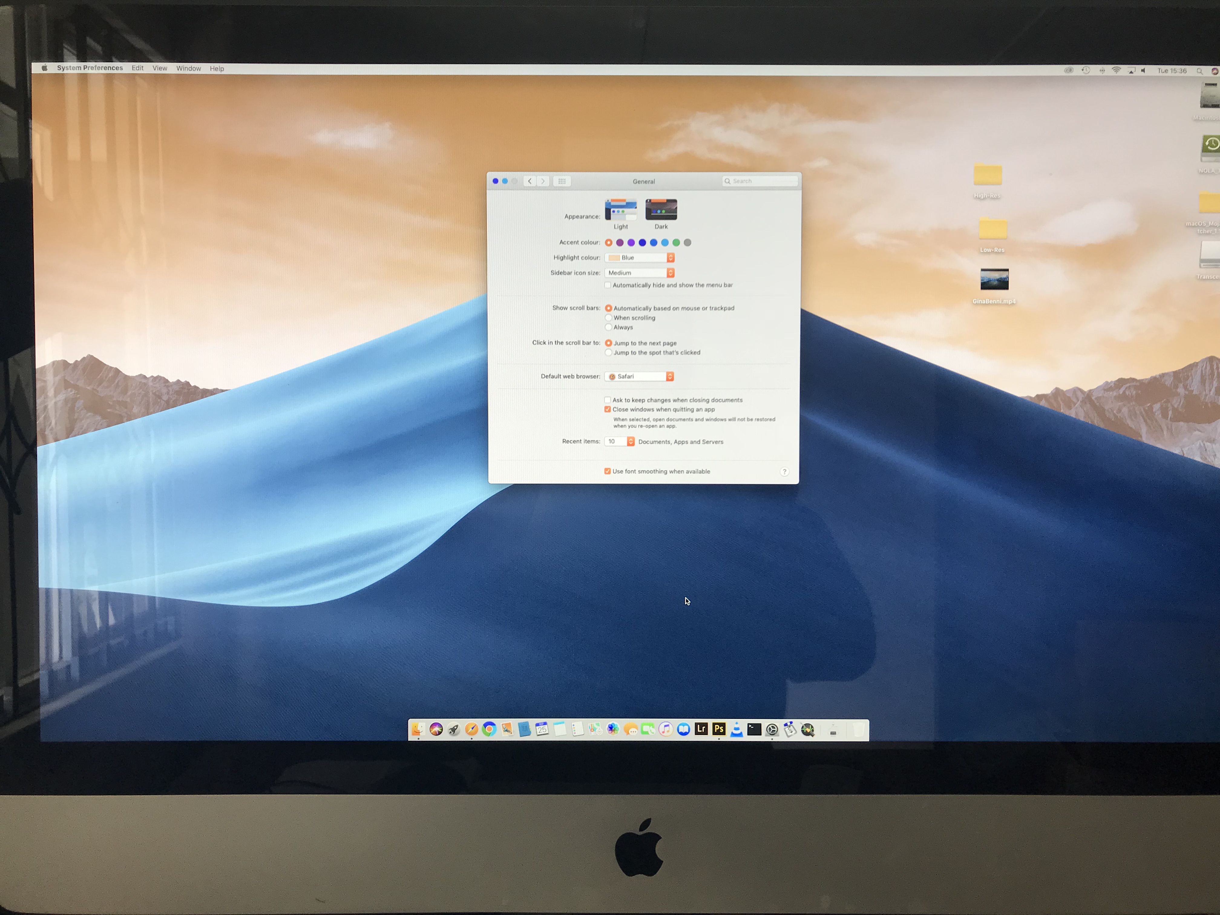

Thank you! That worked. Thought I’d bricked my iMac for a second. Good thing I had a wired keyboard lying around too.
Now the only issue is the weird inverted colors! (See pic). Is there a solution for this or is Mojave broken until someone figures out how to enable Metal and acceleration on AMD cards?
What a shame...
there is but this will make your imac a bit slower in graphics animations, go inside System/Library/Extensions and put into the trash this file: AMDRadeonX3000.kext then reboot
Thanks again, that fixed the colors. But like you said, sloooow animations and no transparency. Feels like I’m back in 2011 :p

To disable acceleration you have to unload the AMD FB kext, a quick way is to check if in your System/Library/Extensions there is this kext AMDRadeonX3000.kext if is there simply drag into the trash and reboot.
