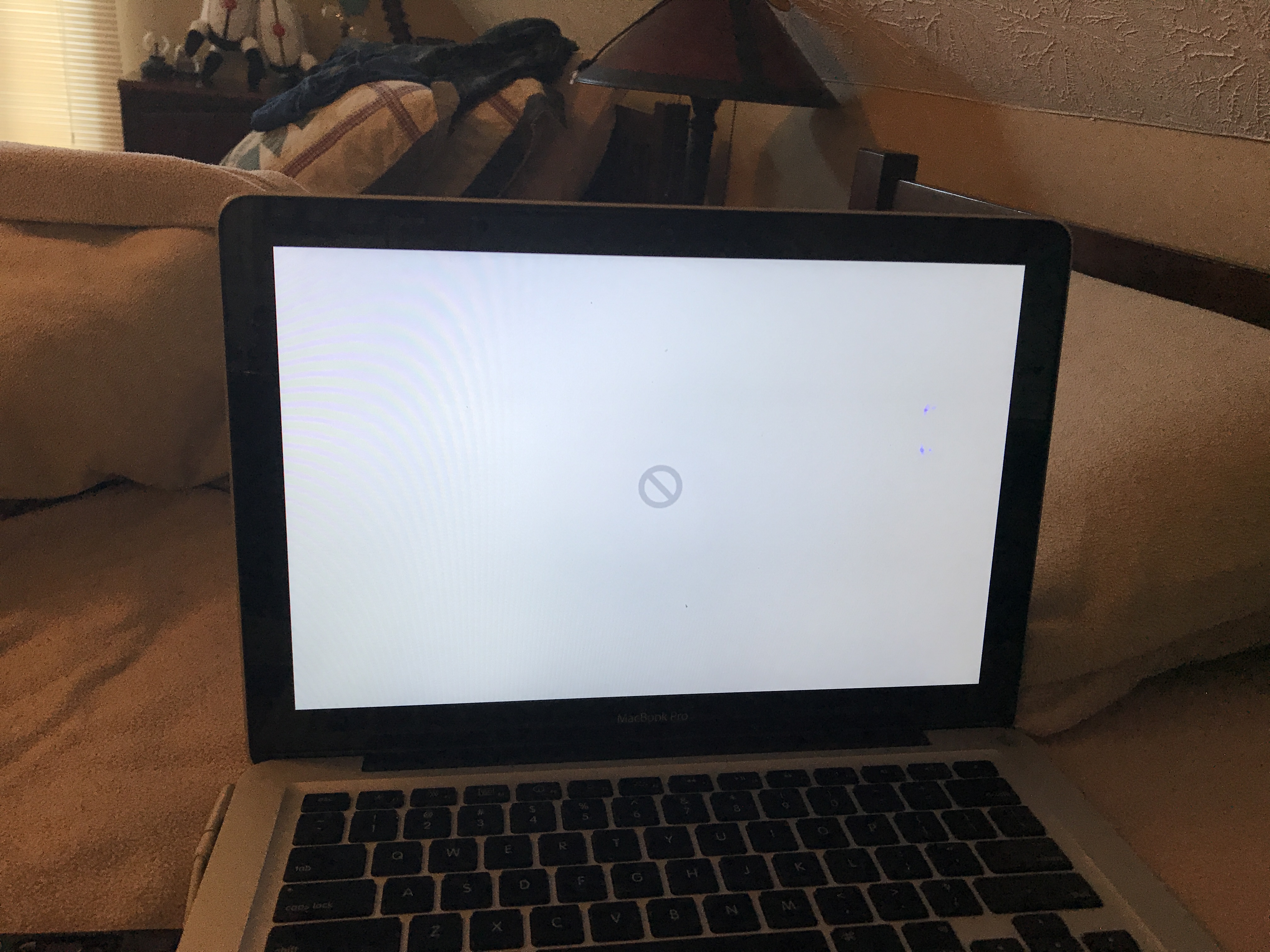

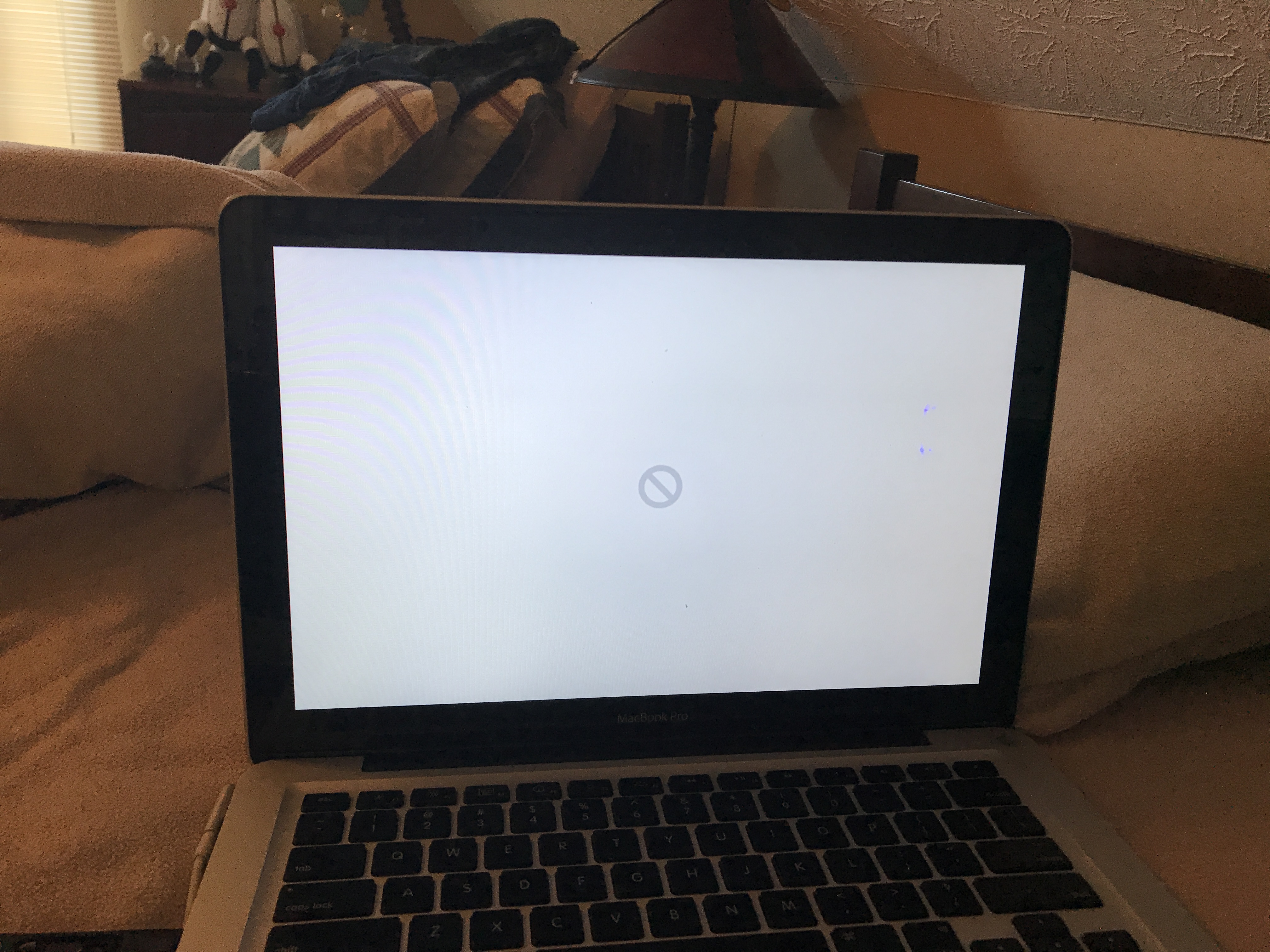

The patcher isn't working for me... Can someone please help me deduce the problem?
Basically, it writes everything to the USB but my Macbook wont boot to it! Macbook pro mid 2009.

It's an issue with the drive you're using. Use a different USB drive, and try again.

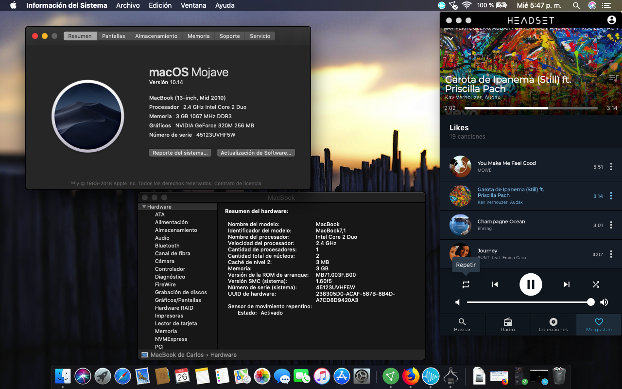

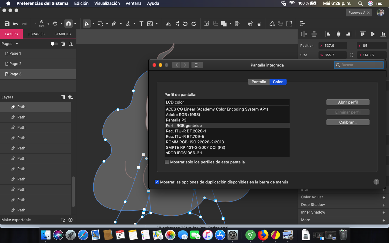

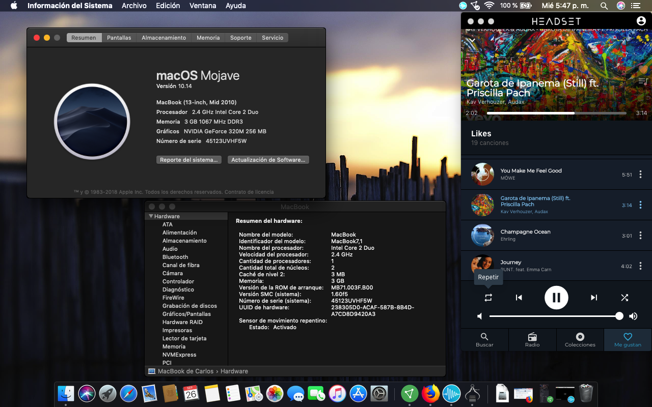

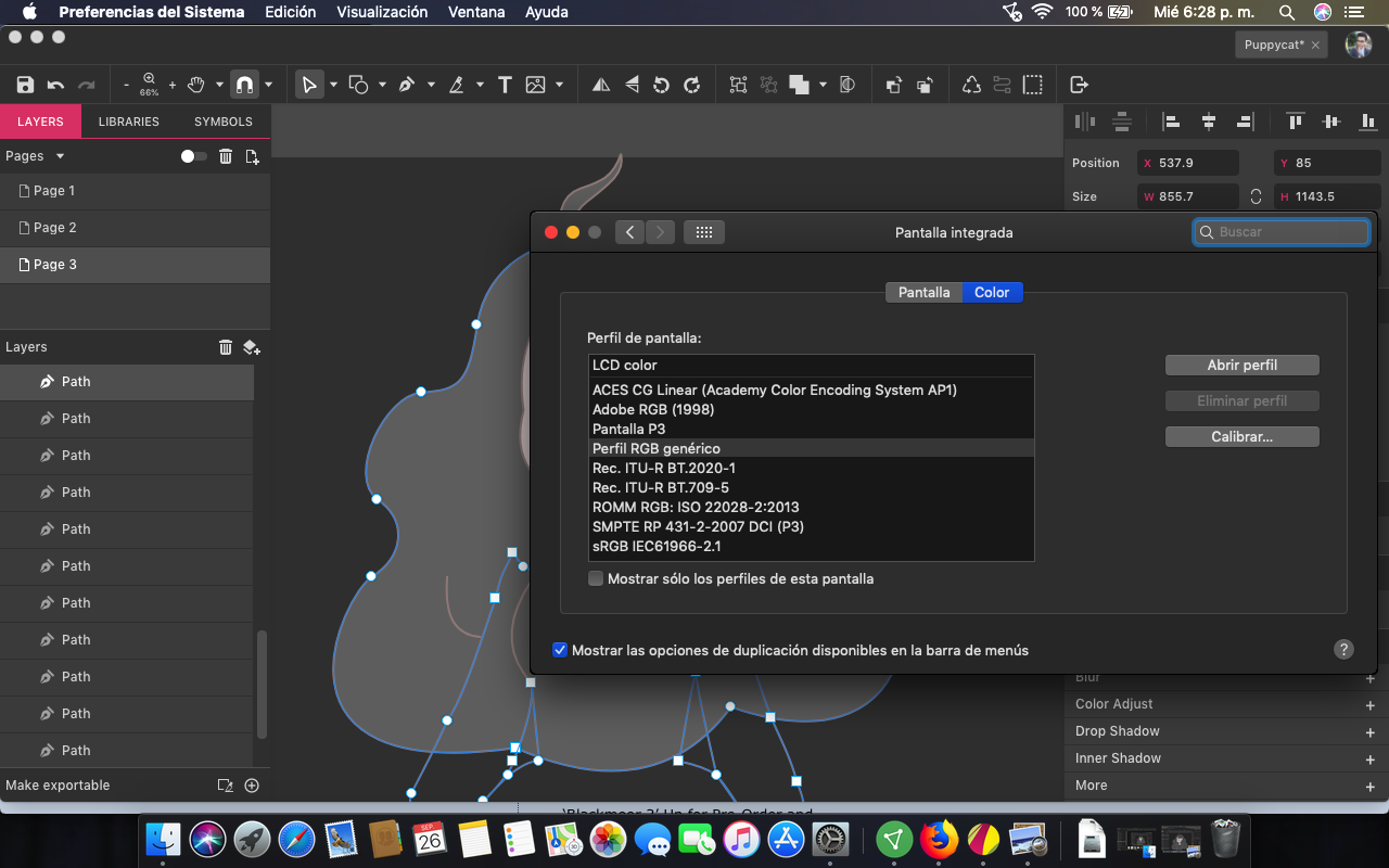

Thanks @dosdude1 for your Patcher tool!!!. Mojave is working perfect on my Macbook 7,1 (white unibody mid-2010) with 3GB ram and it's original hard drive. I made a fresh install on monday and i was testing and works faster than high sierra the only issues i got is with the app news that magically desappeared from aplications and with the LCD color profile, colors look weird and seen too warm for that reason i'm using the generic RGB color profile that looks nicer. What can i do to fix the LCD color issue. and another thing, How can i get night shift on my mac.

Thanks @dosdude1 for your Patcher tool!!!. Mojave is working perfect on my Macbook 7,1 (white unibody mid-2010) with 3GB ram and it's original hard drive. I made a fresh install on monday and i was testing and works faster than high sierra the only issues i got is with the app news that magically desappeared from aplications and with the LCD color profile, colors look weird and seen too warm for that reason i'm using the generic RGB color profile that looks nicer. What can i do to fix the LCD color issue. and another thing, How can i get night shift on my mac.View attachment 789357 View attachment 789358
Hey, what drawing app is that? That’s not AI! Would really like to know.
