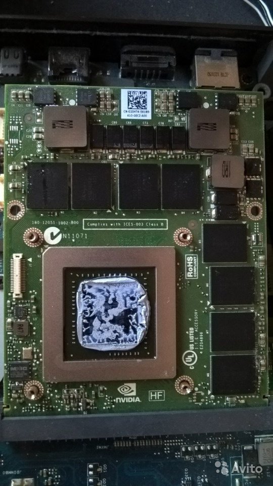

I replaced iMac 27 2011 ATI Radeon HD 6770M 512 MB with Nvidia GeForce GTX 680M 2 Gb (from notebook ALIENWARE M18 R2.
No Mac boot menu now.
Is there a solution to the problem?
Reactions: TimothyR734
Ooops! No.
Does this procedure work with my card?
From the video description that I posted:
"This method will work with any GTX680 card with a matching port layout as the reference card (shown in the video), and will allow it to show a boot screen on any Mac Pro 3,1 or later."
I haven't performed this procedure myself, so maybe somebody more experienced can help.
OK. Thank you.
