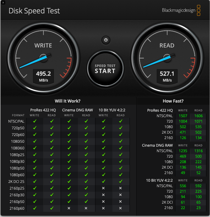

Just to let you know that I tested an Allegro USB-C PCIe card from Sonnet in my Mac Pro 3.1 with Mojave 14.1 and it worked. I inserted the card in the slot number 2. Here is a test result with a Samsung T5 500GB.

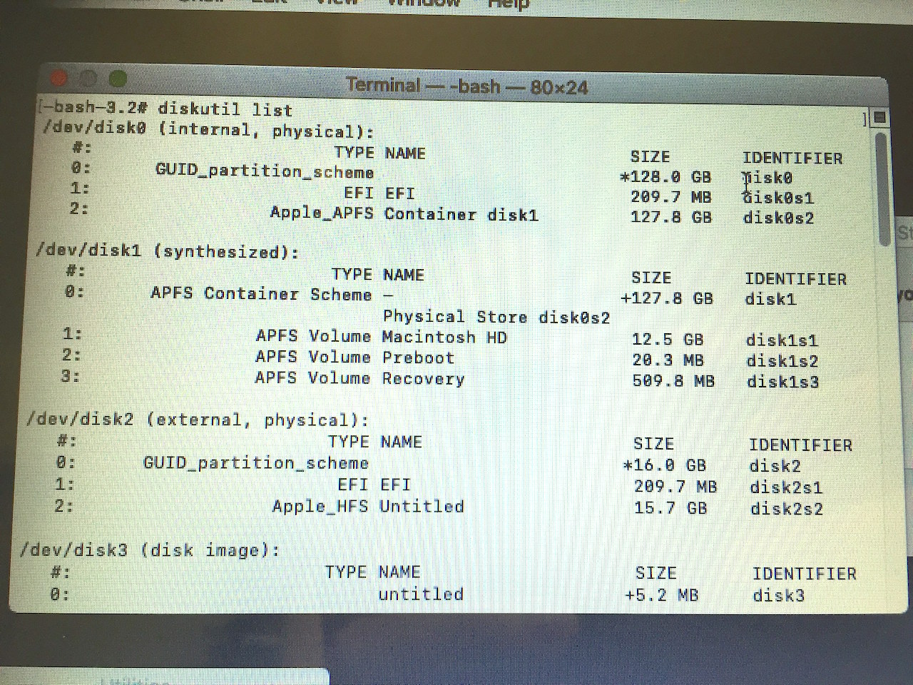

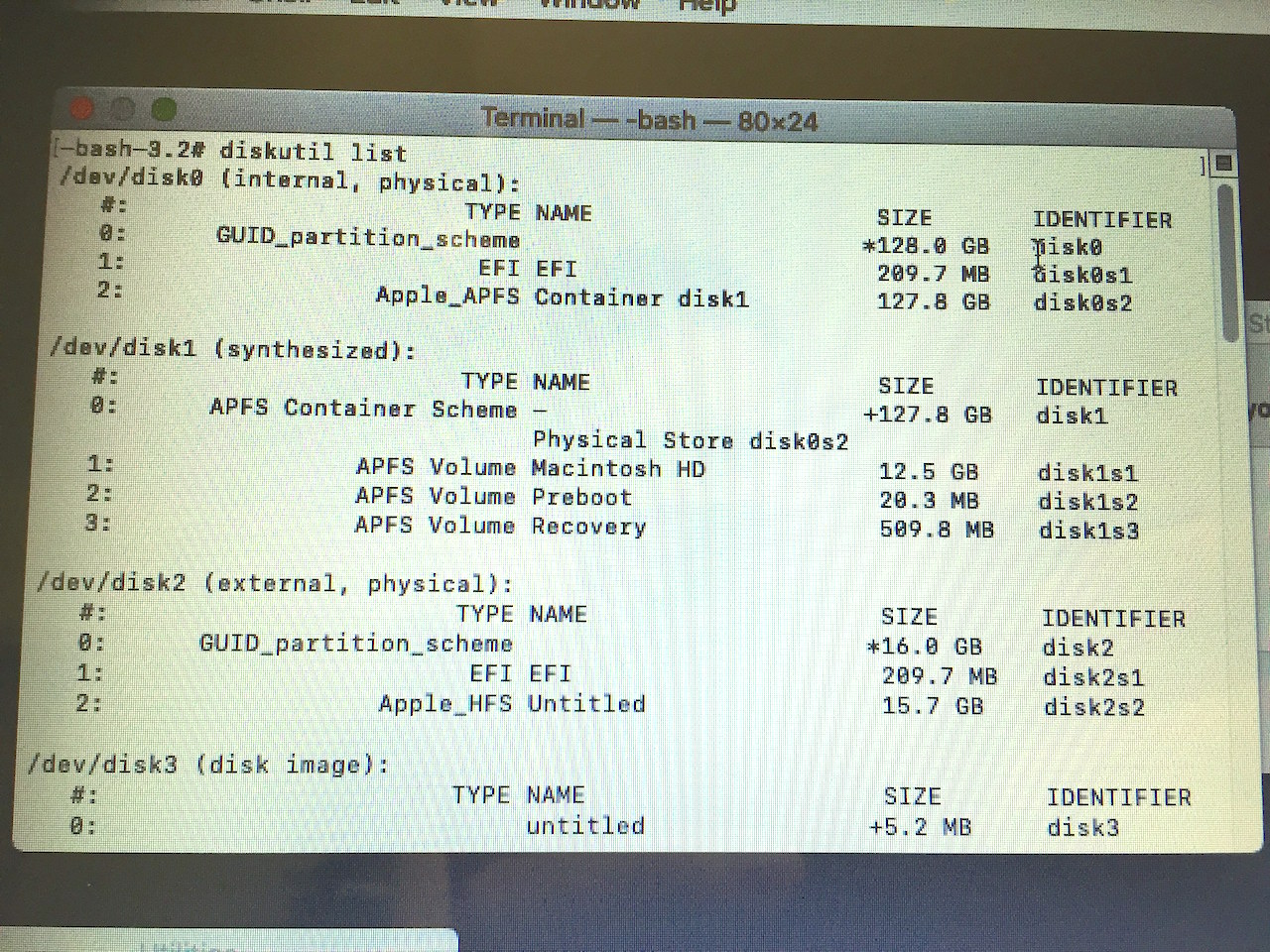

I have installed Mojave on a MacBook Pro 13" (Early 2011) MacBookPro8,1 and I'm having some trouble getting it going... I was able to install and run the post-install patches okay, but it seems it can't boot and doesn't see the boot volume (or Recovery) in the Option-key multi-boot selector.
Here's the process I took;
  1. Created Mojave installation USB (16GB) using macOS Mojave Patcher v1.2.3, downloading macOS 10.14.1 directly from within the app.
  2. Booted from the USB drive.
  3. Used Disk Utility to format a new 128GB mSATA SSD as APFS (GUID partition map).
  4. Clicked to install Mojave.
  5. After a minute or so, received a "No packages were eligible for install" error.
  6. Read the FAQ on dosdude1's server and used the 'date' command to set to today's date.
  7. Rebooted from USB and successfully installed Mojave.
  8. Ran the macOS Post Install tool and set the default MacBookPro8,1 patches.
  9. Ticked the "Rebuild caches" checkbox and clicked Restart.
  10. On reboot, the SSD was not recognised and the USB installer started up again.
  11. Removed the USB and rebooted, same result.
  12. Rebooted back into the Mojave installer via the USB drive.
  13. Checked the output of 'diskutil list' to confirm the APFS partition map is setup correctly. I don't know much about APFS, but it looks reasonably okay to me ....
  14. I then did some further reading about manually blessing a volume in case this step was somehow skipped.
  15. I executed the following commands;
    Code:
    diskutil apfs updatePreboot disk1s2
    bless --folder /Volumes/Macintosh\ HD/System/Library/CoreServices --bootefi
    update_dyld_shared_cache -root /Volumes/Macintosh\ HD -force
  16. Choosing Quit from the Installer and choosing Startup Disk, I was able to see "Macintosh HD" 10.14.1 as bootable. It is selected, so I clicked Restart.
  17. The MacBook Pro still can't see the APFS volume as bootable at boot time.
From what I understand, the MacBookPro8,1 model will natively support APFS booting.
What should I try next? Do I ditch APFS and try a fresh HFS+ install instead? Or should I try using the APFS booting patch on this Mac, even though it should be supported?
My apologies if this has already been covered in one of the 398 earlier pages :)
-AphoticD

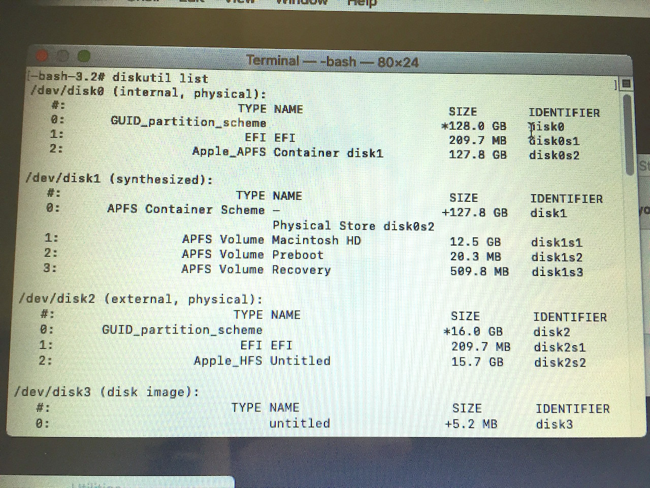

    Code:
-AphoticD
:apple: :apple: :apple:
You need to have installed High Sierra on the system previously, so it's firmware is updated to support booting from APFS volumes. Otherwise, it won't detect the volume.

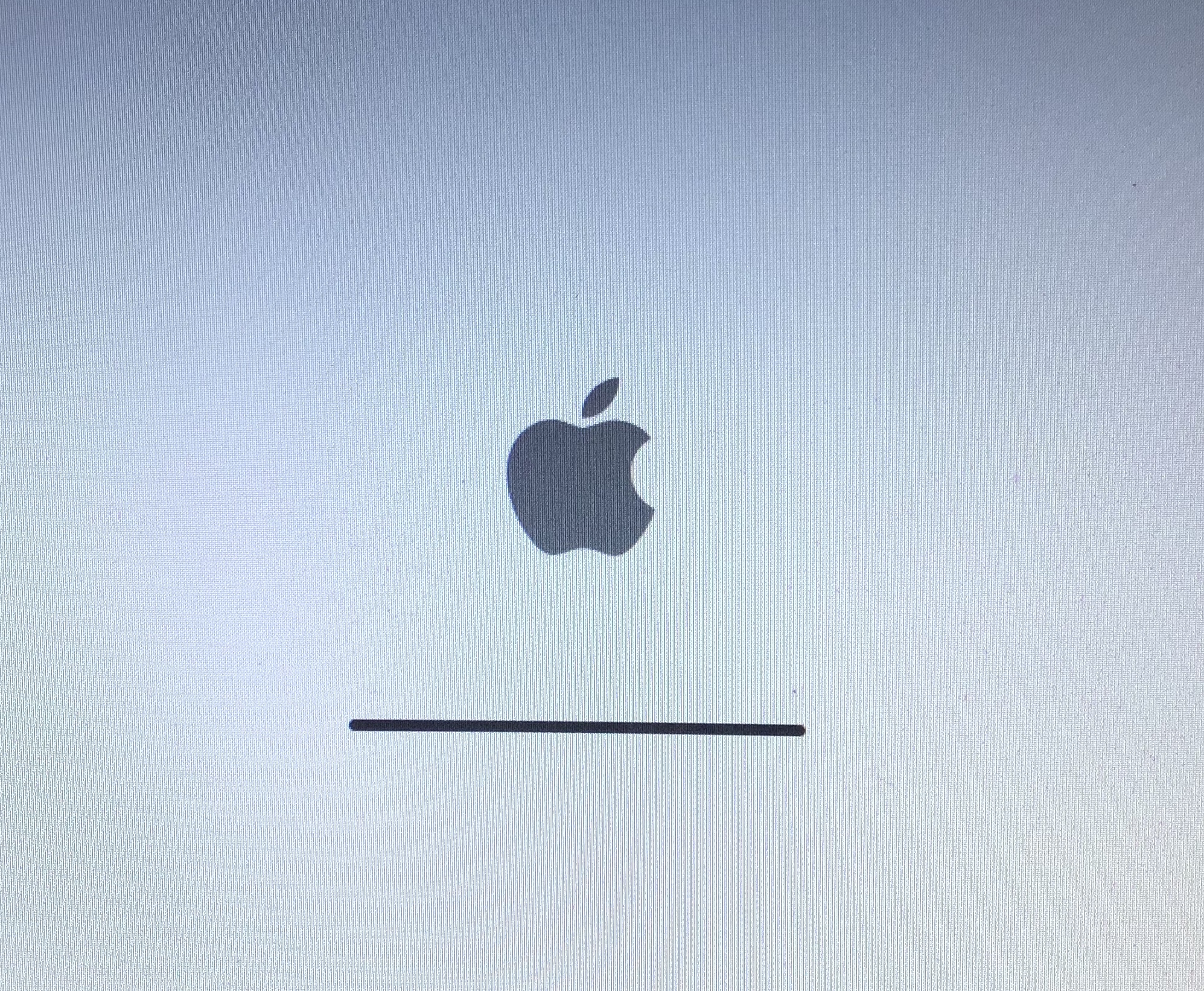

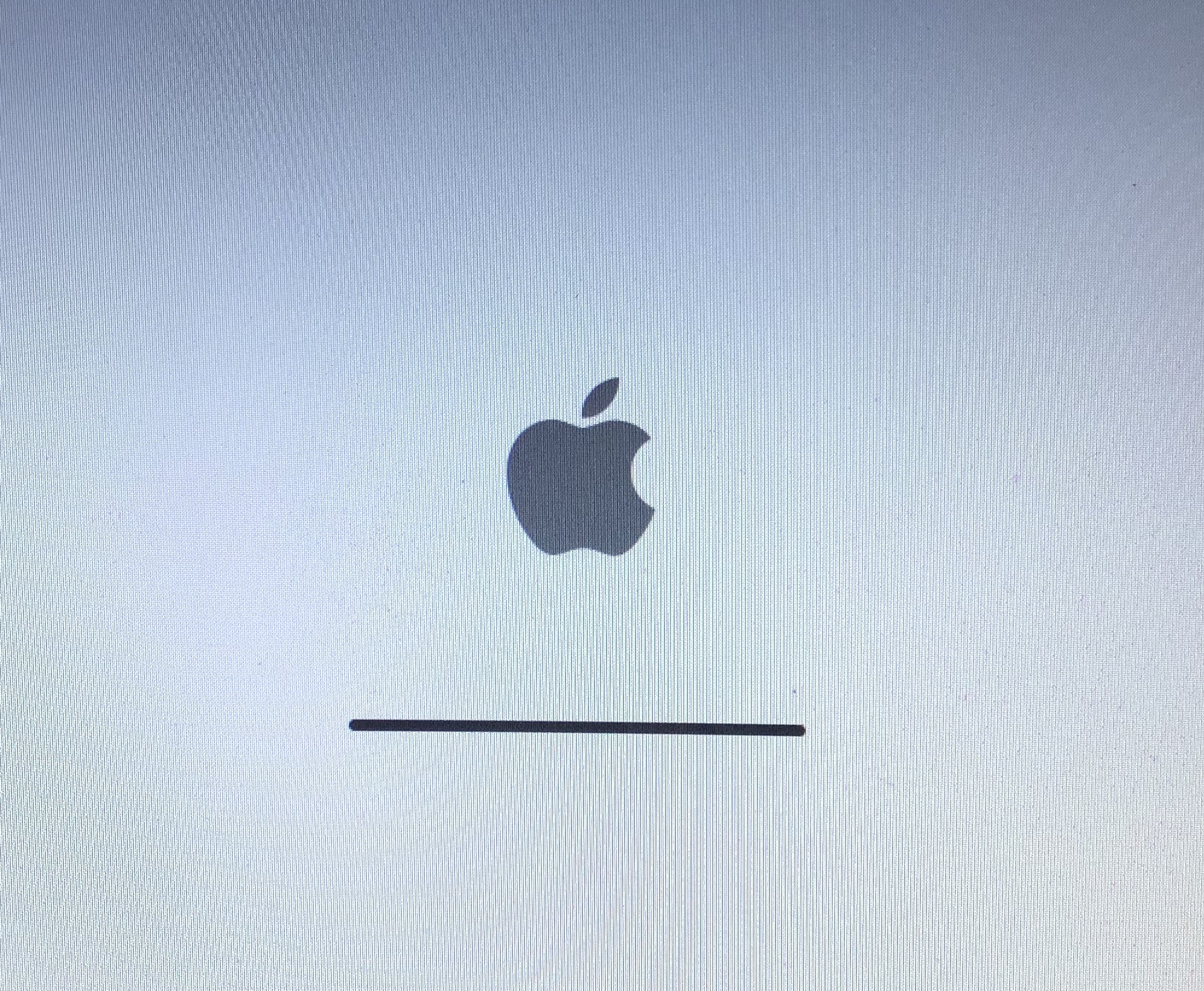

Hello peoples, yesterday I tried to update from 10.14 to 10.14.1 using the system preference update. My macbookpro 8.1 is now stuck on this. I'll try to reboot on usb key with the mojave installer of Dosdude1 but nothing happen. Anyone got an idea to help me ?
Edit: my macbook has a Ssd and he already was on APFS on HighSierra.
    Code:
-AphoticD

View attachment 800506 Hello peoples, yesterday I tried to update from 10.14 to 10.14.1 using the system preference update. My macbookpro 8.1 is now stuck on this. I'll try to reboot on usb key with the mojave installer of Dosdude1 but nothing happen. Anyone got an idea to help me ?

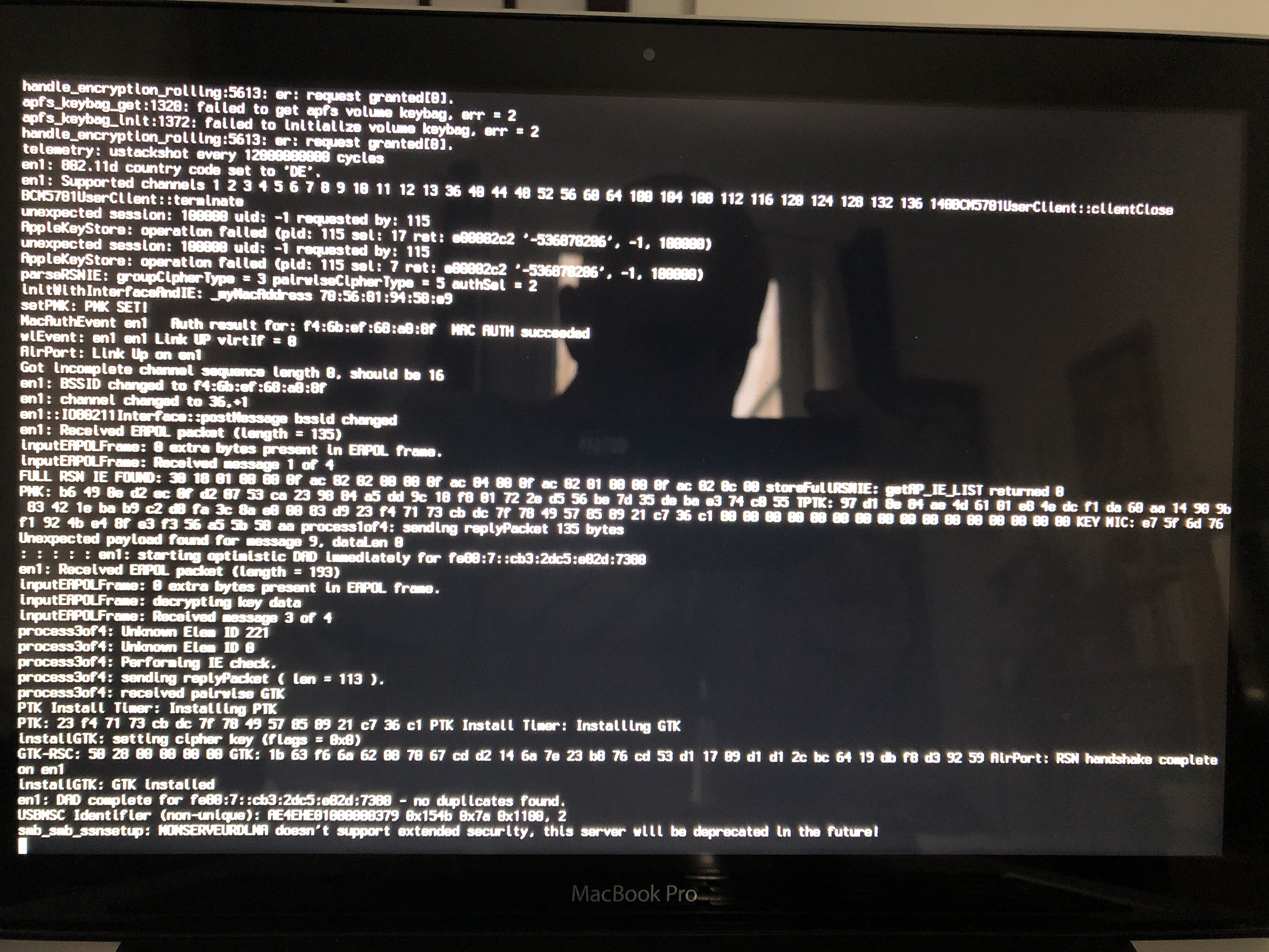

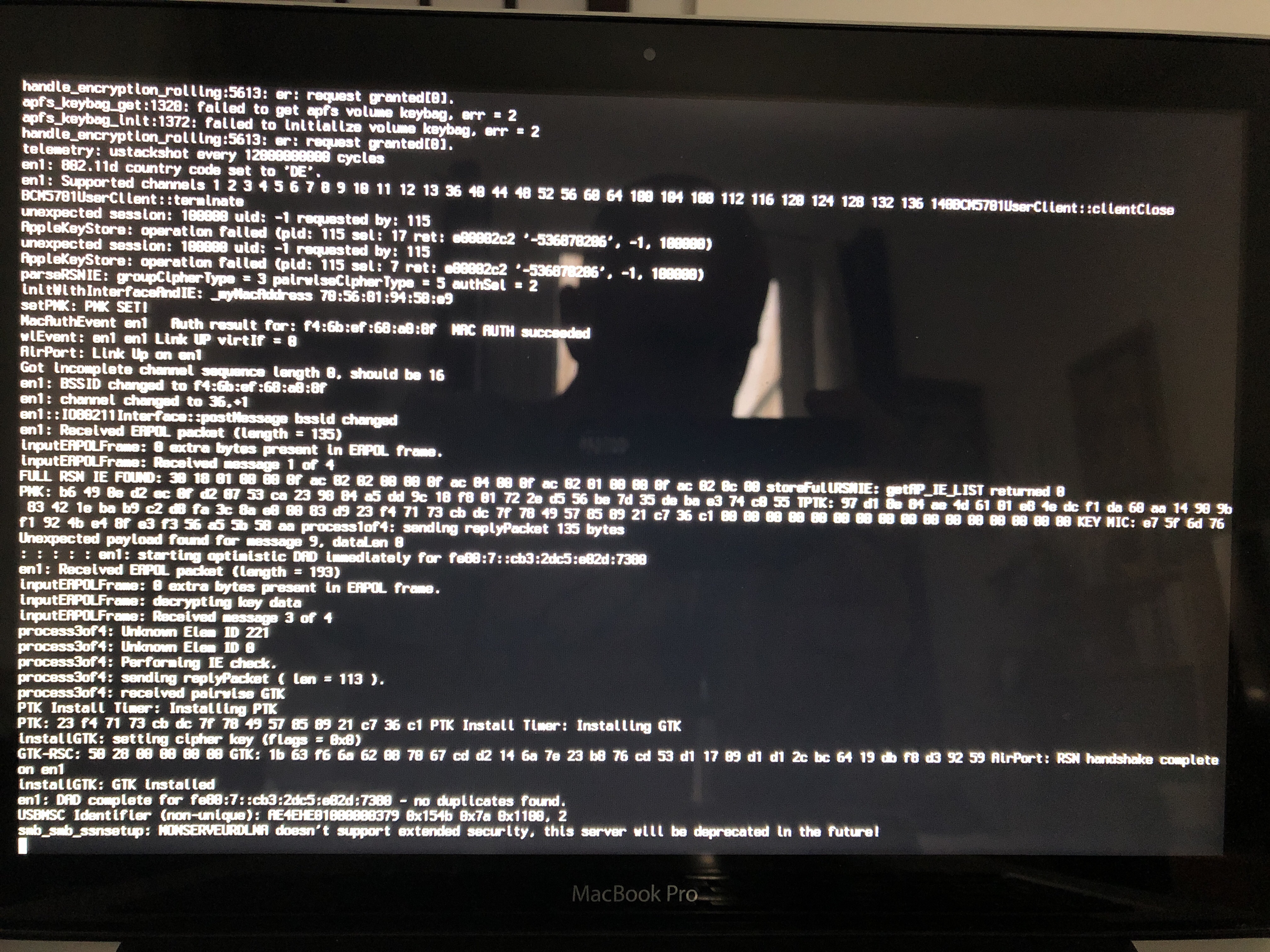

Take screenshot from verbose output. Boot with pressed cmd+v.
I have mbp8,2 with dead gpu, install update 10.14.1 over 10.14 from usb with patcher 1.2.3.
p.s. my english is not perfect :)
@TimonCello, hmm, dont know, maybe you have smb share and it stuck when try connect it.
However, make new usb installer using mojave patcher 1.2.3 and install over your existing installation.
I tried, but nothing happend when I push C on the jeyboard when I reboot. Always come back on the first screenshot I posted :(

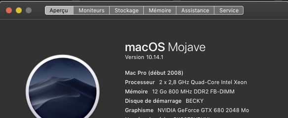

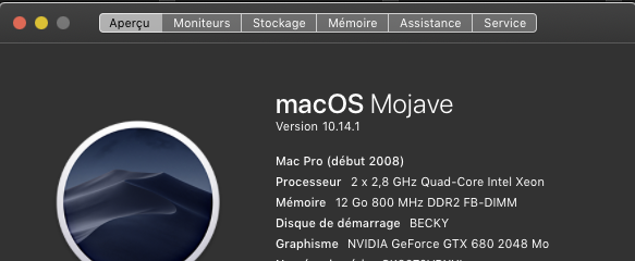

I took the plunge this morning upgrading my MacPro 3,1 with stock ROM on HFS+ and a Nvidia 680 GPU from a patched 10.14 to 10.14.1 with Dosdude's patcher and a Force rebuild the cache on reboot after the post-install patch and everything went OK in about an hour time. Only the last 12 minutes of installation were half an hour at he end.........
Big thanks to Dosdude1 for his amazing work !!!!!!!
