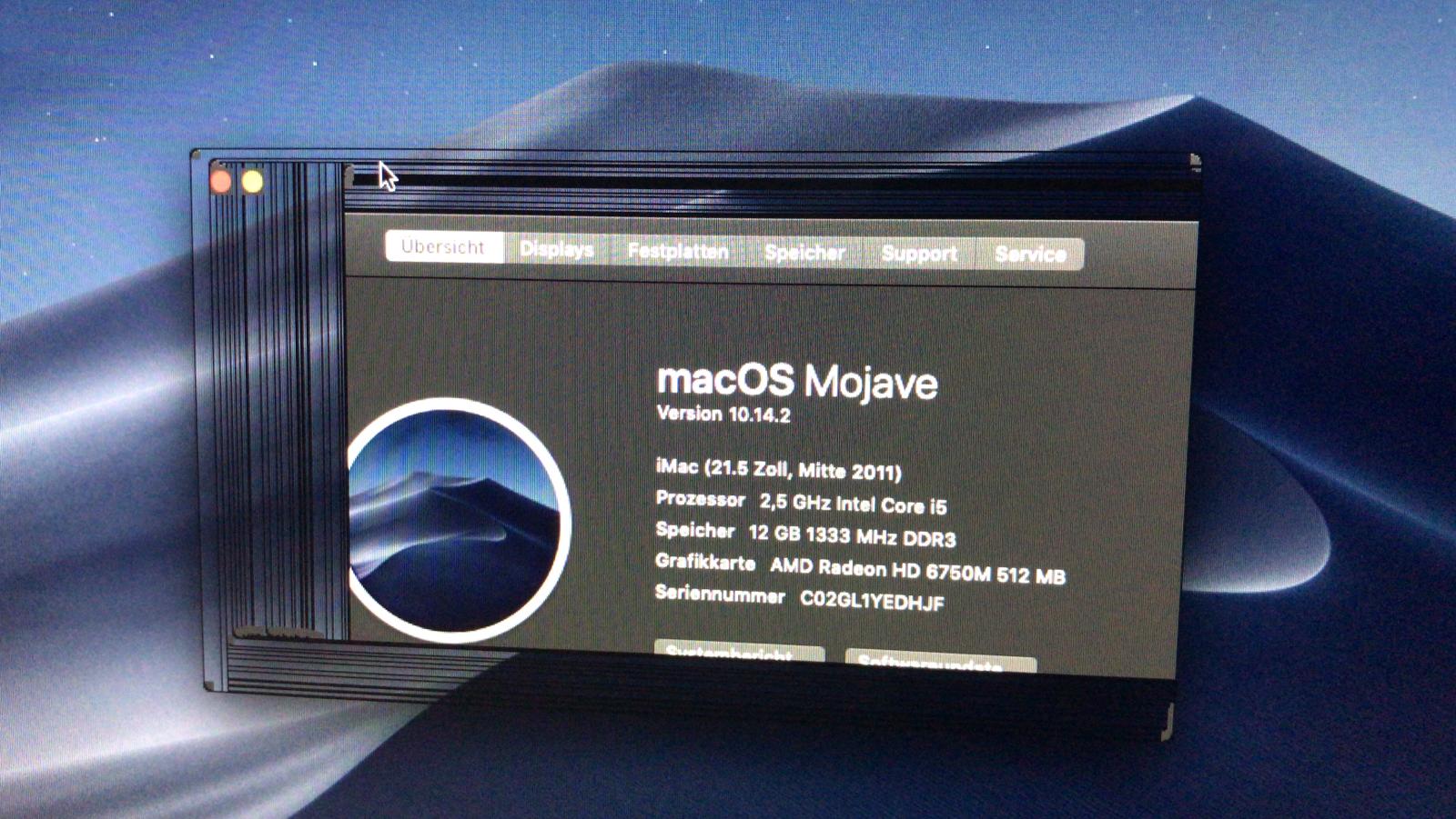

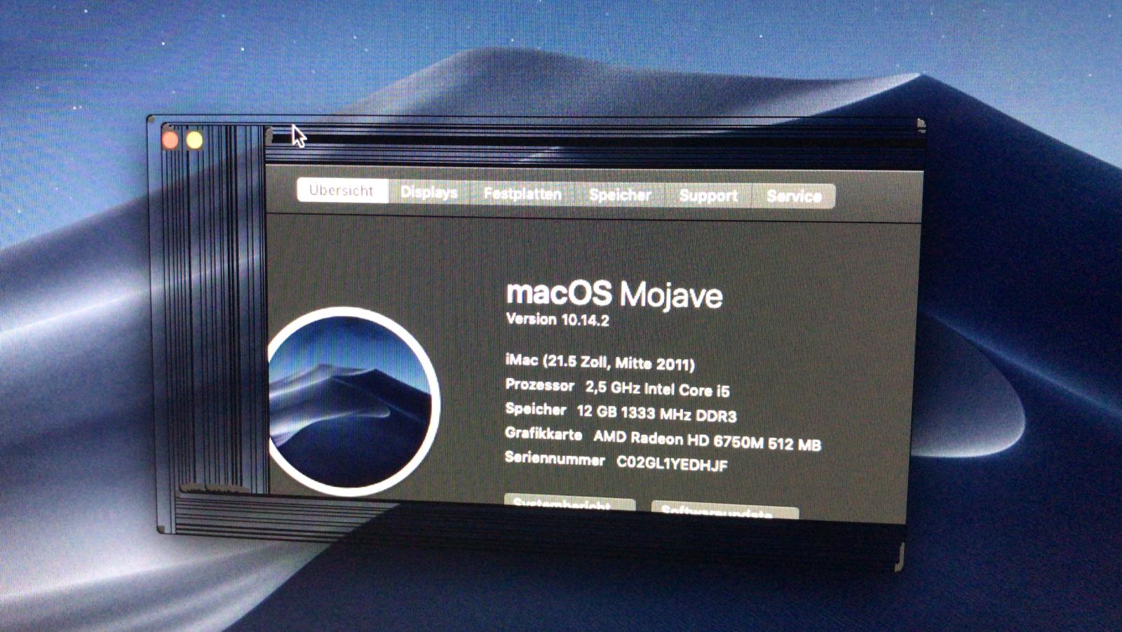

Does anyone know why i get this problem when i am moving a window. When i select a different window or open and close the Launchpad it disappears. Does anyone had this issue too?

Does anyone know why i get this problem when i am moving a window. When i select a different window or open and close the Launchpad it disappears. Does anyone had this issue too?View attachment 824082
The answer to this is in the first post. "AMD Radeon HD 5xxx/6xxx series GPU acceleration: Currently, it is not possible to get full graphics acceleration when running Mojave on a system with a Radeon HD 5xxx or 6xxx series GPU. Mojave will be almost UNUSABLE without graphics acceleration".
