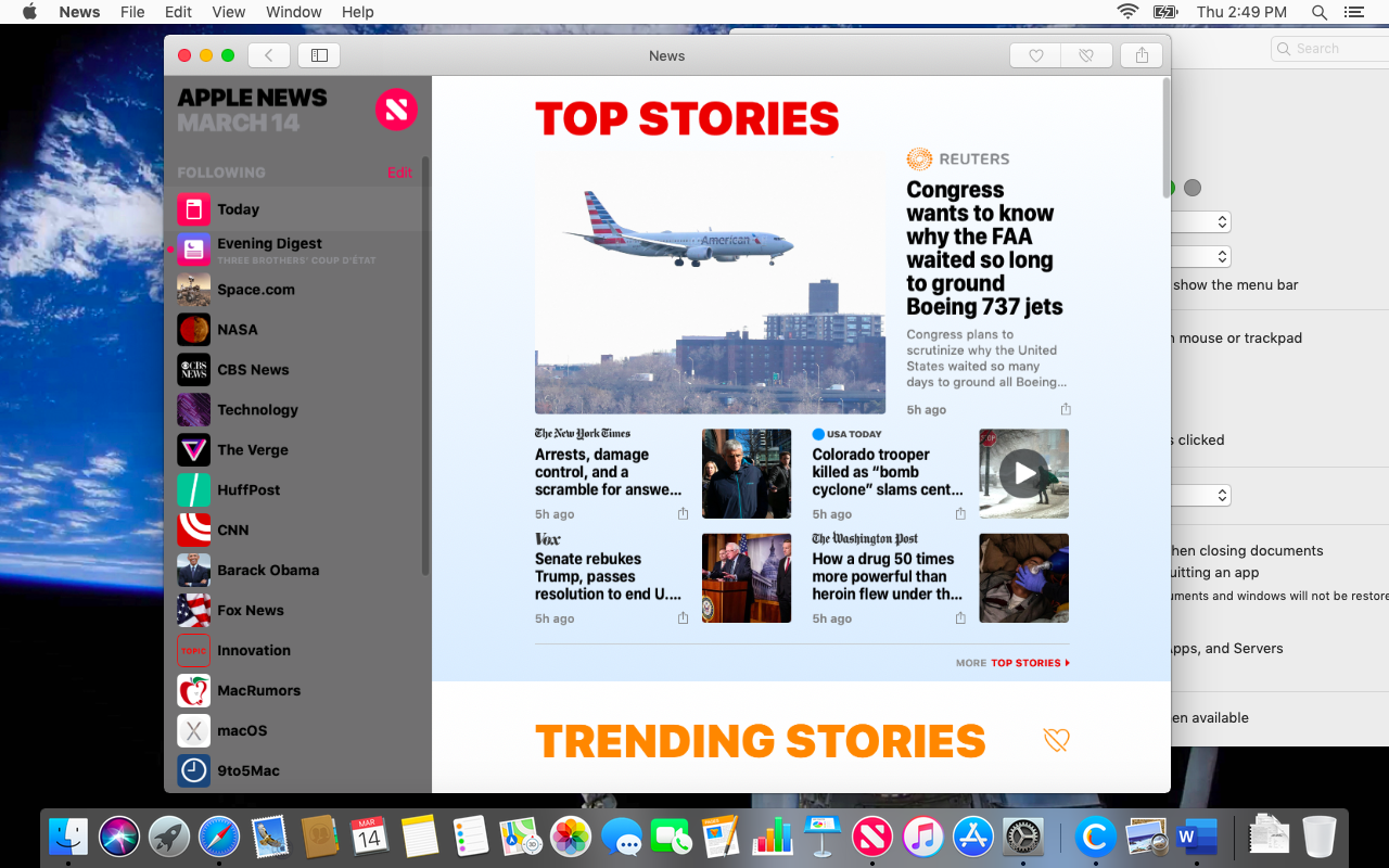

I applied @pkouame's vibrancy patch, on other apps the menubars have no anomalies at all but on the News app menubar, it is ugly, grey and dark on light mode. Any workaround for this? View attachment 826271
I heard from pkouame and will be working on a new hybrid patch soon
