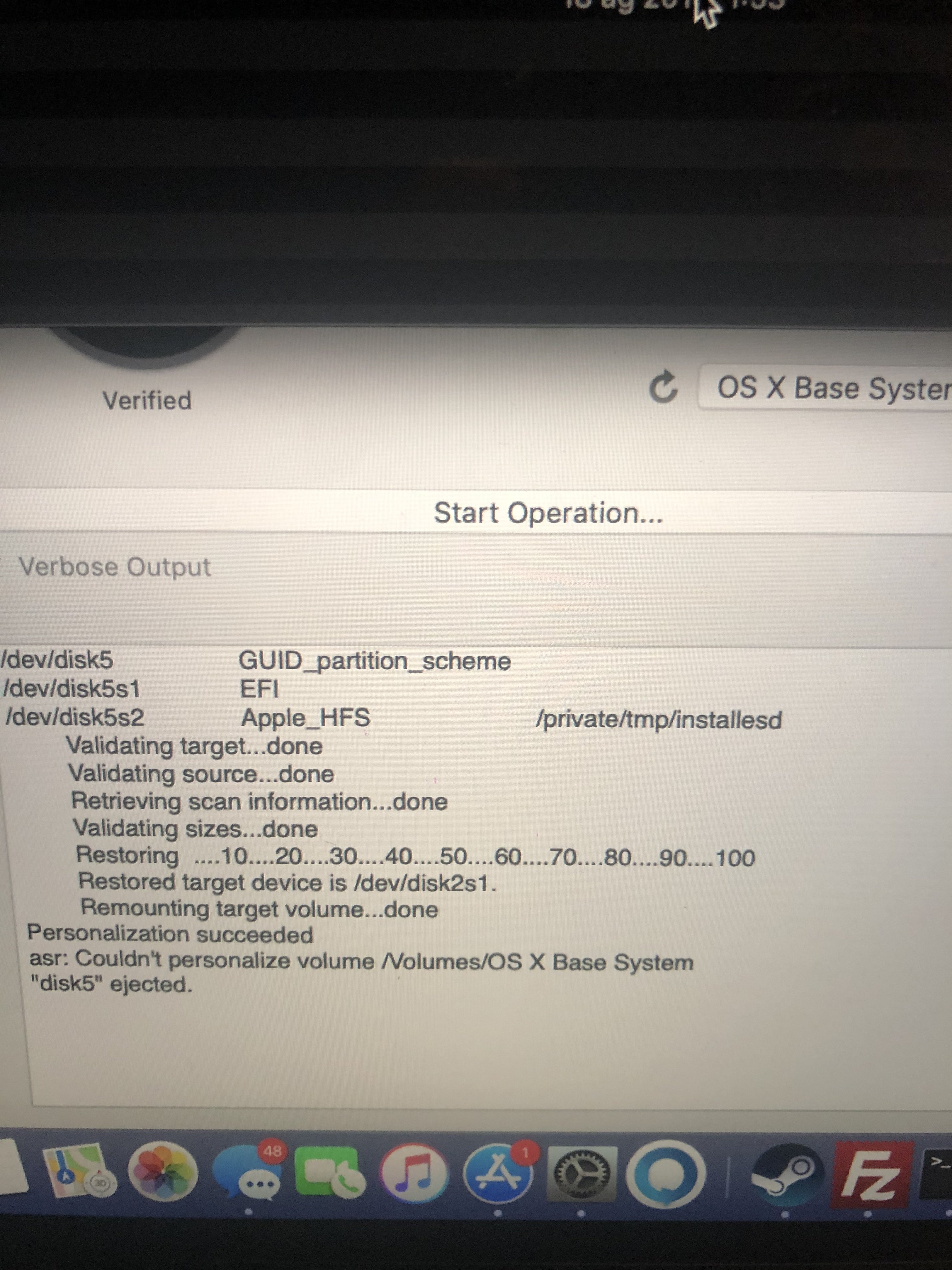

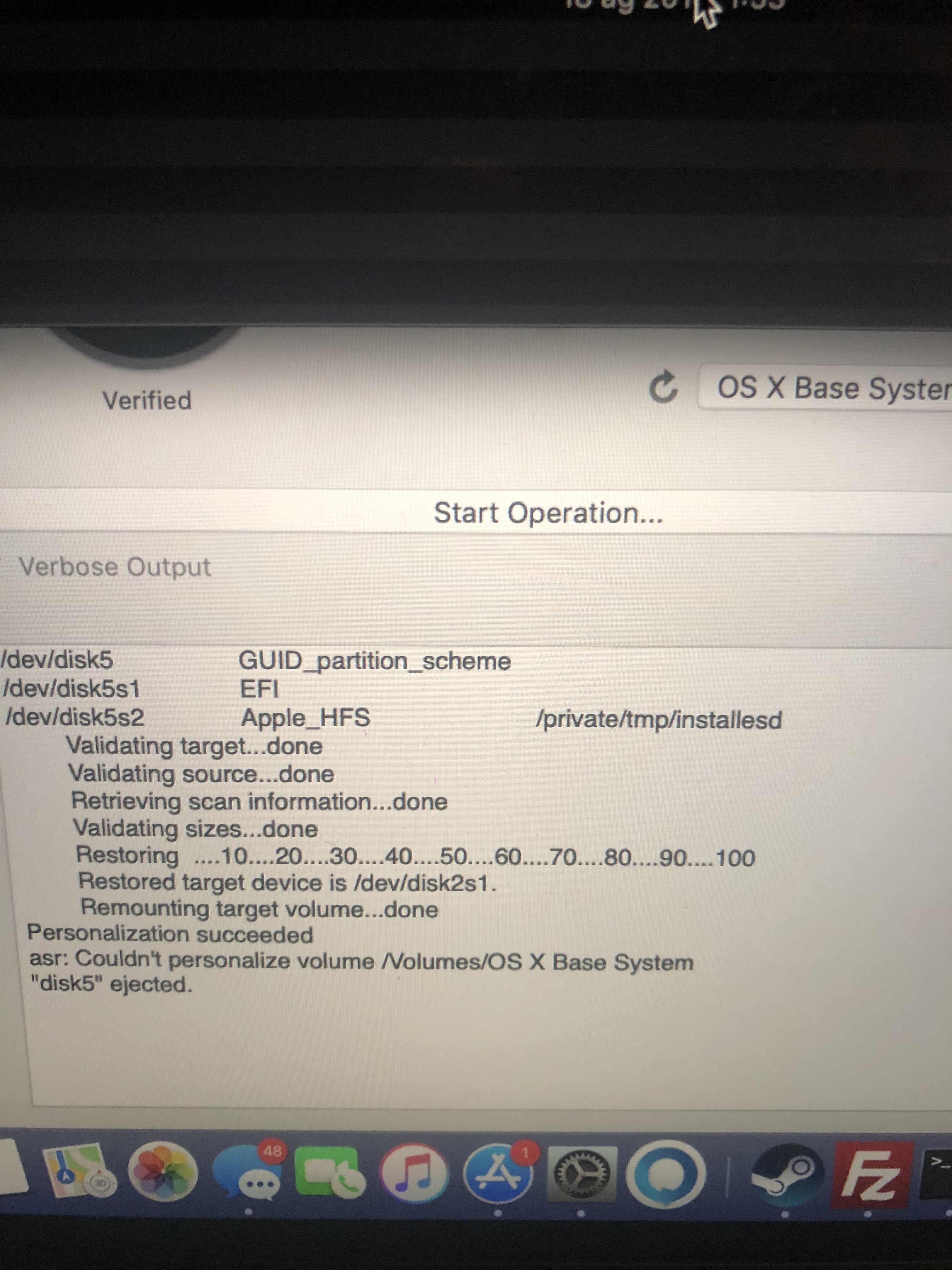

Hello!
I’m getting this error all the time. Tried with different versions of mojave patcher of @dosdude1 and up to 4 different usb devices.
Anyone can help me please?
Thanks!
can you mount the drive?
You mean later? Yes. But it’s about 1.5Gb... BTW, I downloaded 3 times the mojave dmg, just in case...
If, for example, I try to boot MBP2011 with that usb, it shows the forbidden symbol.
Which Mac OS X/macOS do you use to create a patched USB installer?
Do you actually named your 16Gb USB an "OS X Base System"(when you formatted it in HFS+)?
All 4 USB that you tried are different brands(it might be easier just to create a 16Gb partition on your drive)?
I’m using Mojave.
No, I’m not renaming the device, is the patcher who gives that name.
And yes, different brands
How can I do that? I only have one imac with mojave and this 2011
I guess this is exactly the moment when you learn the true value of dual(or even triple) booting your system.
You might just need to find a friend or a family member with a Mac.
Obviously it is a must to have more than one Mac if you are willing to undertake any experiments with your system.

Hello!
Thanks!
Have you tried after "disk5 eject" to wait for other 15-30 minutes letting it complete ?
Because some USB drives starting with a fast R/W ratio, but after filling their 50% of capacity, then become suddenly very slow, don't forget that Mojave OSX Installer, apart an important Core.pkg (5,3 Gb), does contain additional tens of thousands little files between frameworks, binary and so on, just to say another, even a "single kext" can contain more than one hundred (small) files, so the bytes copy process it's slower than expected.
The issue is divided between 50:50 USB drive & incompatibility of @dosdude1's Mojave Patcher with Mojave. I have tried at least 6 USB sticks, before I found one that worked - even connected an HDD dock. However that one USB stick only worked when using the Patcher with an older OS - in my case El Capitan.
[doublepost=1553270534][/doublepost]
Boot to the boot selection menu and hold the control key when you click on the installer drive. Then shutdown the machine and boot while holding the V key. Video the screen or just take a picture if there’s no scrolling text.
Tried 2-3 times in multiple variations, same result for my MB 4,1 - or maybe it's a 5,1 even idk anymore.
4,1s are currently incapable of booting to the installer on either patcher. This might change soon for mine but dosdude has already stated that he does not plan to support the 4,1 in any way.

Ok, so right now I can confirm problem is burning patch with mojave os. I tried flashing the high sierra version, on a mojave laptop, and still getting error, so is something with permissions.
Let’s hope @dosdude1 can solve it!

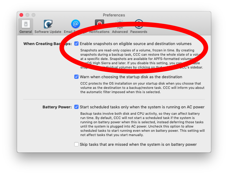

Can I ask off topic a liitle bit?
This is the first time that I've used the Carbon Copy Cloner. @avz said that "apfs local snapshots are indeed useless on unsupported Macs(APFS-ROM patched)" , I saw this setting in CCC but I am confused whether enabling or disabling it?
Thank you.
