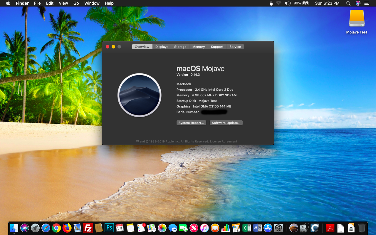

Booted via USB. It's like running Leopard on a 300mhz G4 with 256mb of RAM.
Now to clone it to an SSD and boot it internally to see how it REALLY performs :)
Looks like I'll need a new wifi card...
Thanks for all of the help!

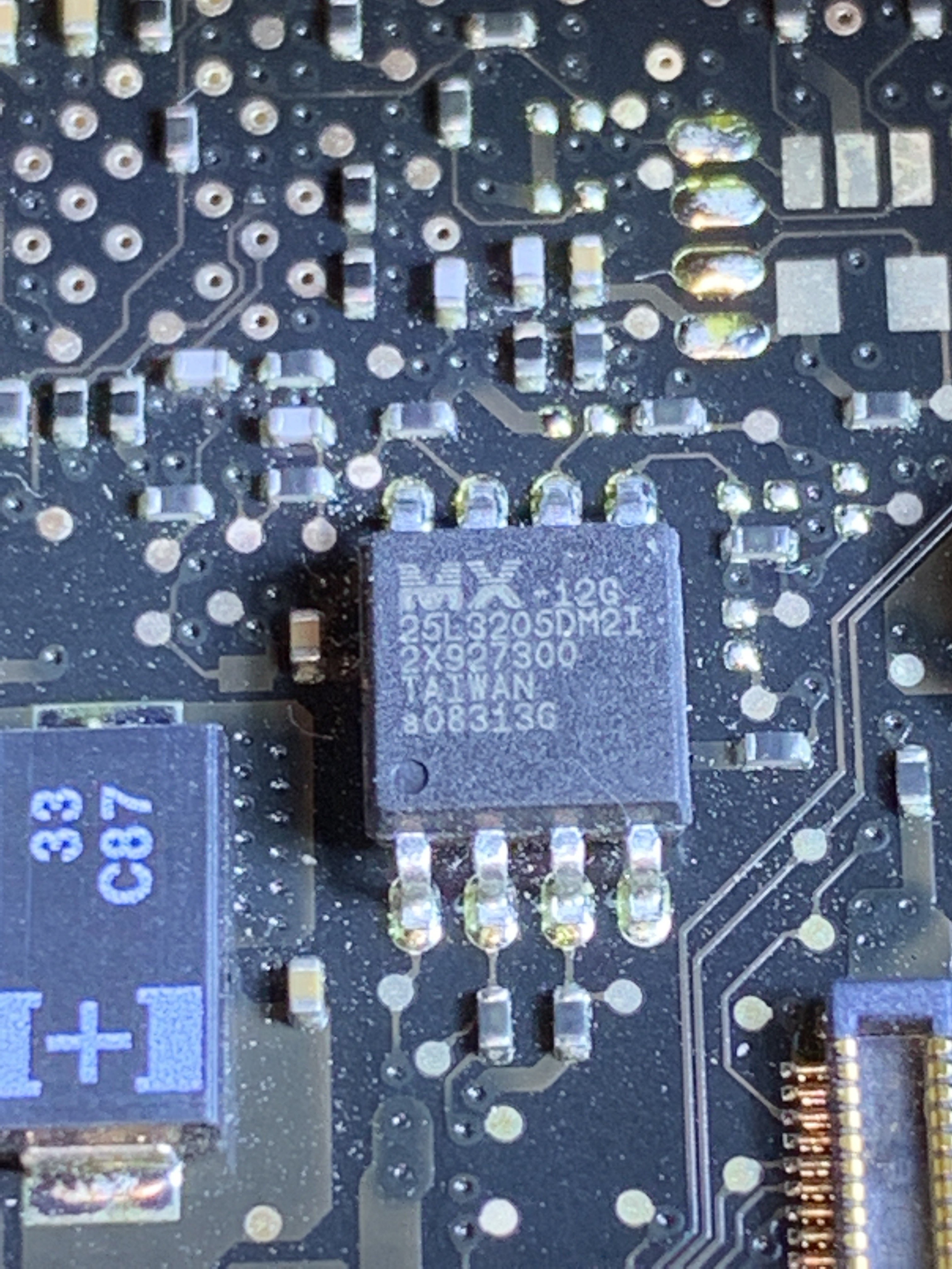

Help with identifying Macbook5,1 ROM chip?
Hi,
I want to use dosdude1's ROM Patch tool to update the EEPROM on a Macbook5,1 (2008 unibody Macbook). When I run it, the patcher gives me a few options for the possible EEPROM:
  • MX25L3205(A)
  • MX25L3205D
  • MX25L3208D
  • MX25L3206E
The chip in the Macbook5,1 appears to be an MX25L3205D - see the image below. I want to be sure to choose the right EEPROM option - can anyone confirm the correct option from the image of the chip below?

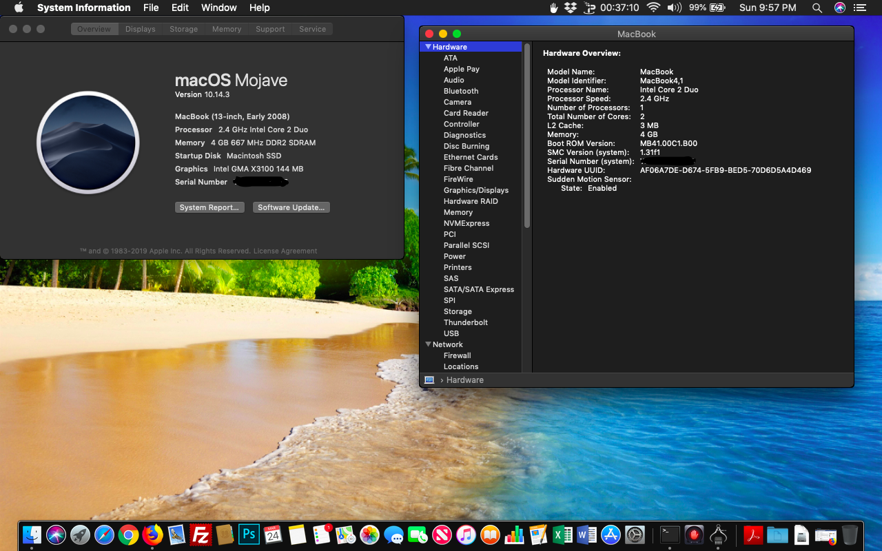

All moved over to SSD. Works pretty well. I get a kernel panic (with no notice) upon reboot or shutdown, but this is just a test install. We'll see if it happens with the patch that's soon to be released.

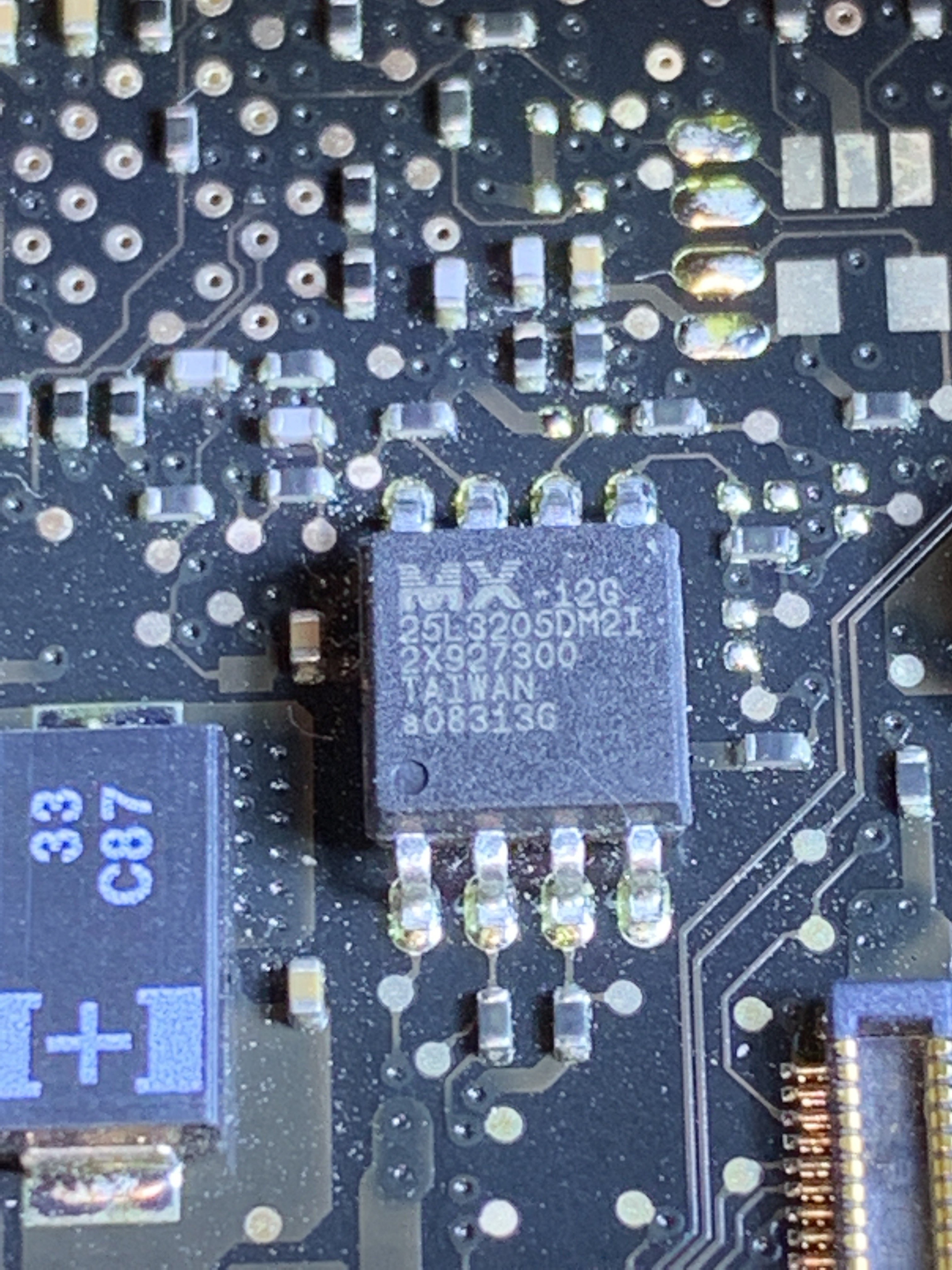

Hi,
  • MX25L3205(A)
  • MX25L3205D
  • MX25L3208D
  • MX25L3206E

Yep, that's a MX25L3205D, so you'll want to select that option.
