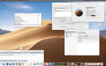

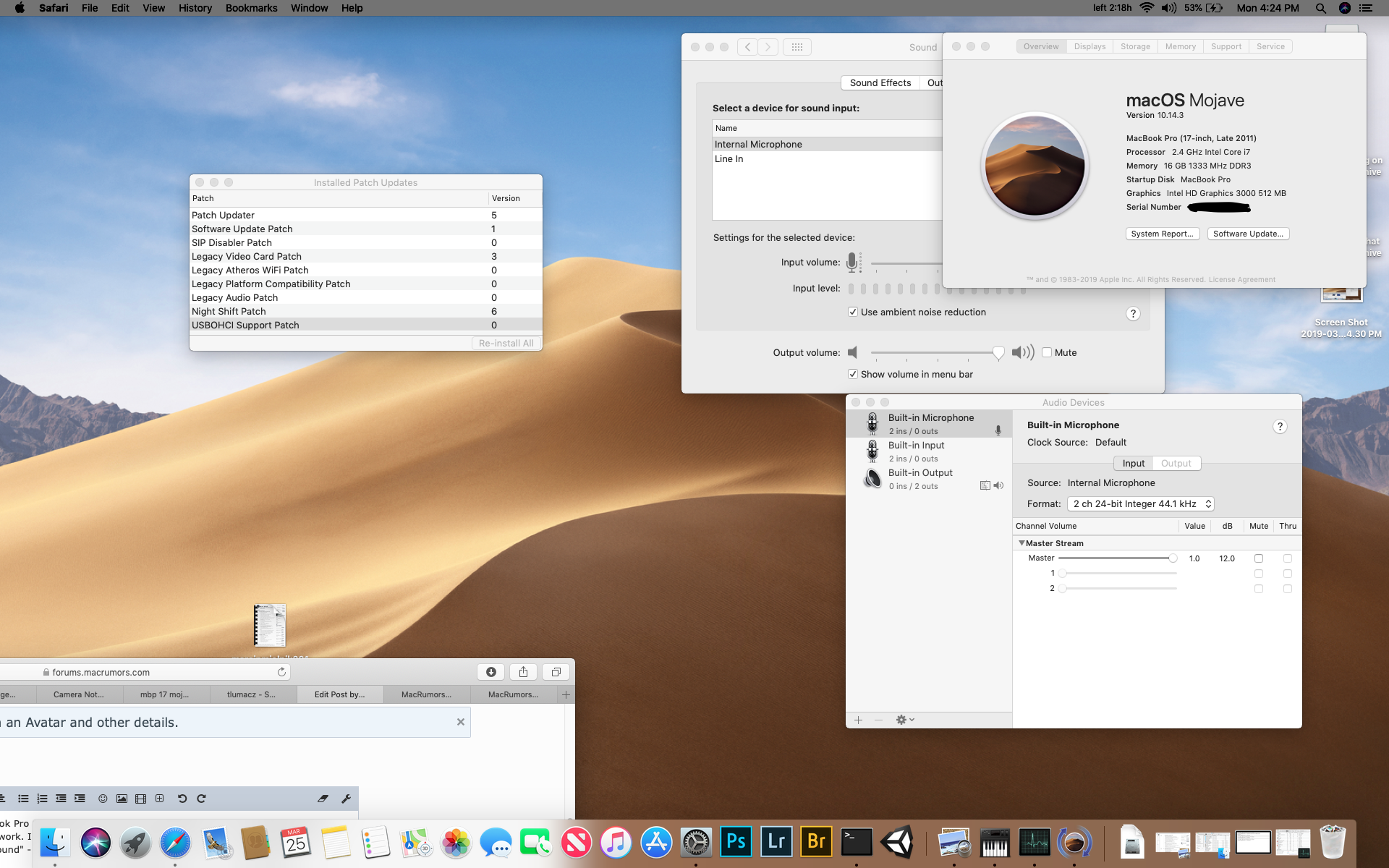

I installed macOS Mojave on MacBook Pro 17 (late 2011) using "macOS Mojave Patcher" tool, and now built-in microphone (and also Siri) don't work. I google a lot for fix/solution without luck. I try 'setting/private", app/utilitles/audio midi", "setting/sound" - nothing work. Any idea how to make mic working again?
ps. I can change slider settings on "master stream", 1 and 2 - they are disabled
Is this a hardware problem or software settings?
When making a video call with a mac - I hear only the noise instead of the sound

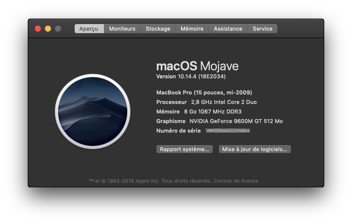

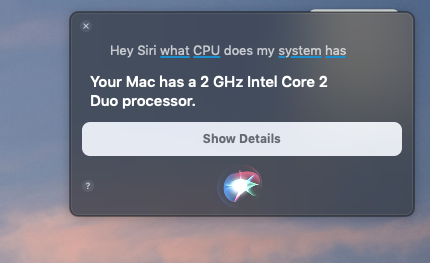

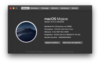

Hi, all
MacBookPro 5,3 updated successfully to 10.14.4
But:
- Siri doesn't work
- iSight doesn't work (worked fine with 10.14.3)
EDIT:
- Siri work well with Larsvohier solution #12894 (Thanks Larsvohier)

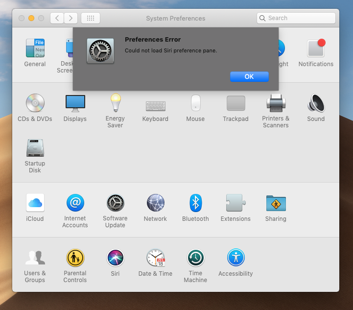

I’ve seen a few reports of Siri crashes and iOS app crashes. I will be adding the Siri patch by @Larsvonhier to my patcher and I encourage @dosdude1 to do the same. As for the iOS app crashes, I don’t have a solution for those but apparently opening the Apple News+ section will break the News app. Avoid doing this and if you do then remove your News app preferences file. I don’t know if that will fix it but I recommend it since it’s the only thing I can think of. You can use an app like AppCleaner to remove all files associated with the News app. Don’t remove the News app itself, just the other files.

Only SiriUI.framework needs to be replaced. I will be releasing a patch for Siri via Patch Updater later today.
Champion! I was actually thinking the same as Larsvonhier on page 516 first suggested only replacing SiriUI.framework and then on page 519 decided to replace more Siri frameworks.
