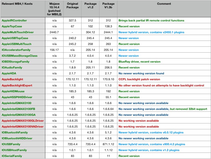

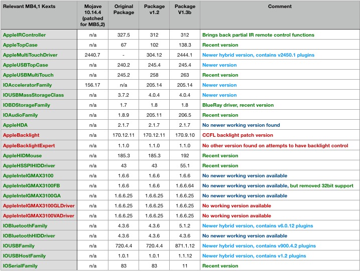

Update time for the MB4,1 again.
New "hybrid" kexts in v1.3b contain newer/up to date components. Version numbering is shifted accordingly, see table/screenshot.
Get the full package here. Tested and working fine with 10.14.5b3.

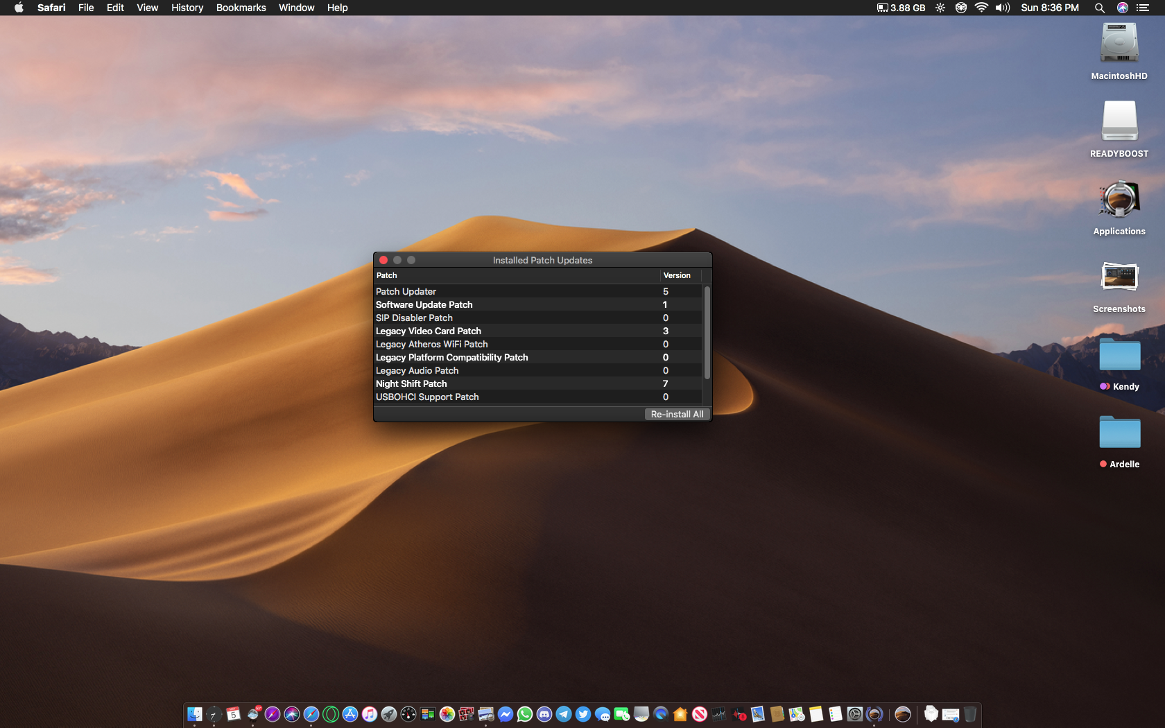

My Mac mini 3,1 (Late 2009) had been running perfectly for the last 34 continuous days, under 10.14.4
UNTIL just moments ago,
AFTER I applied a legacy webcam update, that the Patch Updater prompted.
within 7 - 8 minutes, complete crash and reboot.
Came back and I'm typing this from the Mac mini
Error logs below
What Happened?…and can I reverse that last patch cause I know it will now continue to crash
Thank You
In your log, the legacy webcam patch kext isn't even loaded at all.
Infact, except any Mac/Macbook with an embedded LCD, every other Mac mini, Mac Pro don't have any internal USB iSight/Webcam hardware integrated, anyway there are two weird facts:
1) Why someone should accept and install a patch for an USB internal hardware (Webcam) that is not physically present?
I mean if can plug a USB printer, an external USB drive, then surely can plug also an external USB Webcam without any additional iSight patch.
2) Why "auto-patch updater" prompts a patch for a machine that doesn't have any internal webcam hardware?
Even if they seem not related in any way, I guess there is a minimum chance that a legacyiSight patch could cause a random KP on a non-targeted machine.
