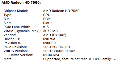

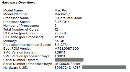

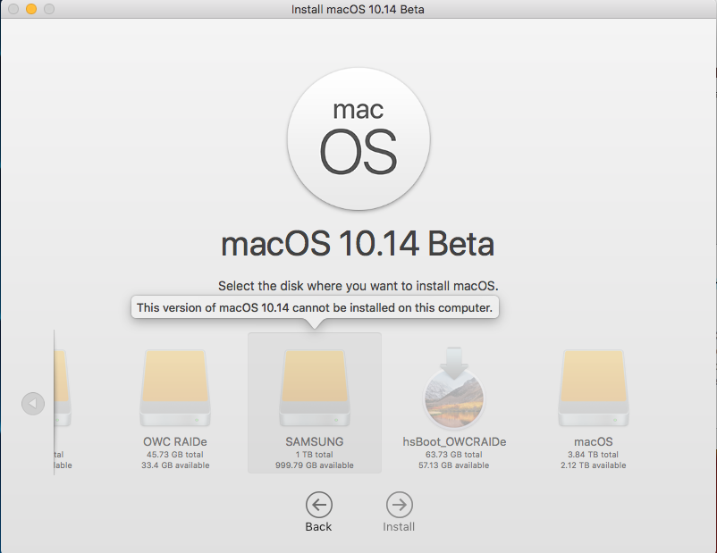

When attempting to install Mojave 10.14.1 on my cMP 5,1 2010, it launches the installer and I get the "Select the disk where you want to install macOS." All of my disks are greyed out -- I have several options including HFS+ and APFS freshly formatted. I also have a High Sierra 10.13.4 that is greyed out.
When clicking on any of the disks, I get "This version of macOS 10.14 cannot be installed on this computer." I have an upgraded AMD Radeon HD 7950 3GB Card that fully supports Metal.
What am I missing?
5,1 support will be in beta 2 according to the release notes. Of course we will get it to work sooner.
