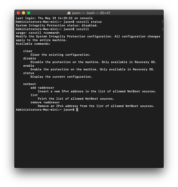

This one may be simpler to answer and probably has a lot to do with the fact I am running Mojave patched onto an older machine, but...
When I boot into the Cmd + R recovery and enable SIP, it says it was successfully enabled. However... When I log in and check.
SIP must remain disabled at all times when running Mojave Patcher, as having it enabled will cause issues with patched system files. SIPManager.kext is designed to ensure SIP is always disabled, regardless of the NVRAM preference. You should not attempt to enable SIP when running Mojave Patcher.
Noted. Thank you for replying.
Reactions: TimothyR734

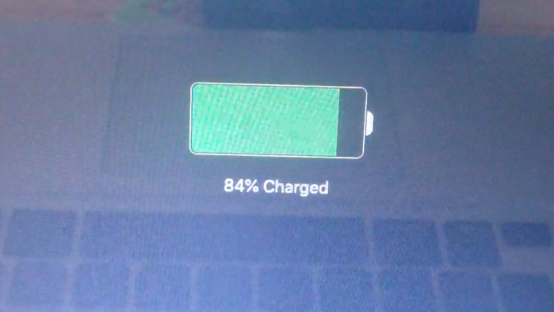

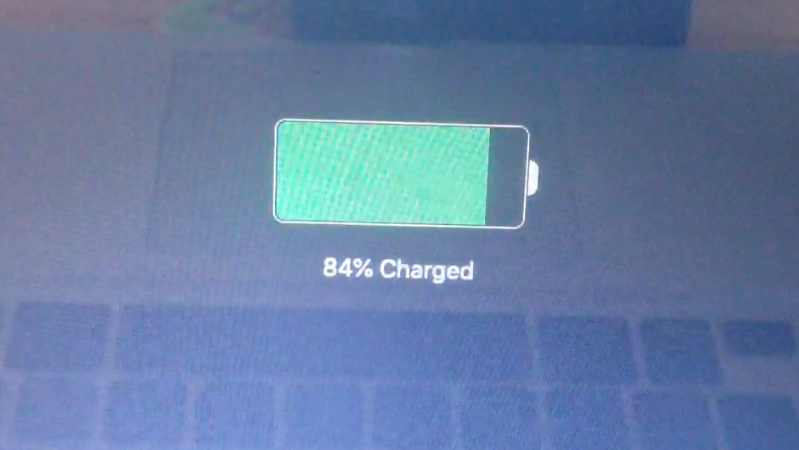

Does anyone notice this new feature after applying the Supplemental Update? I cannot charge my battery when using the MB, only when it is completely shutting down (Might be related to this feature)
When I attach the power cord to the MB and the screen is off, it shows this icon in the middle of the screen like on iPhones and iPads.

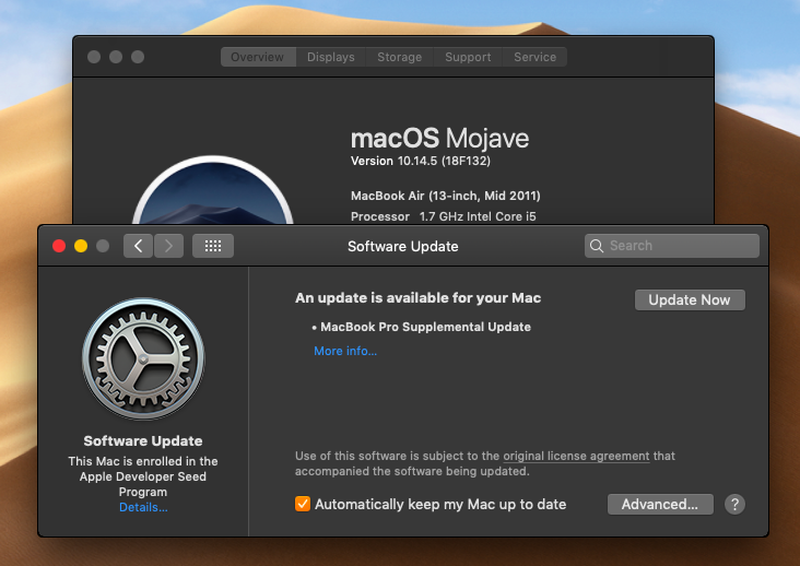

Update issue.
Here's my setup sequence for an unsupported MacBookAir4,2.
I was on 10.14.5 Final and decided to test the latest beta (10.14.6 beta 1). So I signed up for Developers Beta program.
Upon reboot, I was presented with the Mojave 10.14.5 supplemental update. I do not want this update this since first of all, my said device does not have a T2 chip, and read in this thread that it poised some issues if you do.
How can I bypass this supplemental update and update straight to the developer's beta 1 of 10.14.6?
Thanks for any input.

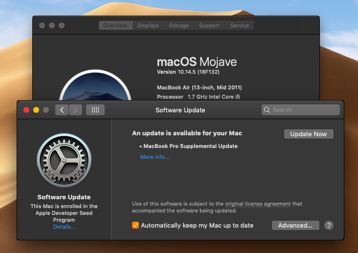

do you have the developers beta profile installed as when you check for updates it should say enrolled in the developers beta program and should skip the supplemental update
734, post: 27386781, member: 1126371"]do you have the developers beta profile installed as when you check for updates it should say enrolled in the developers beta program and should skip the supplemental update[/QUOTE]
Yes, it did confirm that I'm enrolled. See screenshot below (on the left side).
Thanks.
Thanks.[/QUOTE]
Did you click on more info sometimes there might be the beta update if so uncheck the supplemental one and instal 10.14.6 beta 1
Thanks.

When I clicked "more info", it only showed the supplemental update.
Thanks for the response.

I did that as well (unchecked the supplemental update). No dice. Thanks.
You're right, I got prompt the 10.14.6 beta 1 update (but I didn't installed) from May 15th until 22th , but now only prompted for 10.14.5 supplemental, so I guess it is not so simple to avoid this OTA update, but if you find and download (from the beta sucatalog.gz) the "macOSUpd10.14.6.pkg", then surely you can install it manually through editing the Distribution file as explained here by many posts.

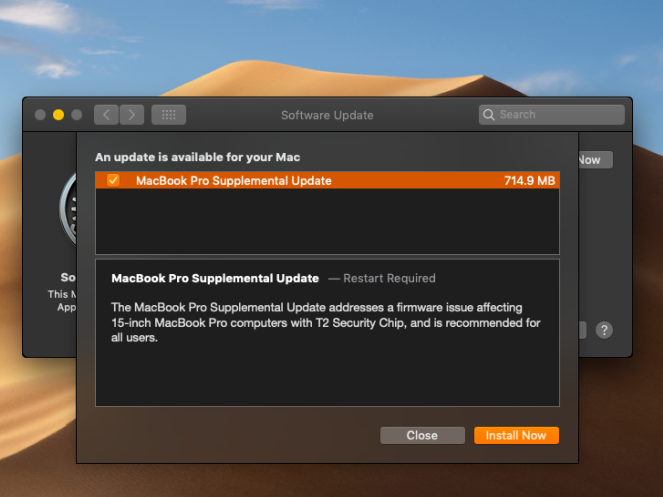

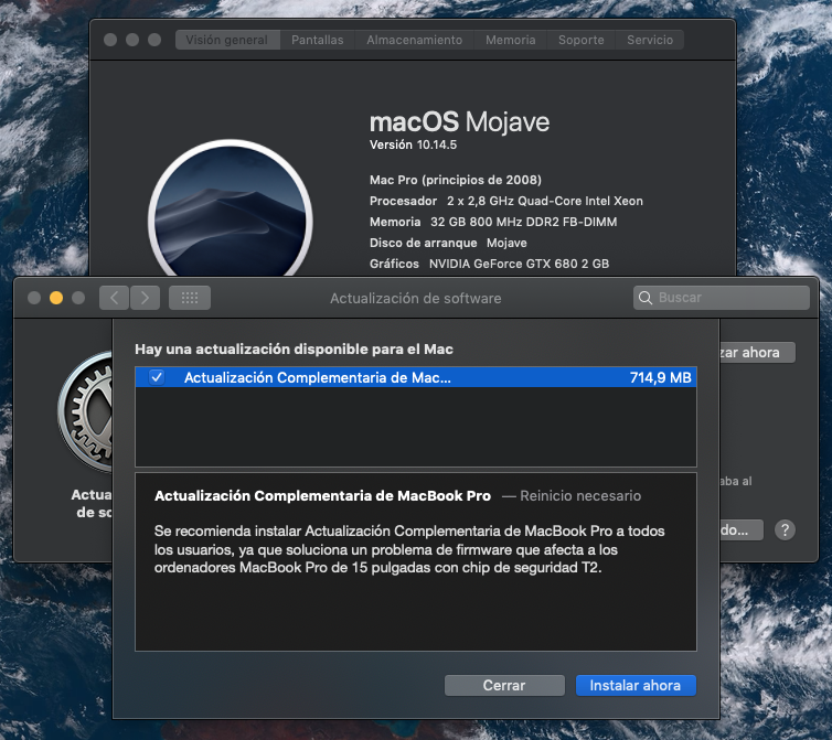

I'm not on the beta boat, but I've got this morning an update for my MacPro 3,1. BUT, it says that is an update for a Macbook Pro... specially driven to T2 chip owners.
I enclose a screenshot.
NOTE for all: as @jhowarth pointed before, latest official Mojave version for pre-2018 Mac is 18F132 , this May 22th recent 10.14.5 18F203 supplemental update is NOT prompted to any Mojave supported Mac pre-2018, I tested right now from a 2012 MBP I only got a prompt for 10.14.6 beta 1, so it's clear that apple (rightly) doesn't care to offer this T2 CHIP update to unsupported machines, then it's not advisable to download and install it, even if that update won't damage your unsupported Mac, if you accept it and download you'll follow the "Product ID" OTA updates for those T2 Chip products, not a good path especially for non-T2 machines and unsupported Mojave Mac.
Thank you JackLuke. It seems is downloaded in my mac. Any step in order to delete it? or any advice to "forget" this updates?
