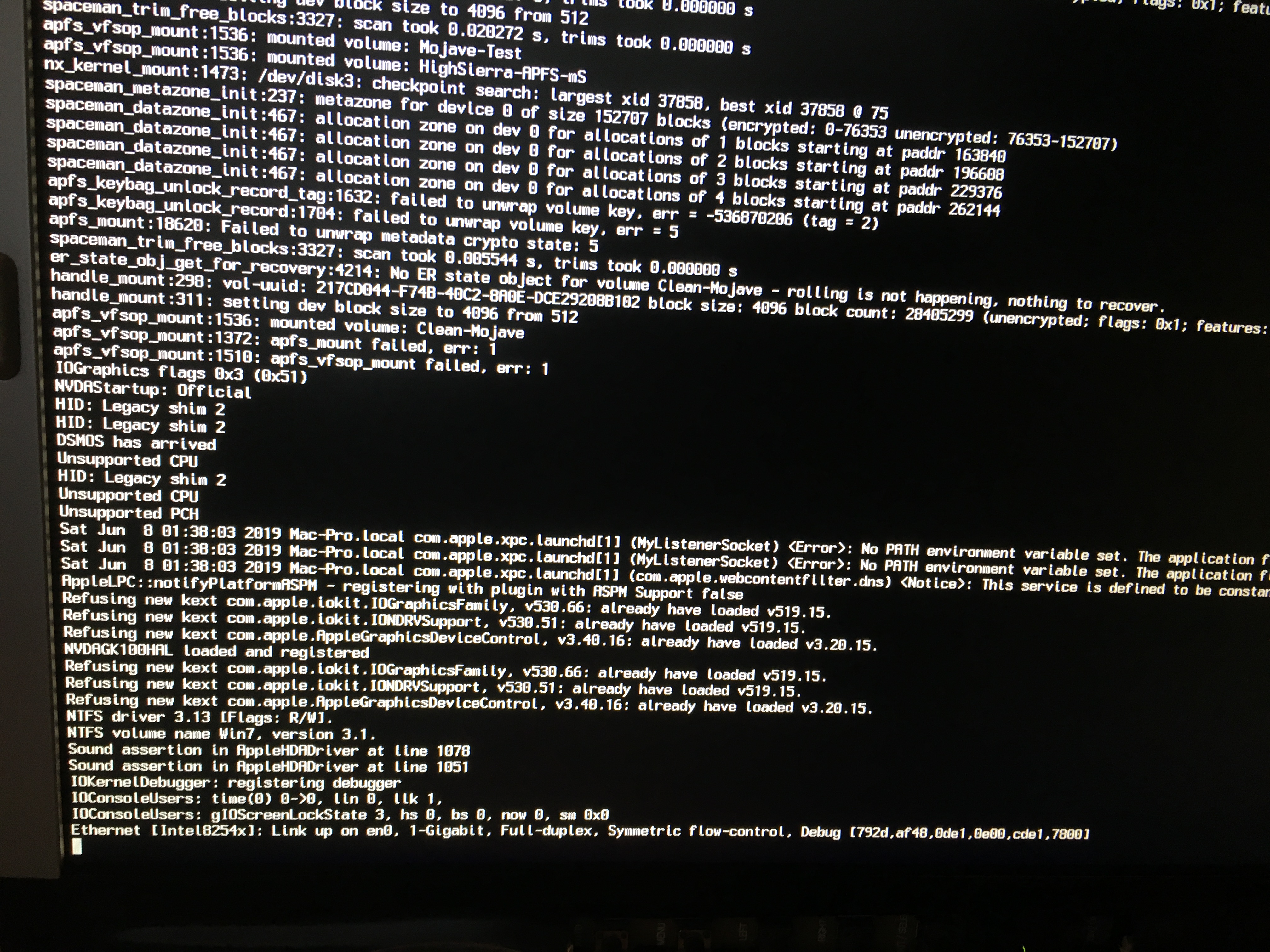

I don’t need it accelerated. You’re missing the point I’m trying to make. The installer UI NEVER LOADS for me. It just leaves me at the verbose boot screen complaining about kext version differences.
I’ll have to redo it and take some photos for you all.

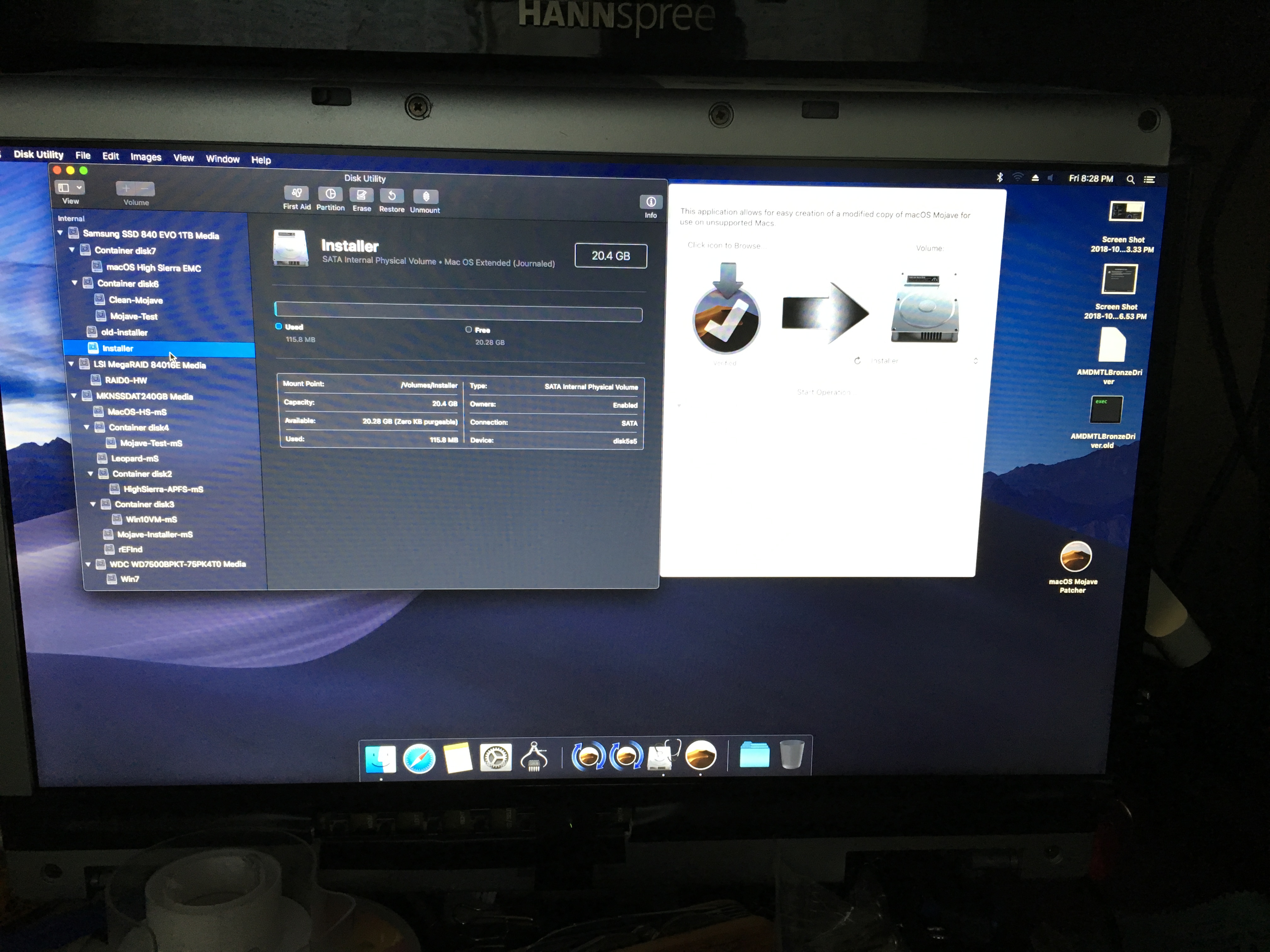

So during my install I'm using my GTX 650 since it has been EFI flashed and my RX 580 is for a different machine. If I get this working I'll get another 580 or 570.
I'm using the tool to download a fresh virgin copy.
I just redid this again now.
Made a new installer partition and installed there. Then booted from it.
Here is where it stalls.
[doublepost=1559958960][/doublepost]
Now I get it… Did you try to patch the installer using netkas' method? This might be necessary to avoid SSE4.2 issues in this case (@dosdude1 ?). If so either try this or try booting the installer in safe mode (shift while booting or a -x [nvram] boot-arg). This could help.
You could also try to delete any AMD* file from the installers /System/Extensions/ directory, though this will fail, if you do not have an EFI enabled GPU.

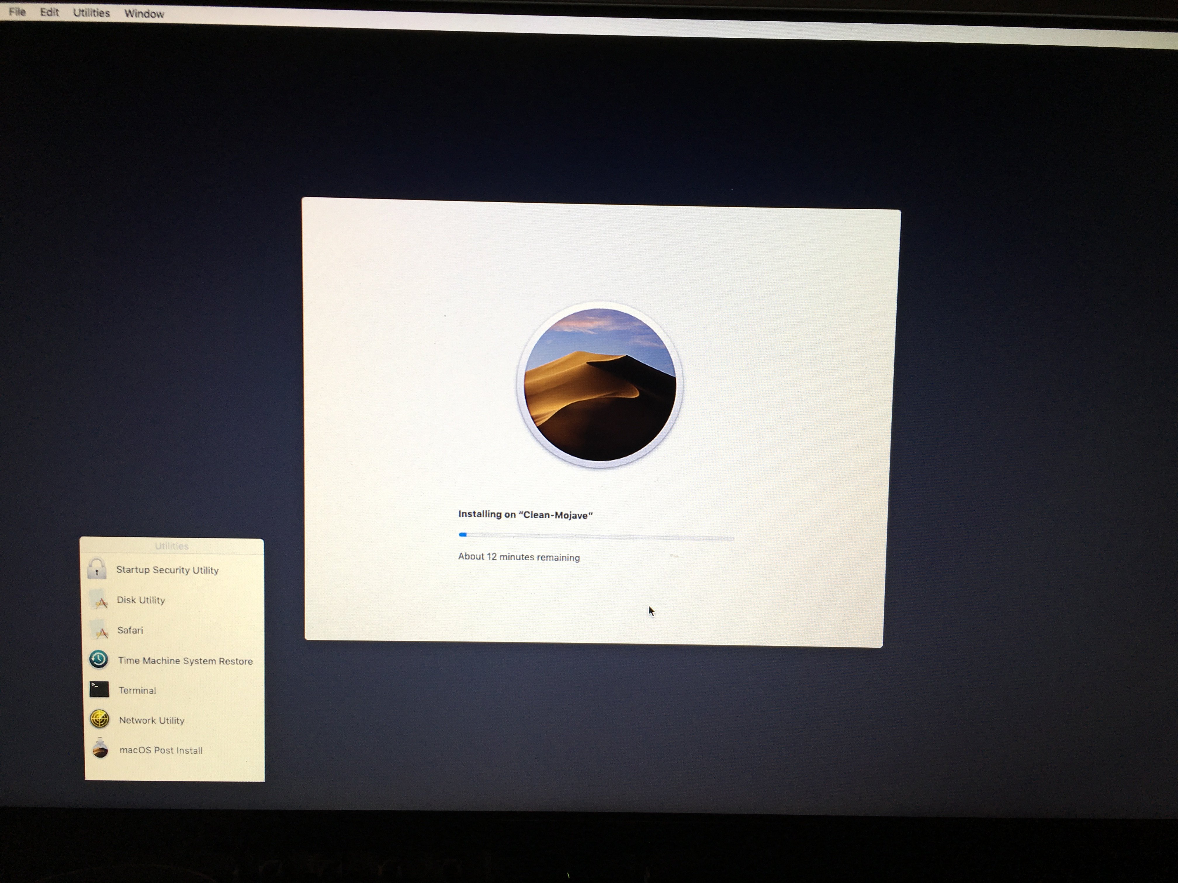

I didn't patch for SSE4.2 until after install / update was done. Then rebooted a couple times then I powered off and swapped the 650 with the 580.
I'm using the nvidia card during installer.
But your suggestion was a hint at the answer.
I booted the installer in single user mode remounted read write and moved all the NVDA* out of SLE. then rebooted. Now it instantly went to the installer UI.
Now I'm doing a new clean install.
[doublepost=1559959374][/doublepost]Oh and maybe audio will work this time.

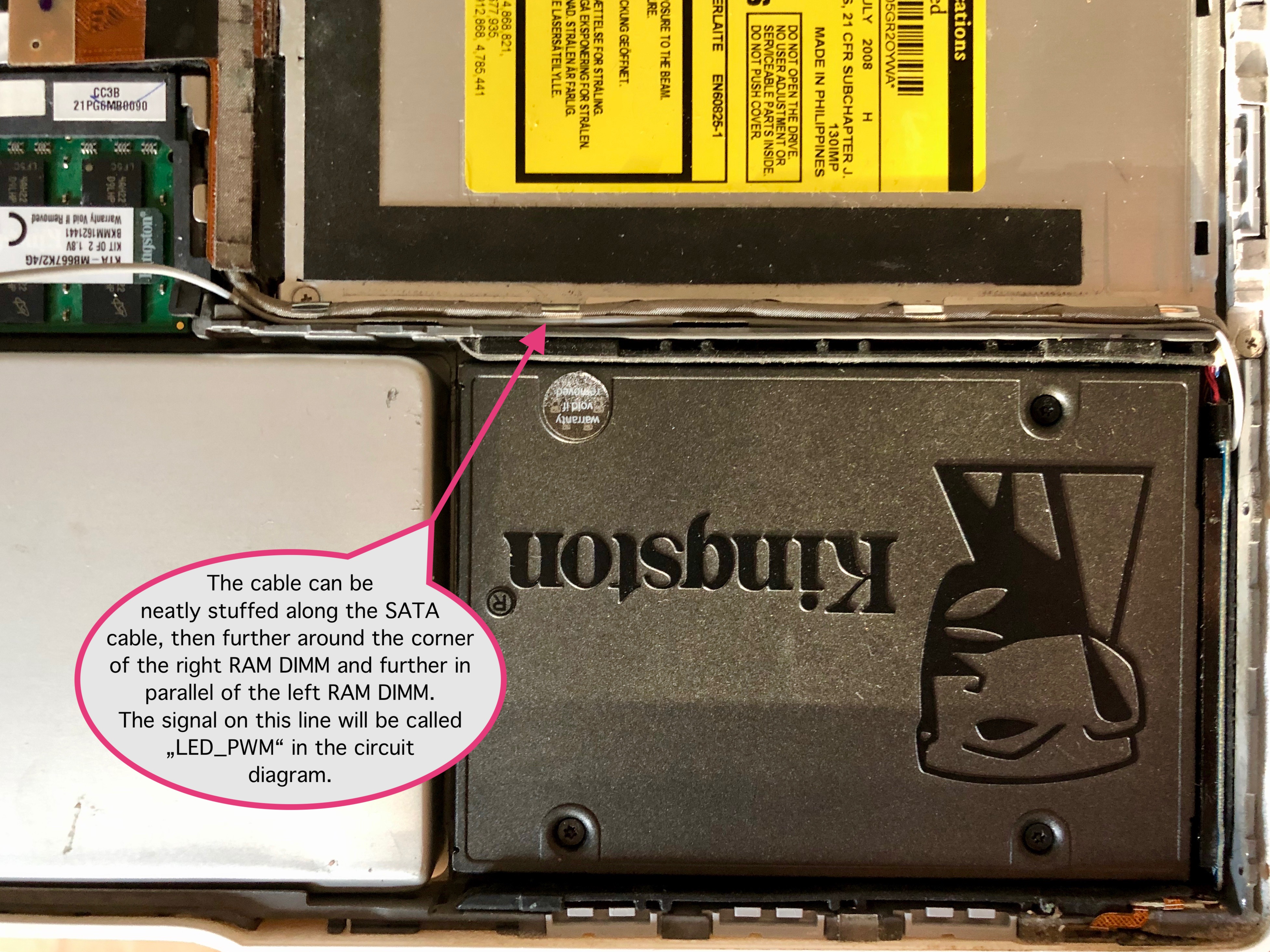

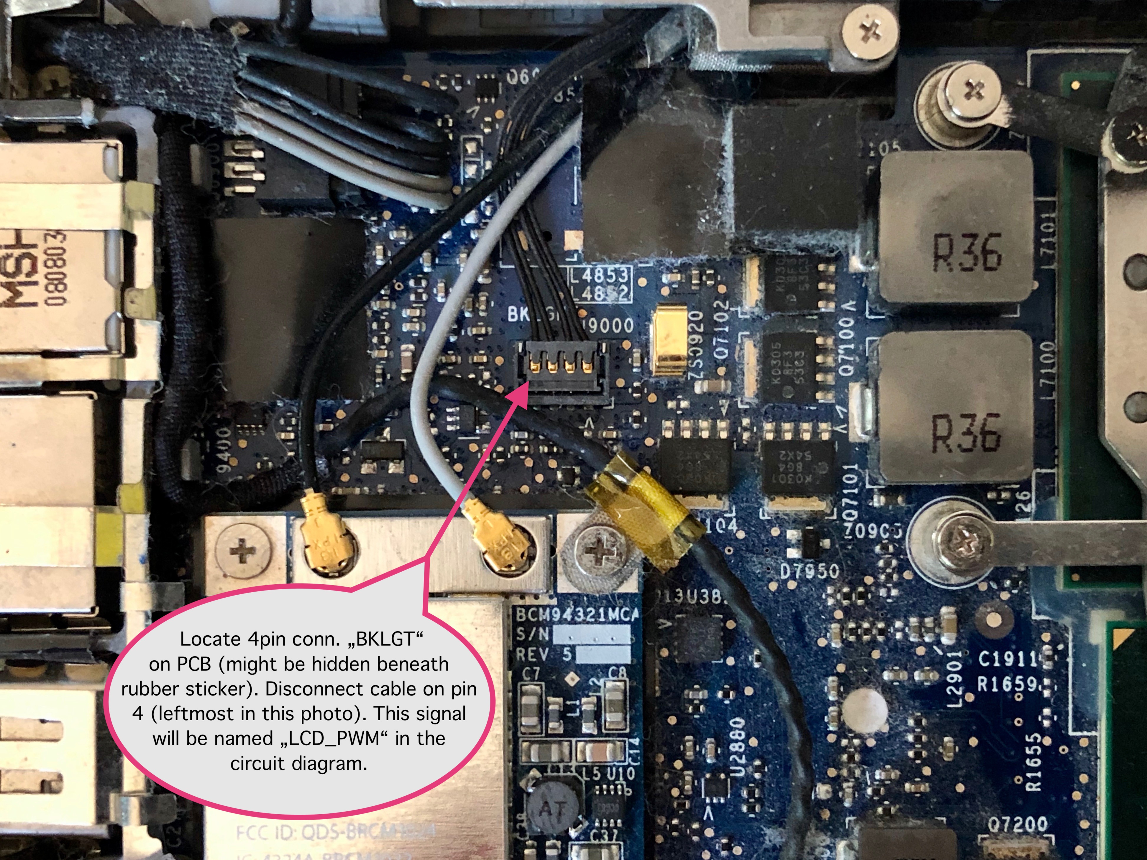

Good news from the "doubly-unsupported" MB4,1.
While there still is no solution for the brightness control of the display on this machine, I found a way to get back display backlight power-off while semi-sleeping (utilizing NoSleep in v1.5.1) or when the lid is closed.
Unfortunately, this is a tiny hardware modification that I´ll document later today. It can be done with medium soldering skills and fits nicely into the machine so everything can be assembled back to the original closed state. Total time to do this: Around 1h, with parts costing below €1,-

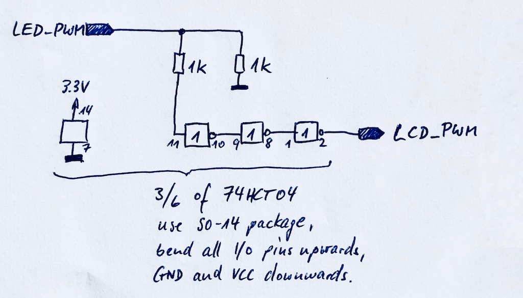

So here we go with the circuit for the modification.
The BOM consists of
1x 74HCT04 hex inverter logic IC
2x 1kOhm resistors (any wired non-SMT type will do)
The idea behind the circuit is to use the SMC-generated LED PWM signal that ramps from off (floating) to 100% on (3.3V) whenever either the lid is closed, during startup or when macOS tries to enter sleep mode (which is prevented by the NoSleep extension because we could never wake up after that). This signal could be used directly as a driver for the PWM LCD input, only it has a reverse logic for that. Screen backlight is on when the signal is 3.3V and off at 0V.
So we need to invert it at least 1x (but in case of optional additional R-C timing that might have been we do it 3x here).
Pls. excuse the free-hand drawing of the circuit (and Euro style for Rs and IC gates) - I did not like to fire up an ECAD system on my weekend for this li´l circuit ;-)

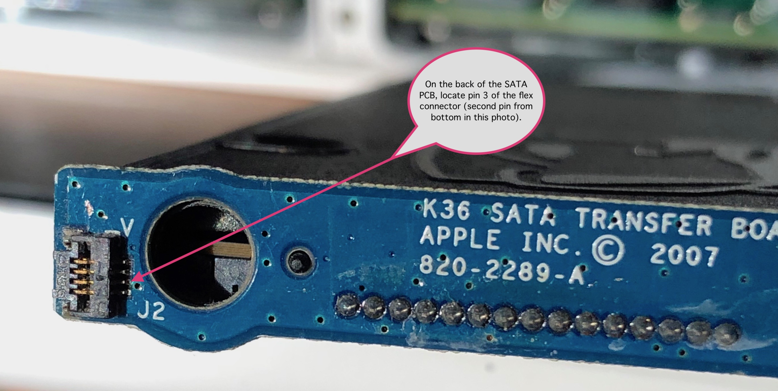

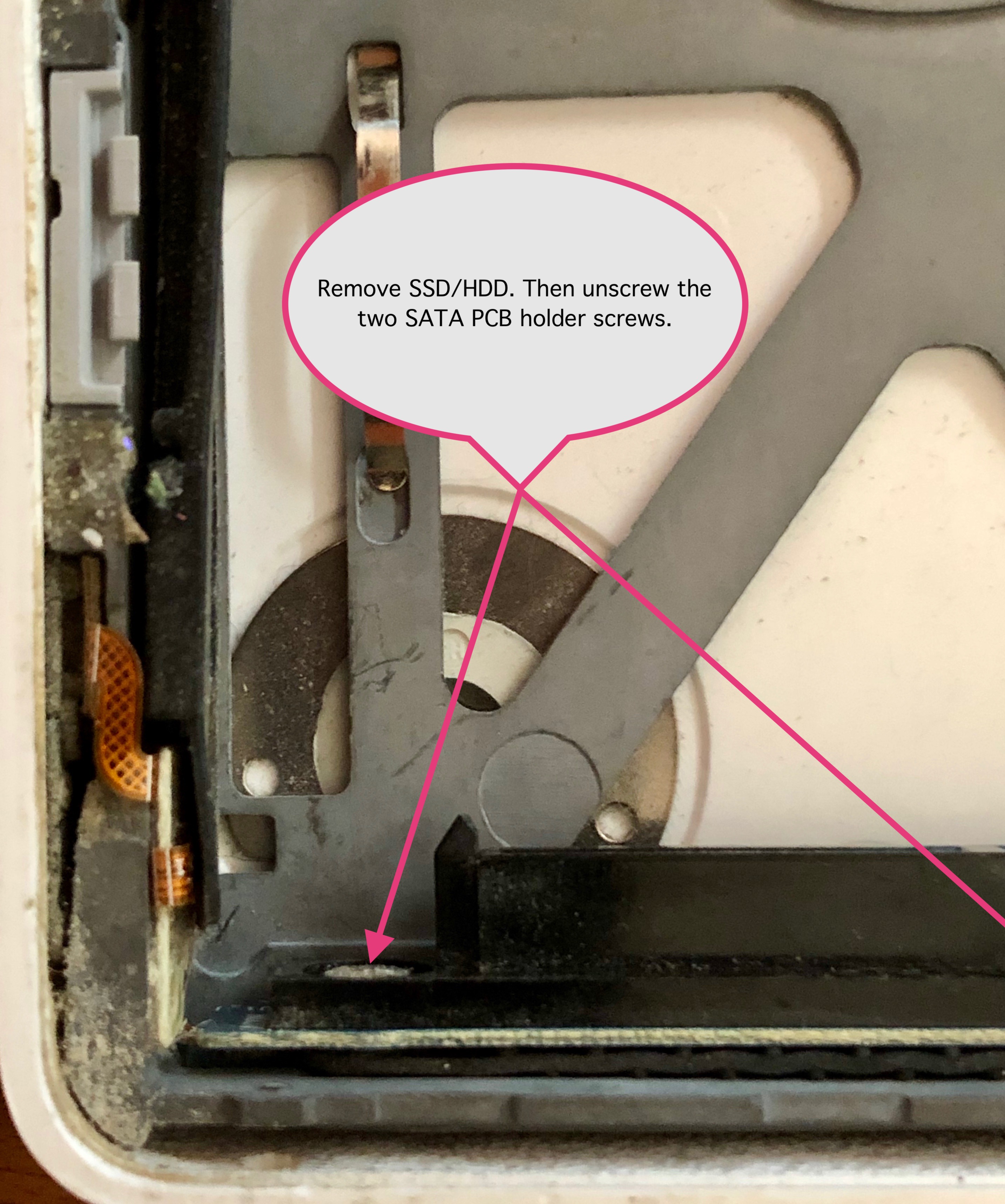

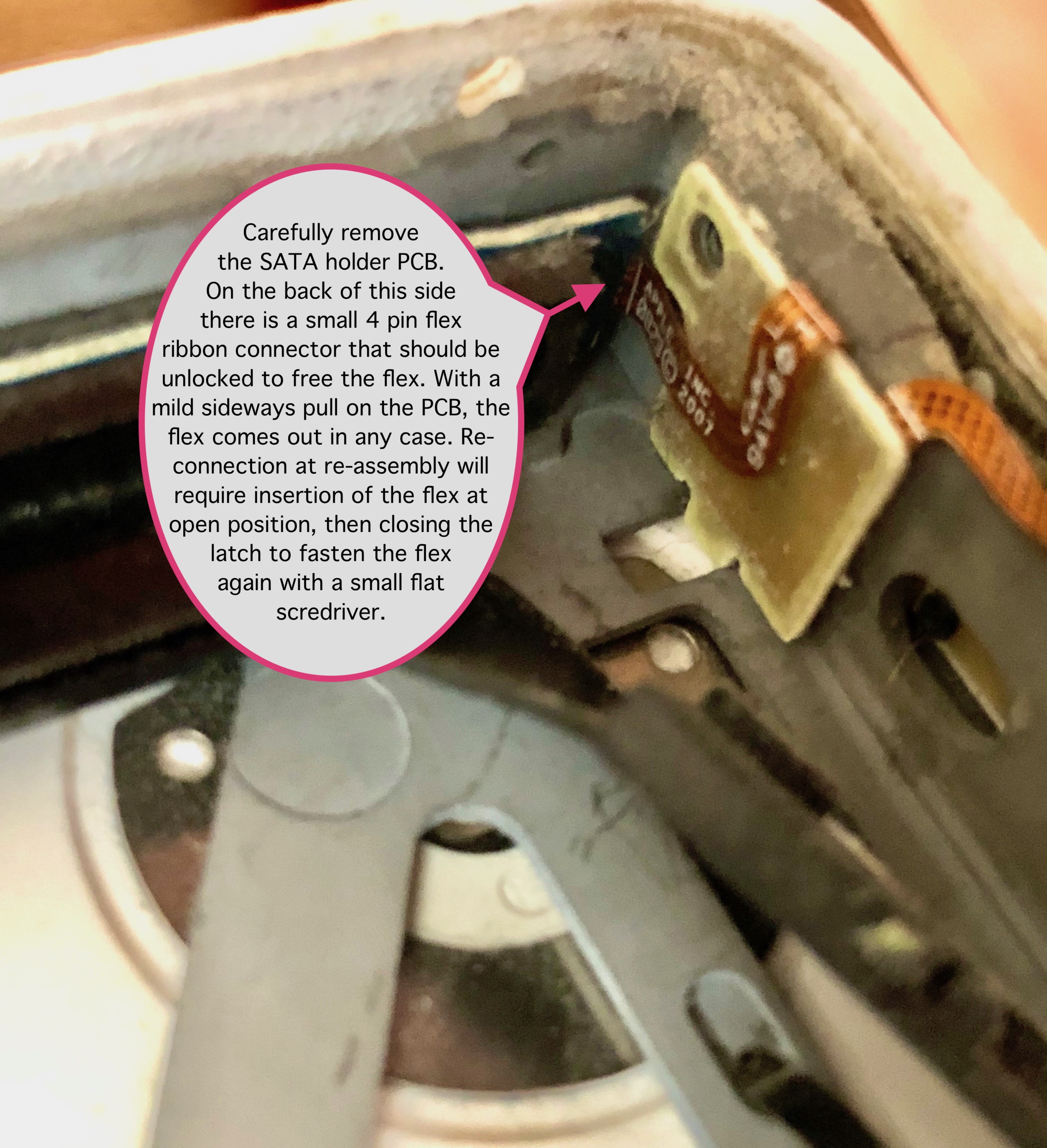

I skip all steps needed to get to the right place on the PCB, so we dive right in:
1.
2.
3.
4.
5.
6.
7.
