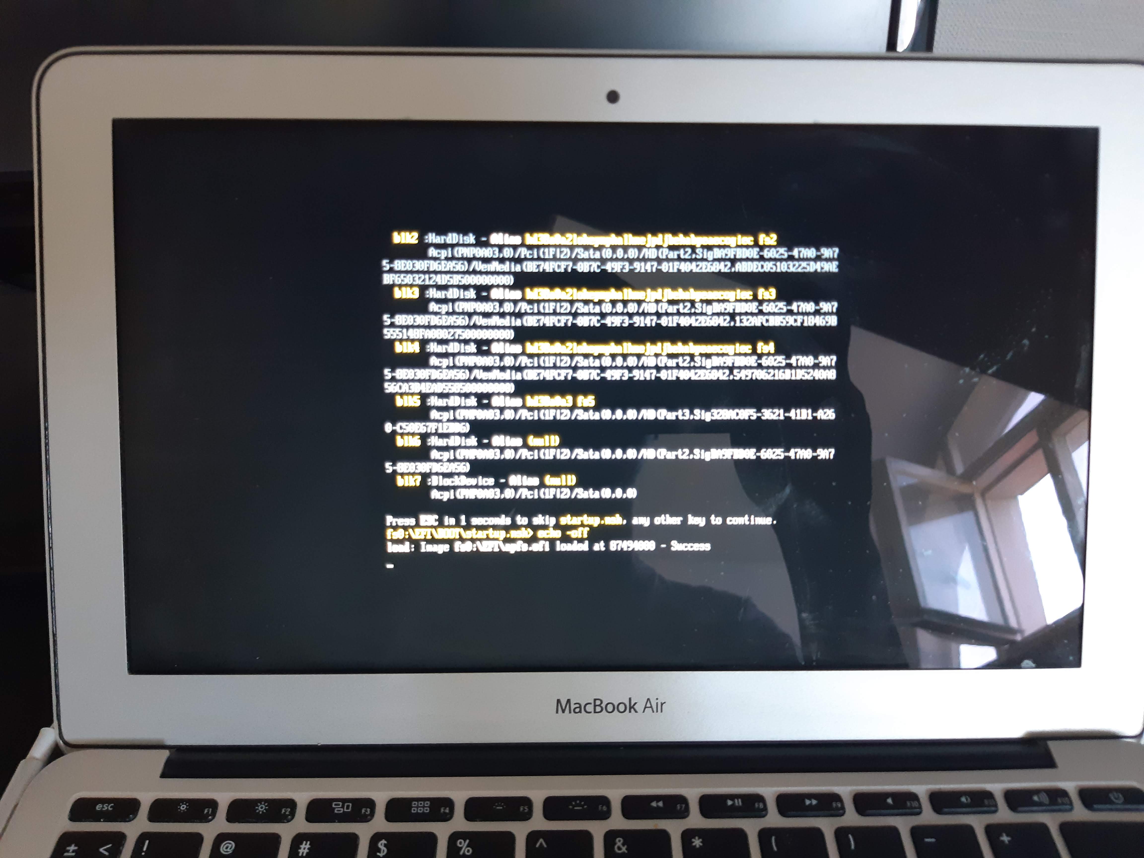

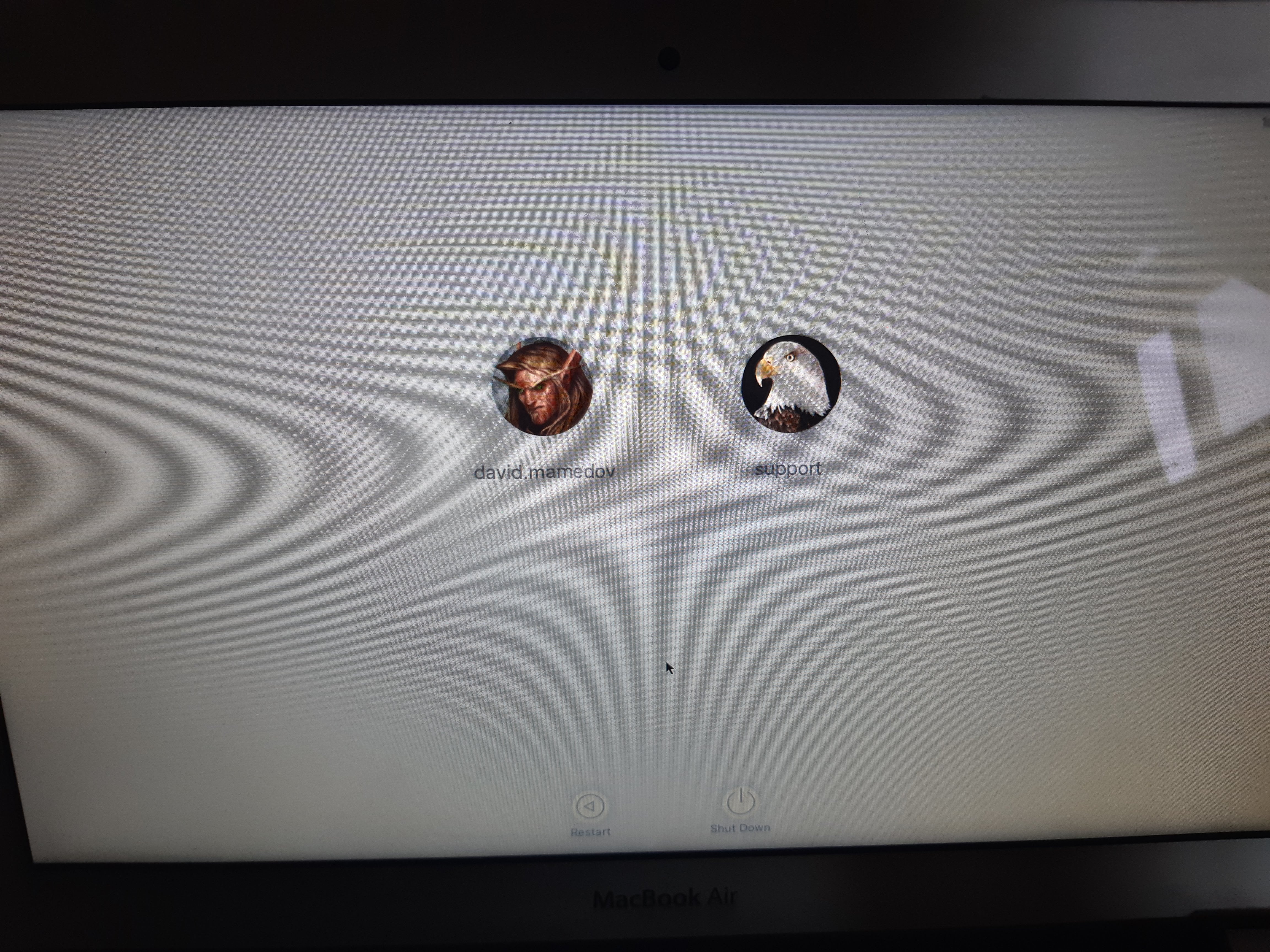

Hello there. I installed Mojave 10.14.3 on mid 2011 MacBook Air using patcher by DosDude. System booted successfully only after post-installation patches, but after them I see EFI shell (verbose mode?) every time and instead of standard login screen I see plane white one with all users (according to my current settings the login screen must automatically show my profile). I tried to delete all boot arguments using following command: sudo nvram boot-args="" , but
it always boot up with EFI shell and logs. How do I turn off the shell and always use "graphic" boot?

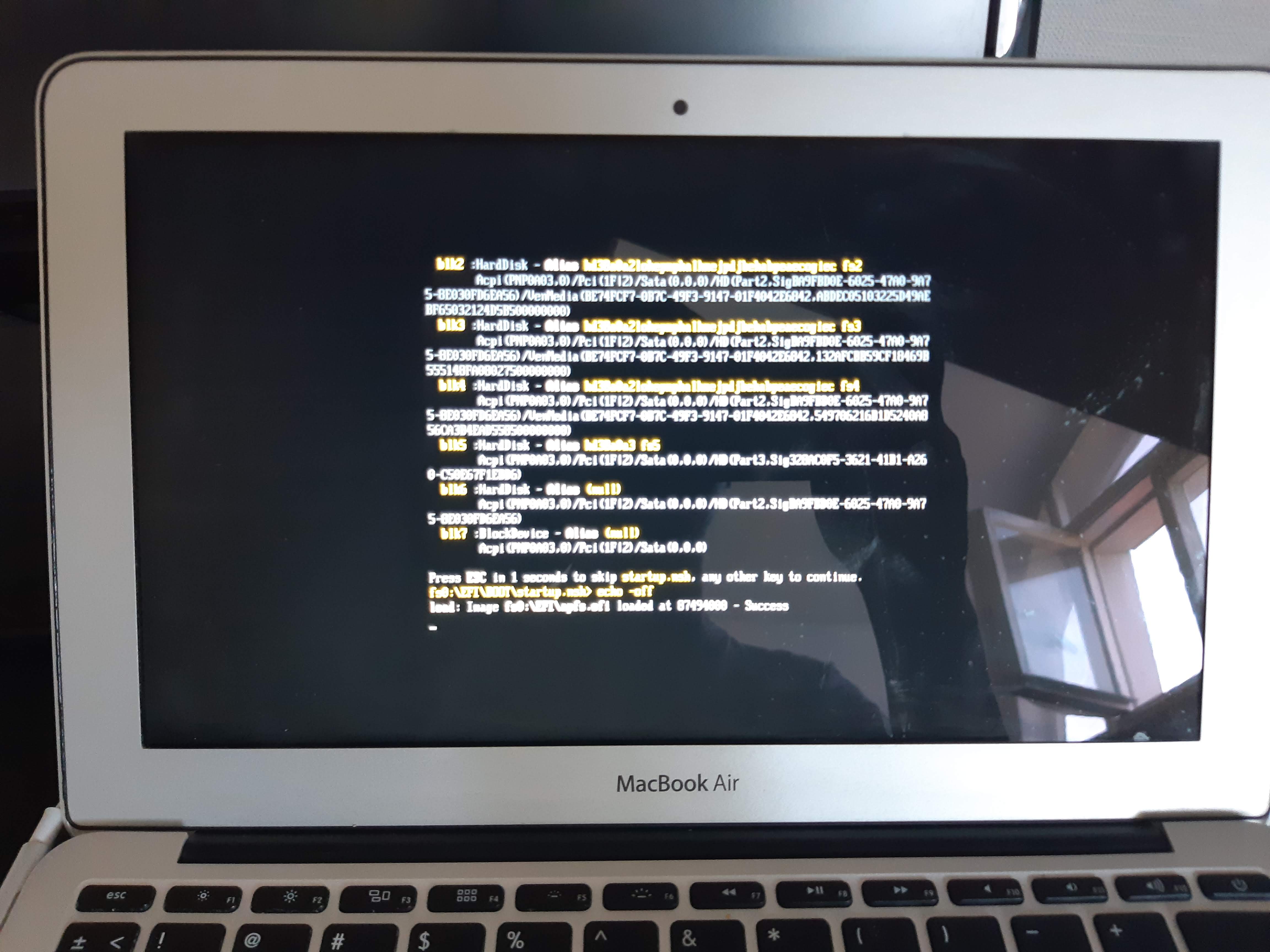

Make sure that you already applied appropriate firmware updates to support APFS(if you had High Sierra installed on APFS previously, you should be good).
