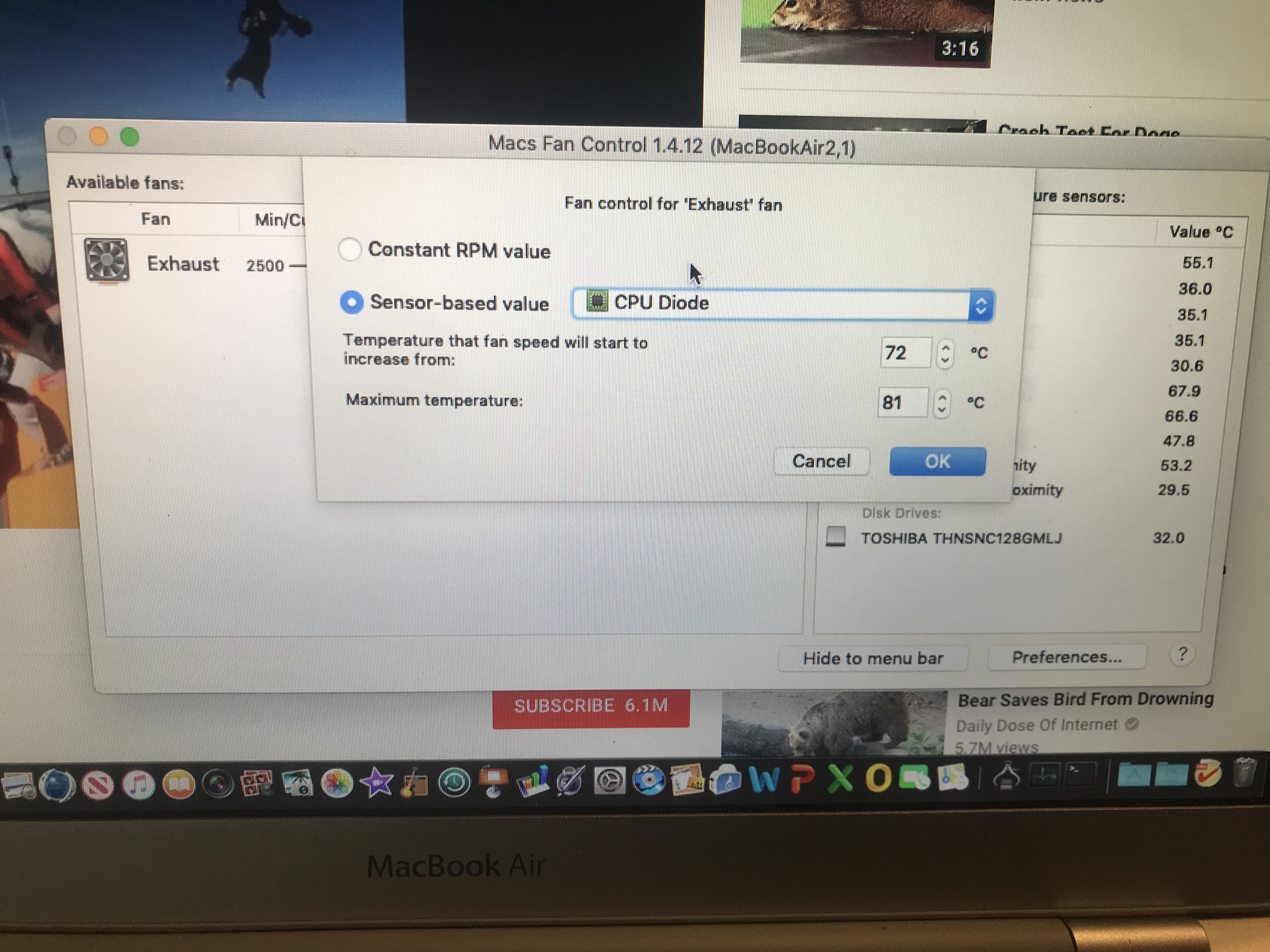

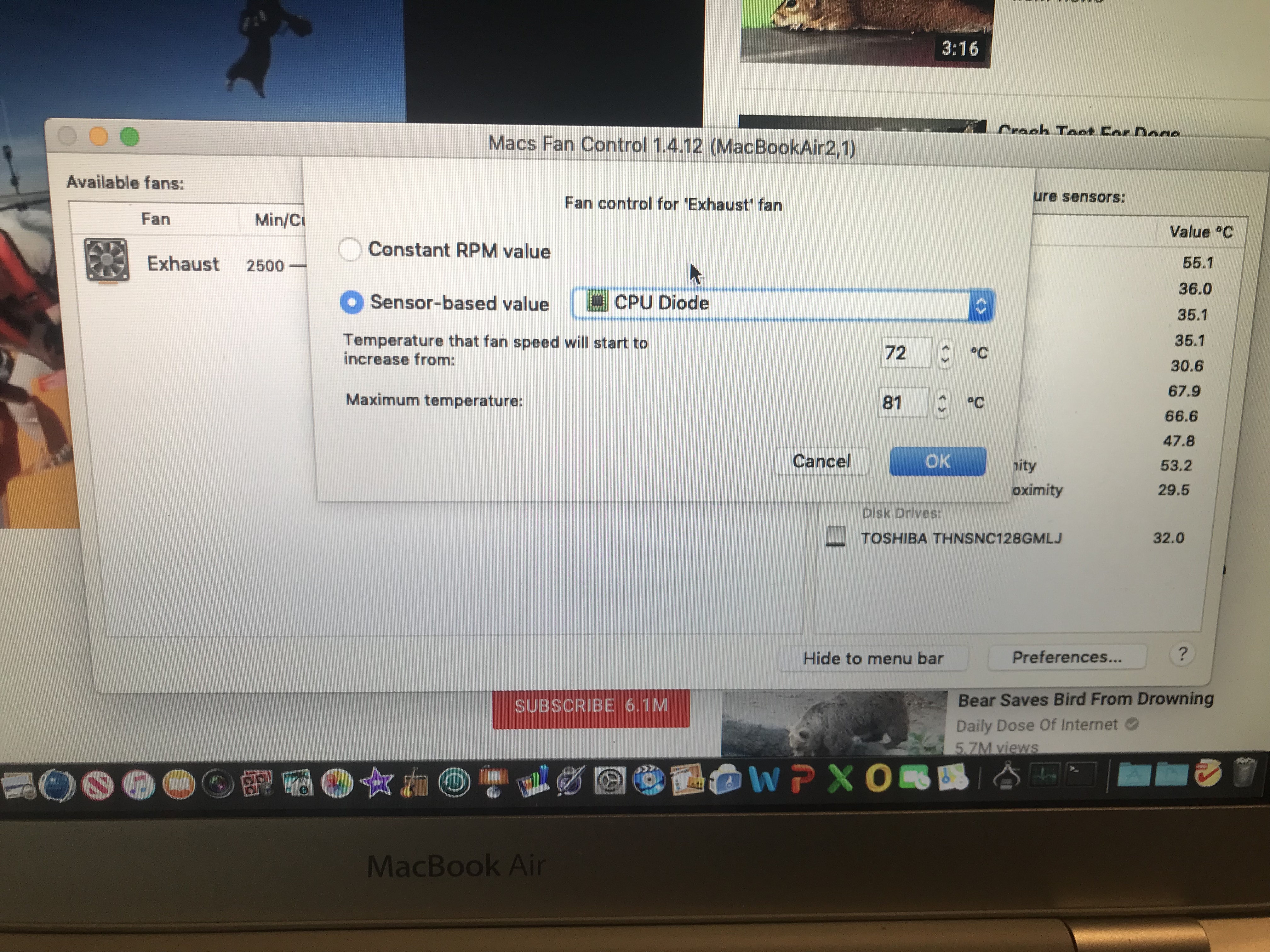

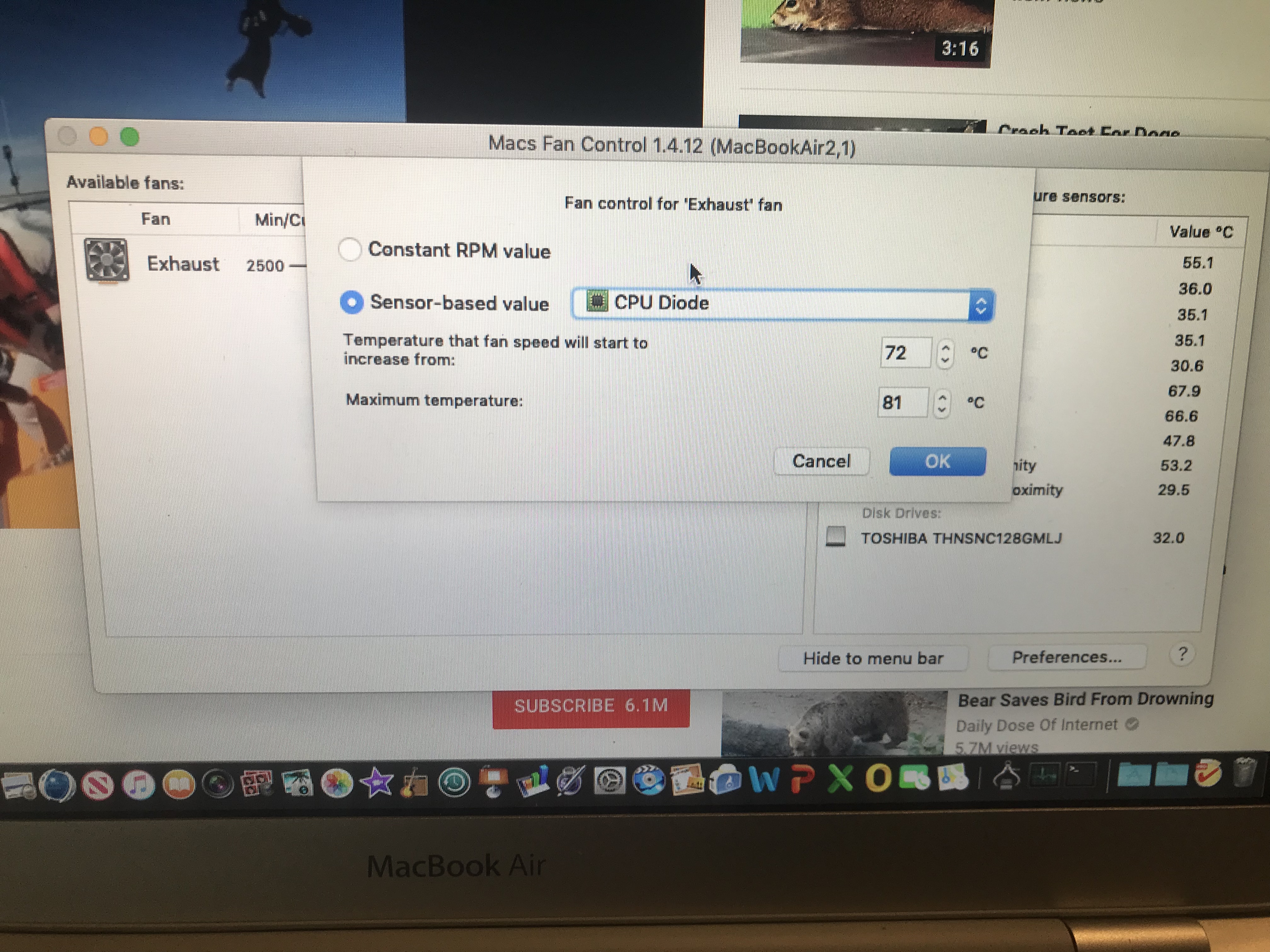

Had a weird problem with 2 identical MacBook Air 2,1 laptops. These are 2009 models with 2GB ram and a 128GB SSD. Both behaved identically with duplicate clones of 10.14.3 with all patches and updates applied. After indexing, while sitting at the desktop with no activity, fans were at 2500RPM as expected. Opening ANY program or doing ANY task would cause the fans to begin to climb all the way up to 6200RPM. This took several minutes but always ended with fans on Max. This was not an SMC / NVRAM issue. Updated one of them to 10.14.6, problem still occurred with Fans set to Auto in MacsFanControl, but changing that to Sensor Based Value, CPU Diode, 72-81 Degrees C made the issue mostly go away. Opening Safari and going to Youtube now kicks the fans up for a brief few seconds but then settles back down to 2500RPM reliably. Bottom of the laptop gets a little warmer than normal but still acceptable. Anyone else run across this?
After finding the settings that worked on the one, I copied the settings from MacsFanControl to the one still on 10.14.3, but the problem remained. Only after updating the 2nd one to 10.14.6 and duplicating all the settings was the issue mitigated. So this does not appear to be just a one off issue, both machines behaved identically. MacBookAir2,1 Fan Control.jpg
After finding the settings that worked on the one, I copied the settings from MacsFanControl to the one still on 10.14.3, but the problem remained. Only after updating the 2nd one to 10.14.6 and duplicating all the settings was the issue mitigated. So this does not appear to be just a one off issue, both machines behaved identically.View attachment 857972

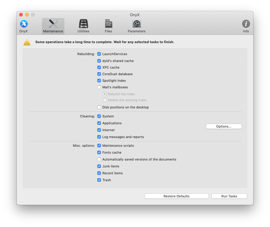

Did you check with the activity monitor if you had a task in constant operation?
I had a problem a bit similar with MBP5,3 after the update from 18G87 to 18G95 but it was "kernel_task" which was constantly 98% and 5 minutes after boot the CPU temperature was 80°C (while usually the temperature is 40/42°C).
I remember having already had this problem after update from 10.14.2 to 10.14.3

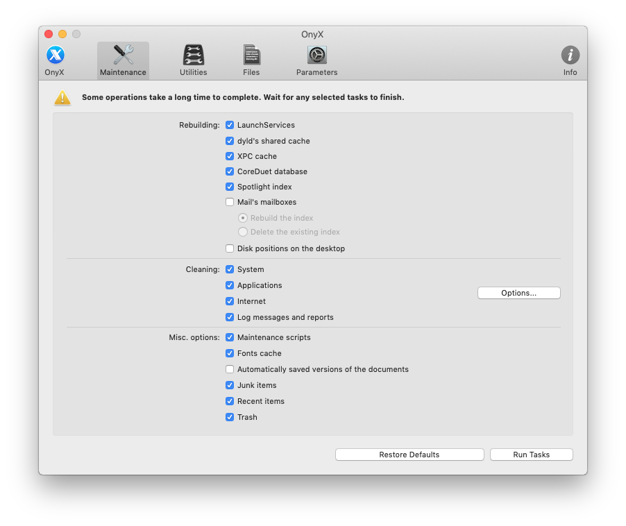

Everything is back to normal after running maintenance with Onyx.
Yes I ran maintenance via Onyx and it did not solve the issue. Activity monitor showed nothing running, and if you left the machine alone the temperature and fans stayed within normal ranges. This was also not an update situation, this is a master image and has been very thoroughly tested.
Make sure that your battery is in perfect health.
Reactions: K two
Both batteries have a low cycle count and show good status in both Mojave and Coconut Battery. Does anybody have a MacBook Air 2,1 with 10.14.3 or newer that does NOT exhibit this behavior? I'm pretty convinced this is a software problem, not a hardware one.

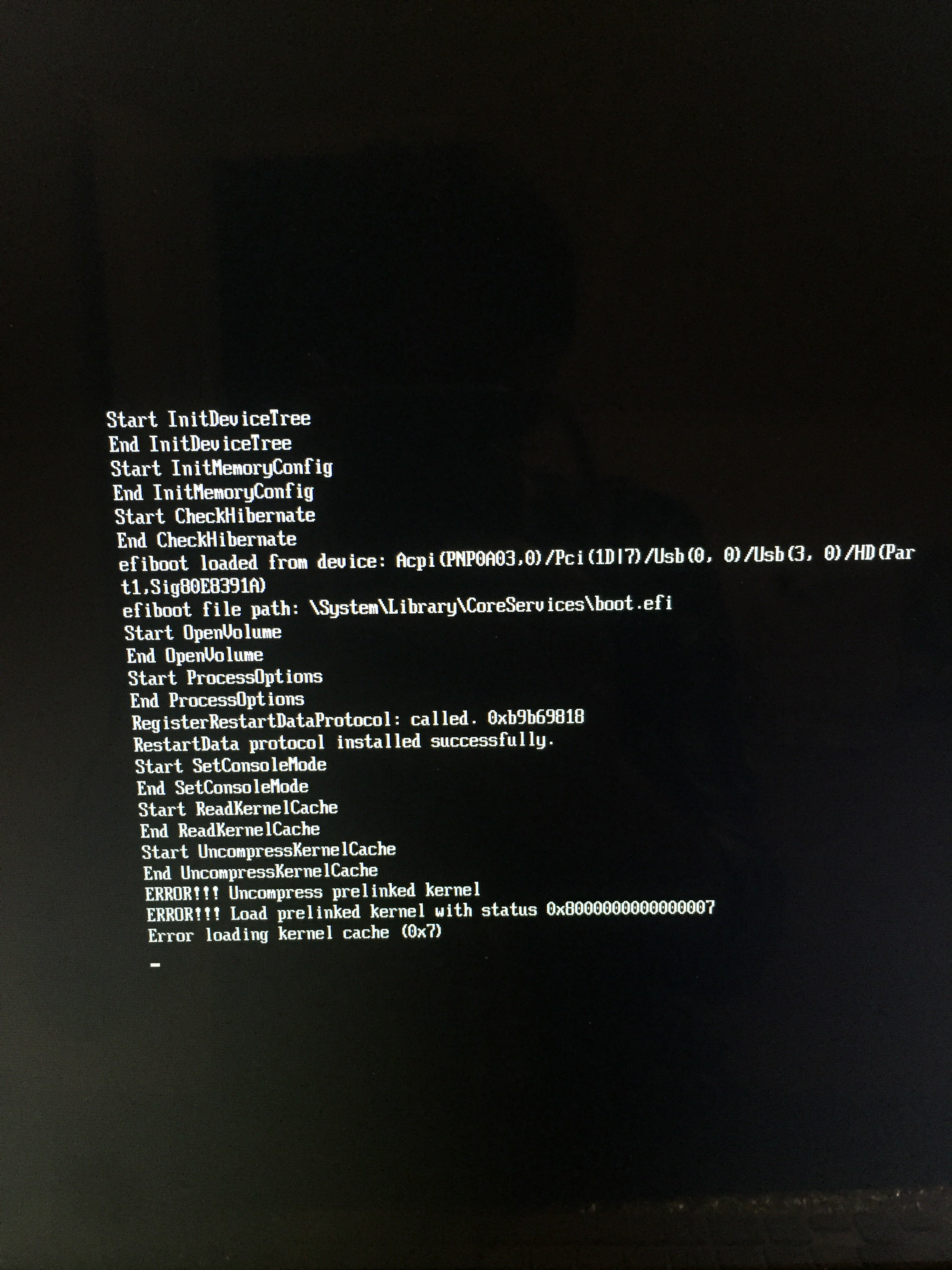

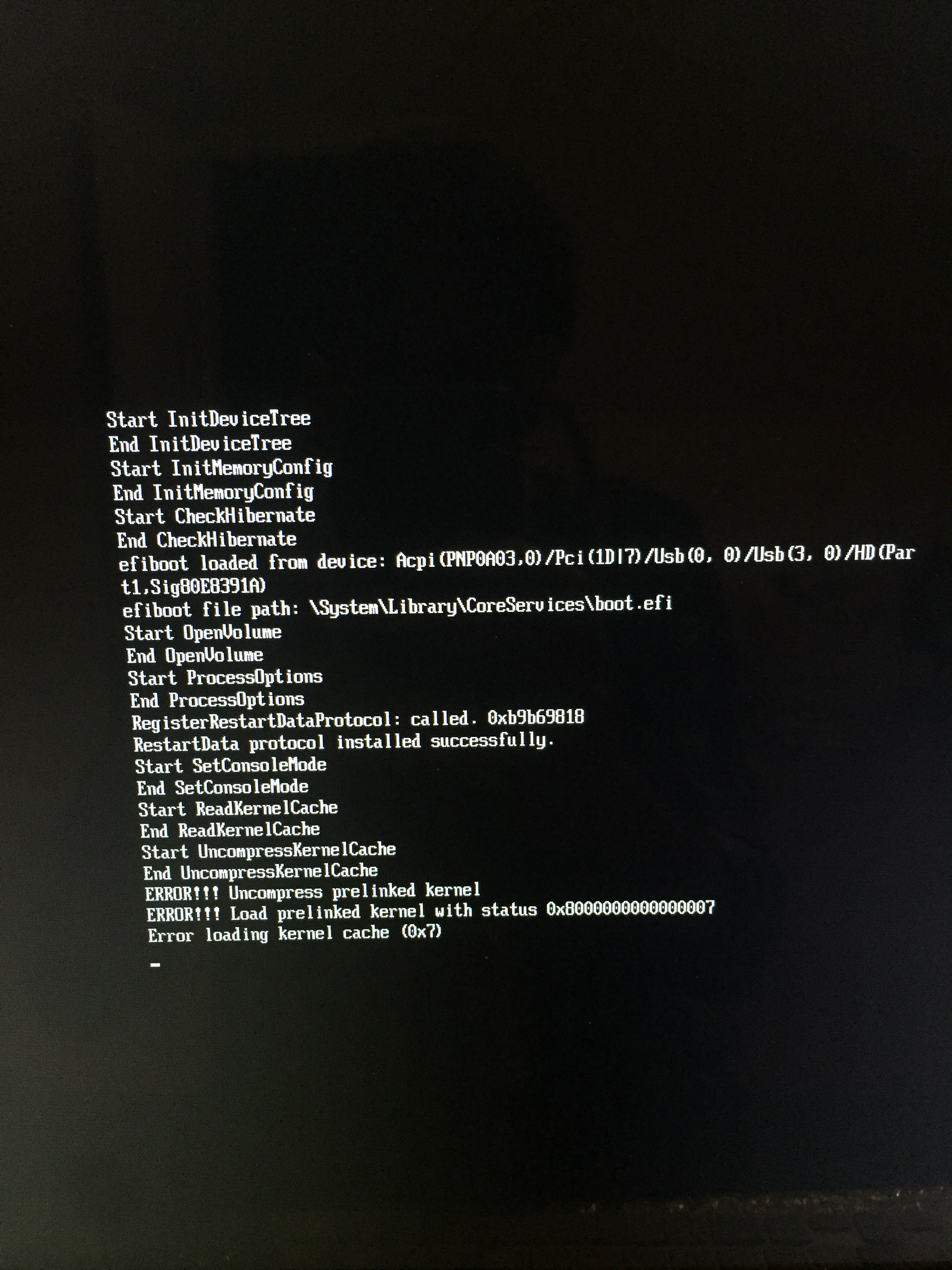

Hi,
I have tried Mojave Patcher 1.3.3 on iMac11,2 but the mac refuses to boot from USB. I have enabled the verbose on boot and when I try to start from USB (USB patched with Mojave Patcher) the following error is showed:
ERROR!!! Uncompress prelinked kernel
ERROR!!! Load prelinked kernel with status 0x800...07
How can I resolve this situation? Thank you

Hi,
The USB is HFS+ partitioned?
For the installer USB drive the instructions only say how the installer partition should be formatted:
"1. Insert your desired USB drive, open Disk Utility, and format it as OS X Extended (Journaled)."
To remove doubt from the user, the instructions should also say that the USB drive should have a GUID partition scheme (as I have done) or the instructions should say that the partition scheme can also be MBR or none at all if that is the case.

Hi,
I also had issue with the Mac (MacBookAir3,1) failing to boot from USB patched with Patcher 1.3.3. I don't know if it's the same issue as I didn't know about the verbose mode at the time, but immediately after booting the Mac only showed the prohibited/denied sign (circle with a line across). I downloaded Patcher 1.3.2 and recreated the installer from the same Mojave installer I previously downloaded and it worked without issues.
Reactions: 0134168

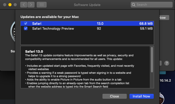

Is it OK to install these Safari and Safari Technology Preview updates on my 17" early 2008 MacBook Pro (MacBookPro4,1) 2.6GHz 6GB RAM 500GB SSD running macOS 10.14.6 ? If so does it require the macOS Mojave Patcher 1.3.3 post install patches (and separate Terminal installed Backlight Control patch for my 17" CCFL display) to be reapplied?
I installed these updated on my 2017 MacBook Pro 15" (MacBookPro14,3) and it didn't require a Restart...

Is it OK to install these Safari and Safari Technology Preview updates on my 17" early 2008 MacBook Pro (MacBookPro4,1) 2.6GHz 6GB RAM 500GB SSD running macOS 10.14.6 ? If so does it require the macOS Mojave Patcher 1.3.3 post install patches (and separate Terminal installed Backlight Control patch for my 17" display) to be reapplied?
Yes, install them. No restart and no re-patching required, as probably always with mere application updates.
Reactions: MTBnBeer
Thanks! I installed both the Safari and Safari Technology Preview updates with zero drama. No restart or Mojave Patcher required. :cool:

HP Probook 4420s
I installed 10.14.4 from the mojave patcher, also patched to receive QE / CI, but when I booted, I still haven't received the full QE / CI, I still had to boot through fakeid with 0x12345678. Can anyone help me?

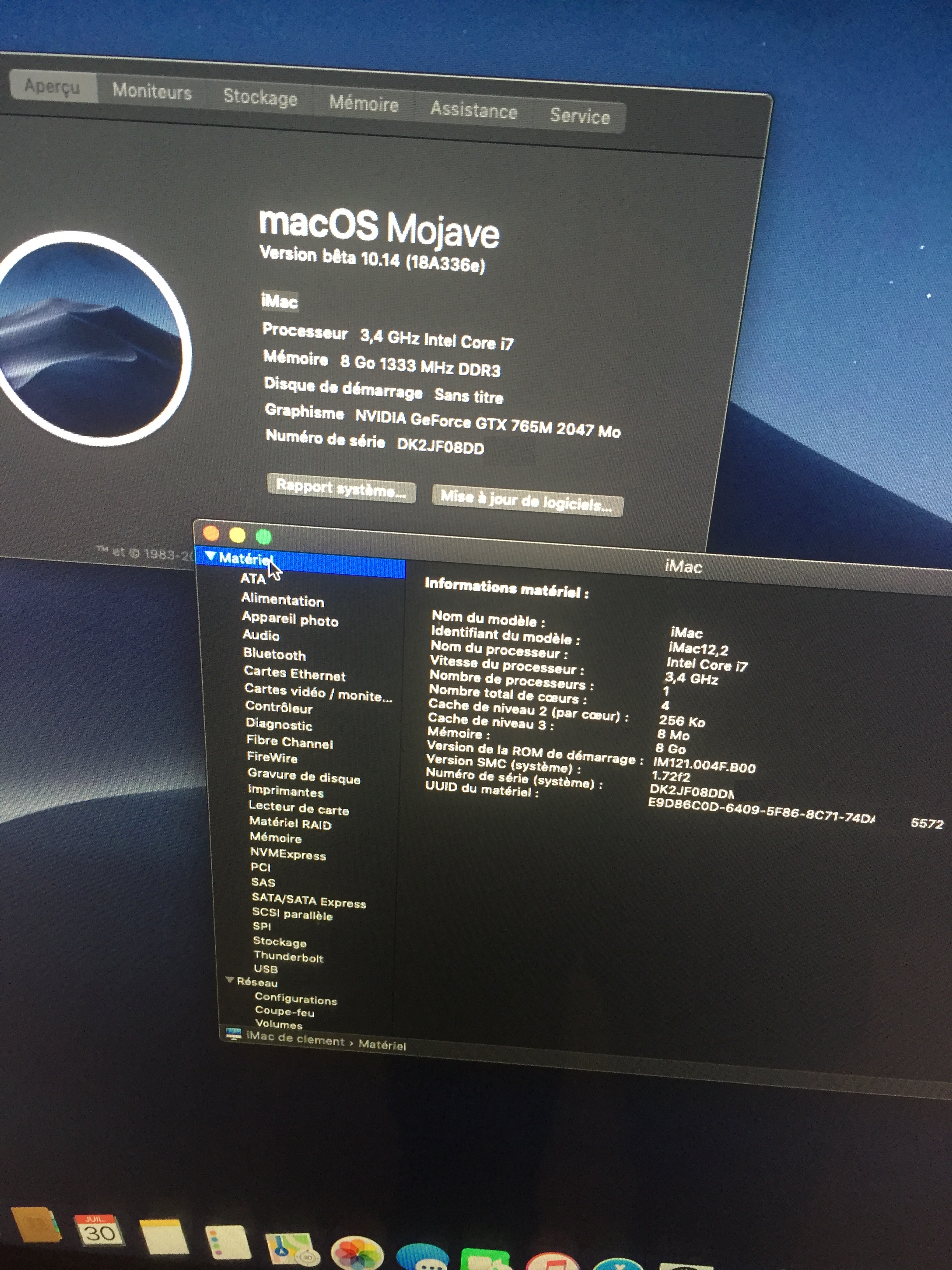

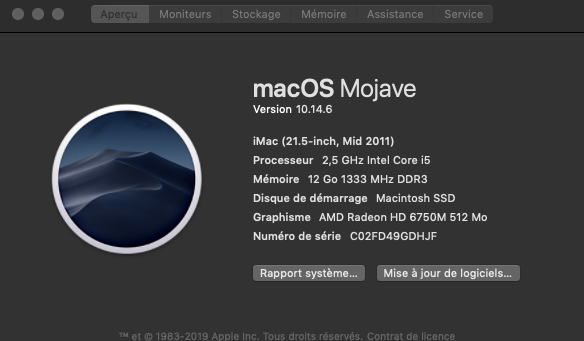

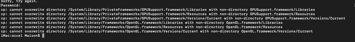

Hello,
I have a iMac mid-2011 with Mojave. It is cool but the video isn't good.
I try this but I have a problem.
Pictures : My Mac et the error.
Thanks.
Rereone
Hello,
Thanks.
Rereone
As the Mojave Patcher webpage states,
"AMD Radeon HD 5xxx/6xxx series GPU acceleration: Currently, it is not possible to get full graphics acceleration when running Mojave on a system with a Radeon HD 5xxx or 6xxx series GPU. Mojave will be almost UNUSABLE without graphics acceleration. This includes the 15" and 17" MacBook Pro systems (MacBookPro8,2 and 8,3). If you want to enable GPU acceleration on these machines, you'll need to disable the AMD GPU (This will work on MacBook Pro 8,2 and 8,3 systems ONLY. You CANNOT disable the AMD GPU in an iMac.) Weird colors will also be produced when running Mojave with one of these video cards installed/enabled. To disable the AMD GPU on a 2011 MacBook Pro 8,2 or 8,3, follow the guide found here."
You can fix the colors by running the following in Terminal, but you still cannot achieve graphics acceleration:
Code:
sudo rm -R /System/Library/Extensions/AMDRadeonX3000.kext
Reactions: roronl
Code:
Thanks.
I have colors.
