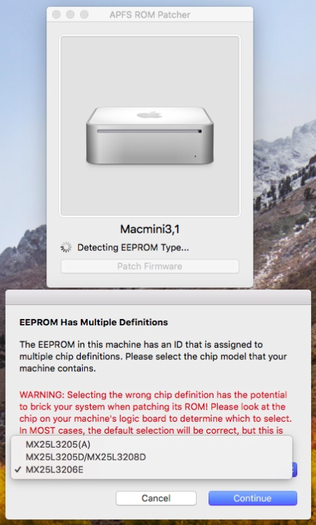

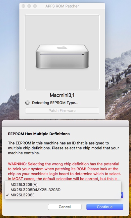

Hi all, I tried to install the APFS ROM patcher on a late 2009 2.53 Ghz Mini 3.1 and I got the multiple EEPROM chips warning:
These Minis aren't the easiest Macs to disassemble but I don't want to risk bricking it by choosing the wrong EEPROM chip.
Could anyone who successfully ran the patch on the same model please let me know which chip is the right one, assuming they are the same among same models? The chip auto selected by the patcher is the last one. Thanks for any help.
I've searched this thread but I haven't found an answer, though I found this post that is worrying me a bit.

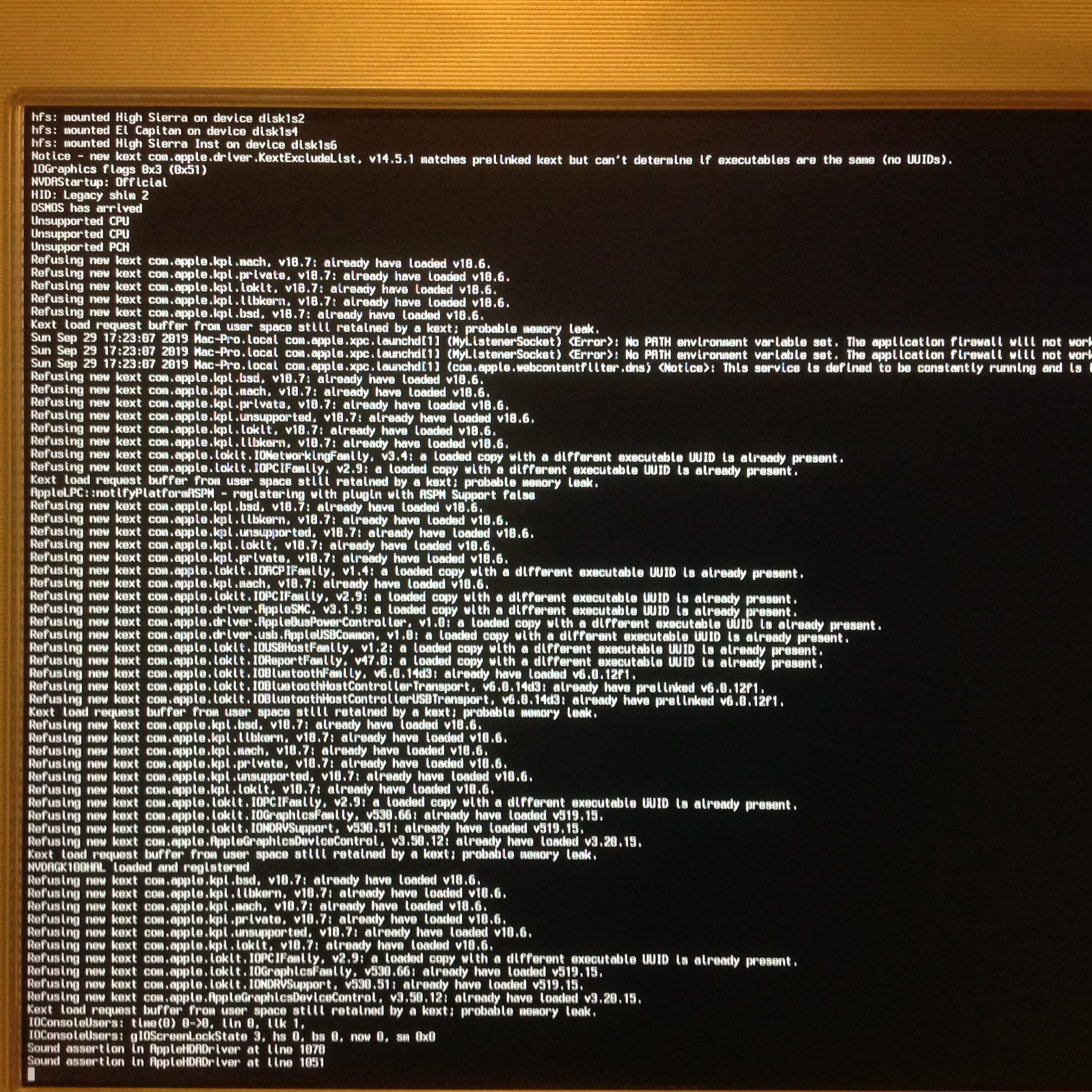

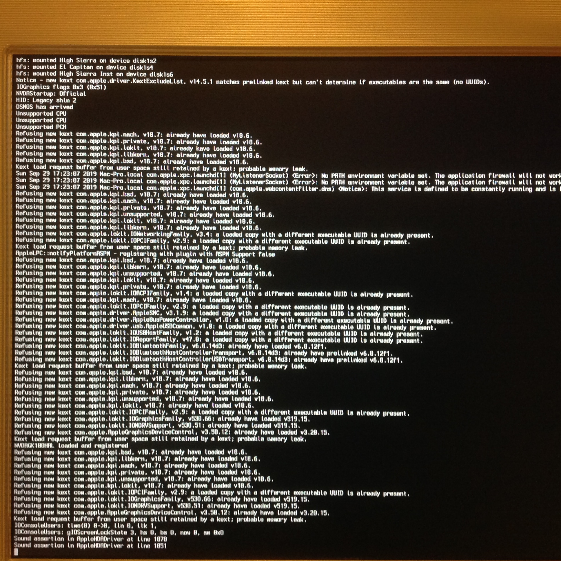

@dosdude1
Mac Pro 3.1 with Kepler GPU
Patcher 1.3.3
Doesnt get 10.14.6.00 to 14.6.06 to boot.
Downloaded Patcher and Mojave Install thru Patcher 1.3.3 today
Got stuck in the middle of the progress bar, verbose boot pic attached where it stucks. Looks like graphics kext got a memory leak.

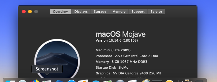

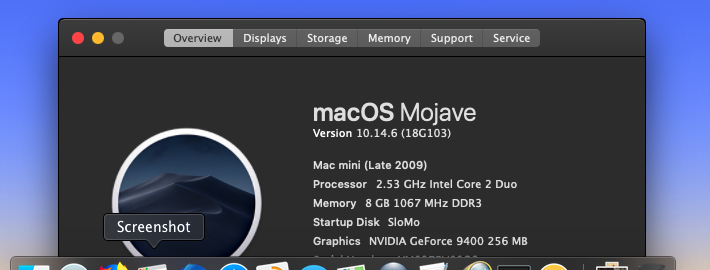

Hello all
here are the results of installing the supplemental update 2 (Version 10.14.6 (18G103)) using OTA. This has been similar to the installation of supplemental update 1. My machine rebooted without problem after the installation. After the first reboot (rather long time waiting) I had a message from Patch Updater asking to re-install:
  • Night Shift Patch
  • USBOHCI Support Patch
I thus re-installed these patches, and a new restart was required. After this second restart I still needed to have a USB mouse because Bluetooth was not working. I ran again Patch Updater asking to re-install all patches. After this third restart Bluetooth is back and so far all seems fine.
I have that model and just installed the latest Mojave update to the Mojave partition - This Mini runs Sierra and Mojave. Both partions are set up as MacOS Extended Journaled, HFS+. That way I don't have to deal with the issue you're having. Mojave runs fine for me without APSF.
FWIW, I had to reinstall the older Weather Widget parser file to get the Weather Widget working again, for those that use it.
Thanks for your reply. Using HFS+ is my plan B if I don't get enough confidence to run the APFS patcher, hopefully someone who did it successfully on a 2.53 Ghz Mini 3,1 will give me some. I've found another post of a bricked mini 3,1 and no successful ones but surely some people have done it.
BTW @dosdude1 if I brick it would this be enough to recover it without desoldering?
