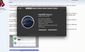

Have installed Mojave using the patcher (thanks for all the hard work!) and very happy how my Mac mini server (i7 2011) is running. Especially as I've swapped both HDD's with SSD's.
I have one rather big problem and so far not found any info on how to solve this.

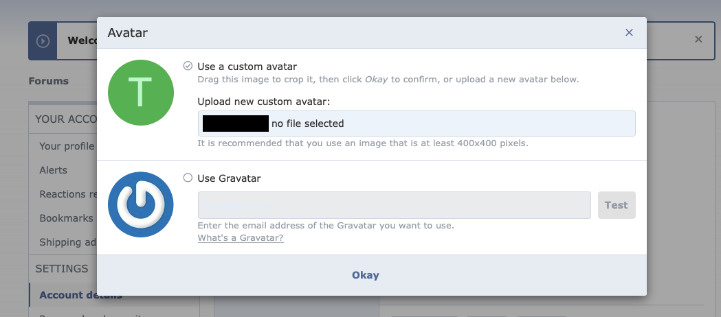

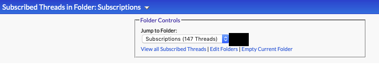

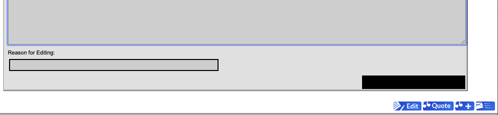

2. In Safari: I have seen a bunch of websites now that display random images as complete black, some interface buttons etc on forums and/or forms have a black overlay. Some examples attached.

[Edit].. never mind, found the problem. Turned out I had to calibrate my monitor. Duh!
