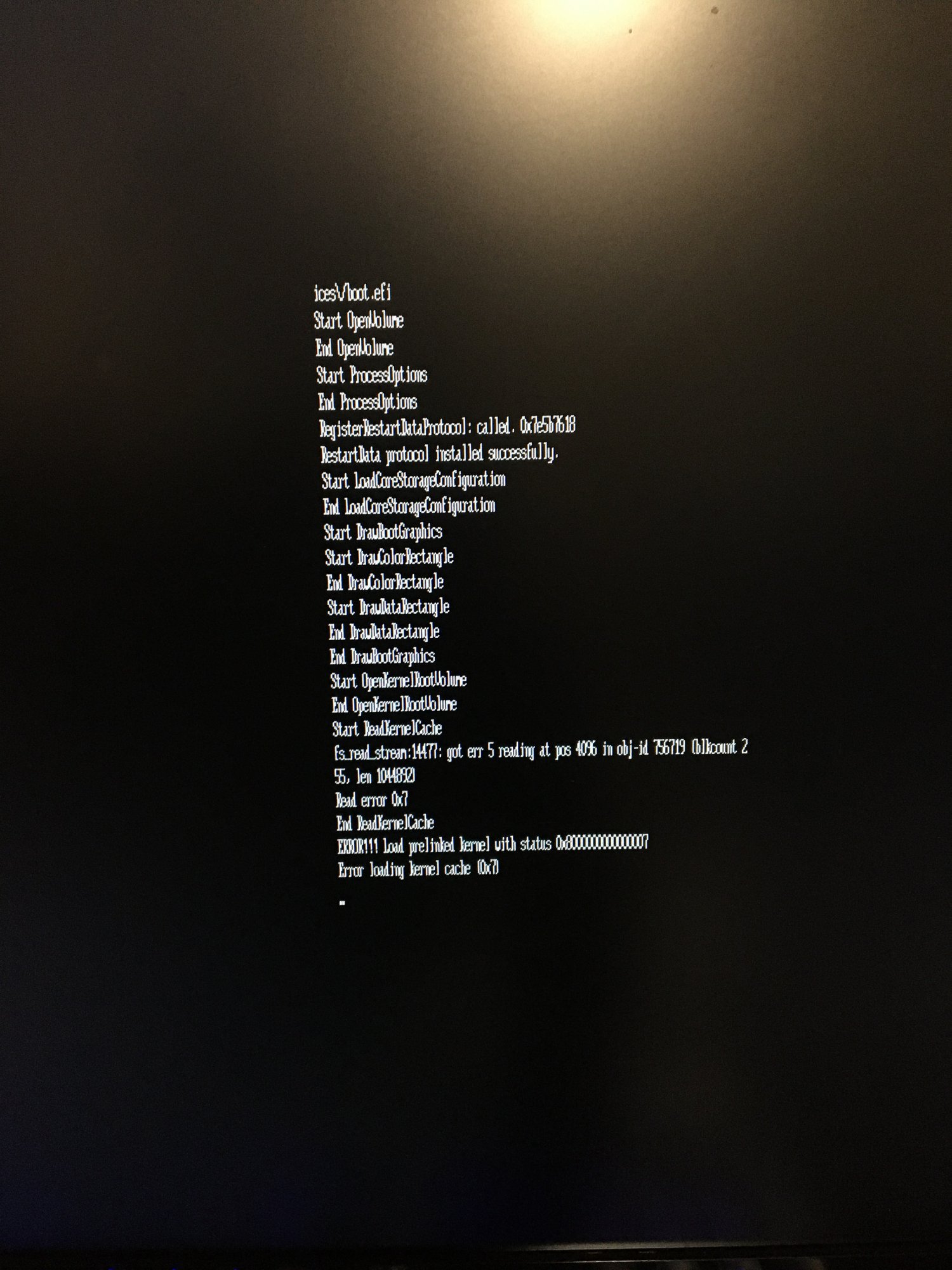

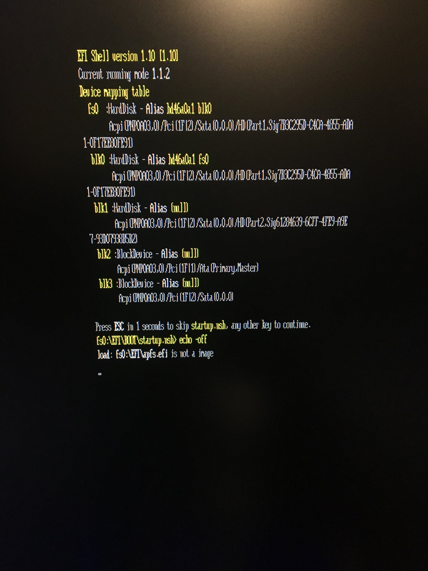

I'm having trouble getting Mojave (And also tried Catalina) to boot consistently. Maybe 1/12 boots will work correctly. I have a MacPro3,1. I've tried installing Catalina and Mojave both about a dozen times too no better results. When it fails, it doesn't always fail the same way. So far there have been 5 different failures:
2 failure errors are attached that have error messages
Boot to black screen
Boot to grey screen
Boot to apple logo - will eventually go to one of the error messages attached
I've tried running the post install scripts and forcing a cache rebuild.
I would love to hear any suggestions, I've been troubleshooting for about a week now.
Boot to grey screen
I'm far from an expert on the subject, but I'm thinking you might have a marginal or failing disk drive. I installed Mojave on my 3,1 and have not had any such problems. Did your machine run reliably with a supported operating system?
It seems your premise was correct, swapped in a different SSD and the problem disappeared. Thanks shirsch!
