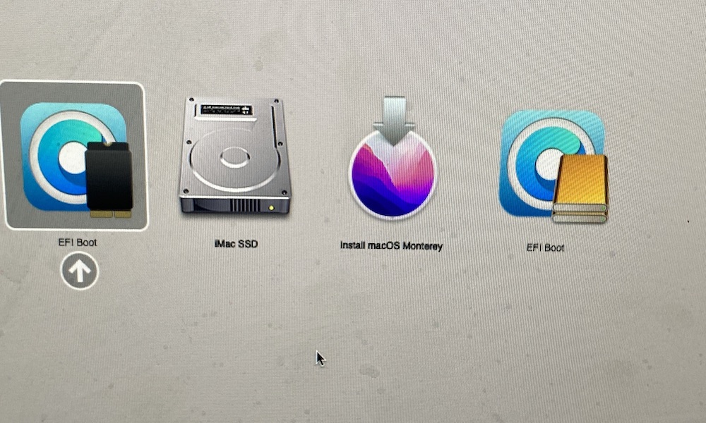

Interesting one here.. Currently running OCLP Big Sur 11.6.1 via OCLP 0.3.1 (originally patched with .0.2.4). Happy days.
I went through the process of downloading the release of Monterey, creating a USB and patching the USB with OCLP 0.3.1.
This image is what I get with I boot with the <opt> key.
If I select the leftmost EFI, SSD Boot. All Good.
If I boot with the rightmost EFI, I'd expect it to boot into the MacOS installer USB. Nope - SSD. :(
If I select the actual macOS installer, I get a 'forbidden' screen and have to hard reset.
What am I doing wrong? :) I'm so CLOSE!!

If you are planning to upgrade your system install OC only to the main internal SSD/HDD. Having two OCLP versions installed on different devices will not work well, mostly one interferes with the other cause settings still remain in NVRAM. Only a NVRAM/PRAM reset on OC change can help.
After selecting the OC EFI you should have another OC boot picker, it allows you to select installer or installation on SSD. Both versions should be able to boot the current installer, only the 0.3.1 will be able to complete the installer due to a new firmware check Apple introduced lately.

I rebuilt the USB Boot disk WITHOUT patching it and things all went as planned.
The only thing I had to do was post install the Metal Nvidia drivers for my Late 2012 iMac. Did that, rebooted. All good.
Thanks for your help :) Monterey 12.0.1 currently 100% effective.

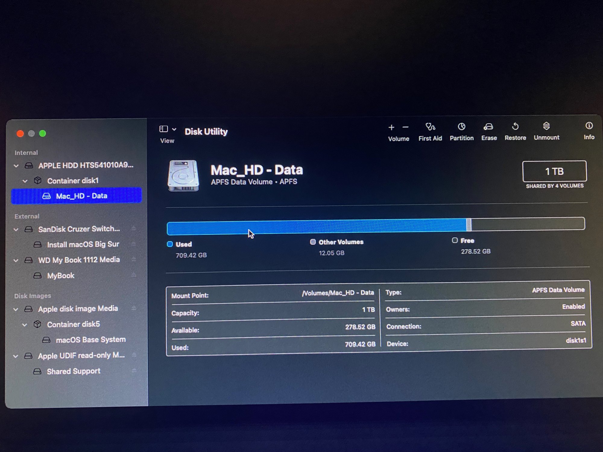

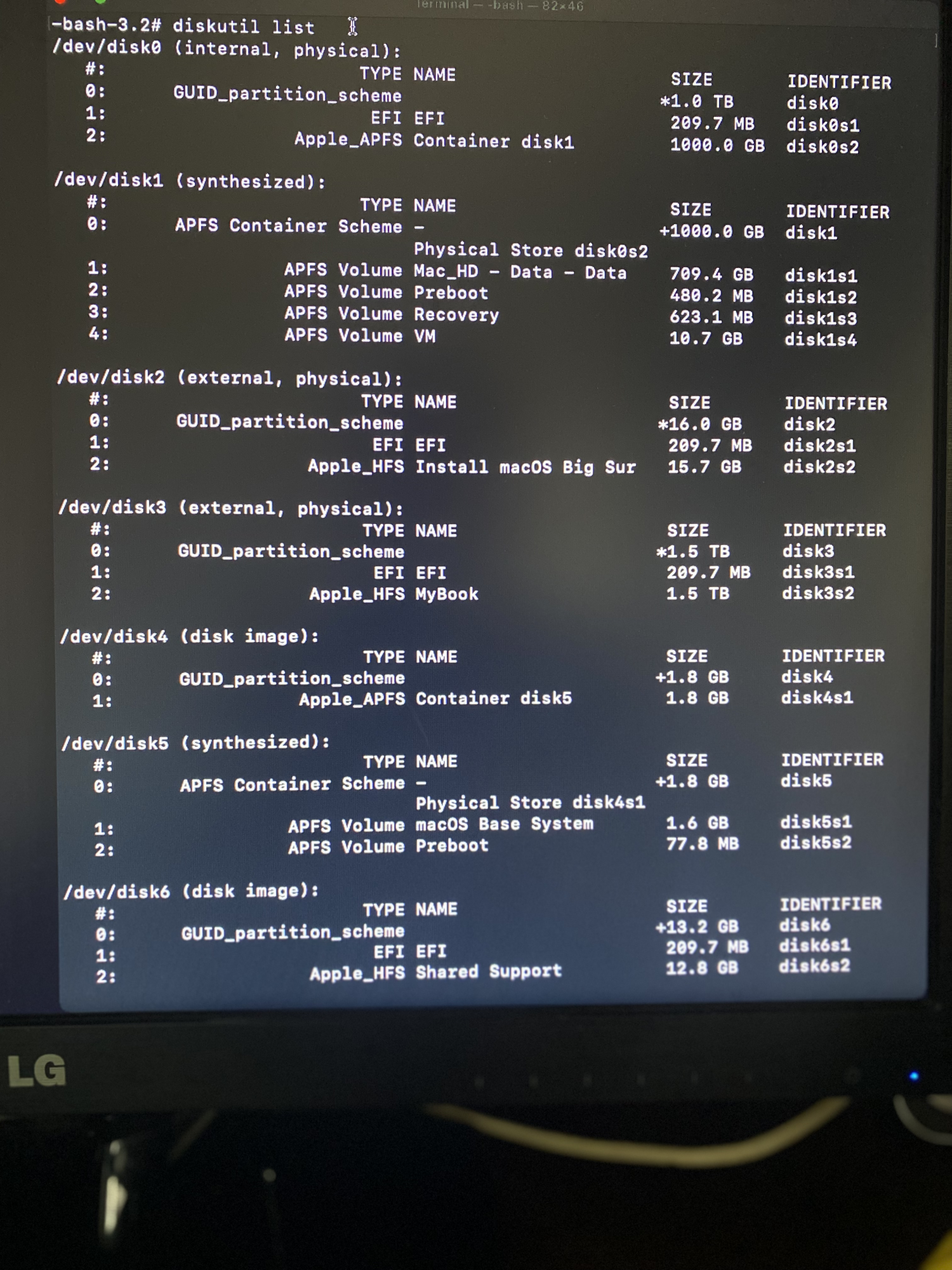

Trying to update from 11.6 to 11.6.1 using the Patched Sur GUI, after rebooting, the system crushed and promted me to use it in "Target mode" as Hard Disk. I reboted using the backup USB (11.6) in order to reinstall macOS but it can't find the Macintosh HD. From the Recovery menu I run the Disk Utility and the Container disk 1 on my HD has only one volume Macintosh HD - Data mounted. I run the First aid, the drive is OK, but Macintosh HD (with the system) does not exist. PLEASE HELP and sorry for my english!
Time to switch to OCLP by the sound of it. Patched Sur is no longer supported, from my understanding, please correct me anybody if I'm wrong. Consider switching to OCLP, then I can help.
And please, please make sure you have at least one backup (Time Machine and/or on an external drive).
My old MBP 5,1 (2008 late) is running OCLP 0.3.1 and 11.6.1 with no problem.
The Patched Sur is a MacMini6,2 (2012). I run in recovery mode (USB Installer 11.6 Patched Sur) from the terminal "diskutil list" and APFS Volume Mac_HD (My Big Sur Label) with identifier disk1s5 is missing. Unfortunately there is no Time Machine Backup. Instead Volume Mac_HD - Data exists, as Preboot, Recovery and VM.
My aim is to recover my data and clean install a OCLP system.
What version of Patched Sur are you using?
