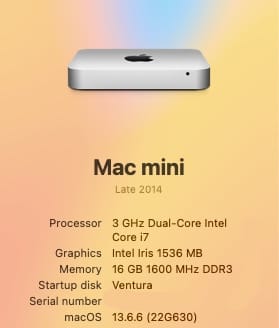

macOS 13.6.6 installed atop 13.6.5 OTA, OCLP v.1.4.3n runs as expected. :apple::cool:
1366.jpg An update via SilentKnight was also performed. ;)
