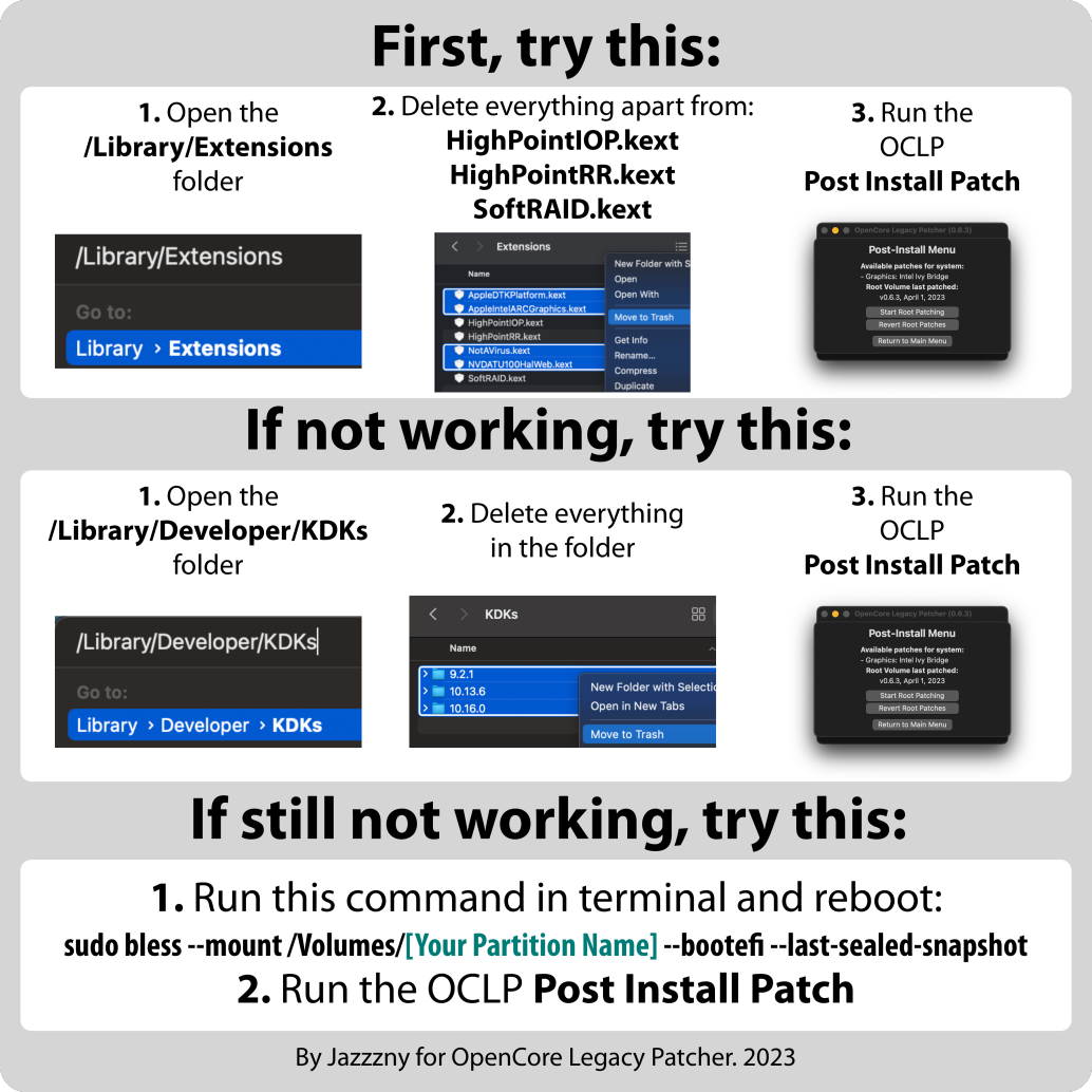

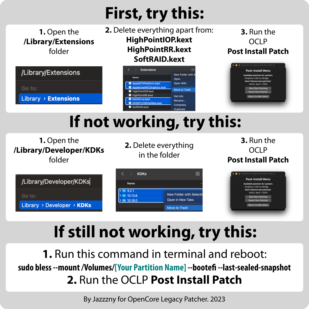

I have got a question please...
How do you Revert a system that has been patched if your system won't boot and or you can't get into Safe Mode to un-patch?
Thanks
P.S. I know you can just reinstall over the top but that takes a lot of time...
