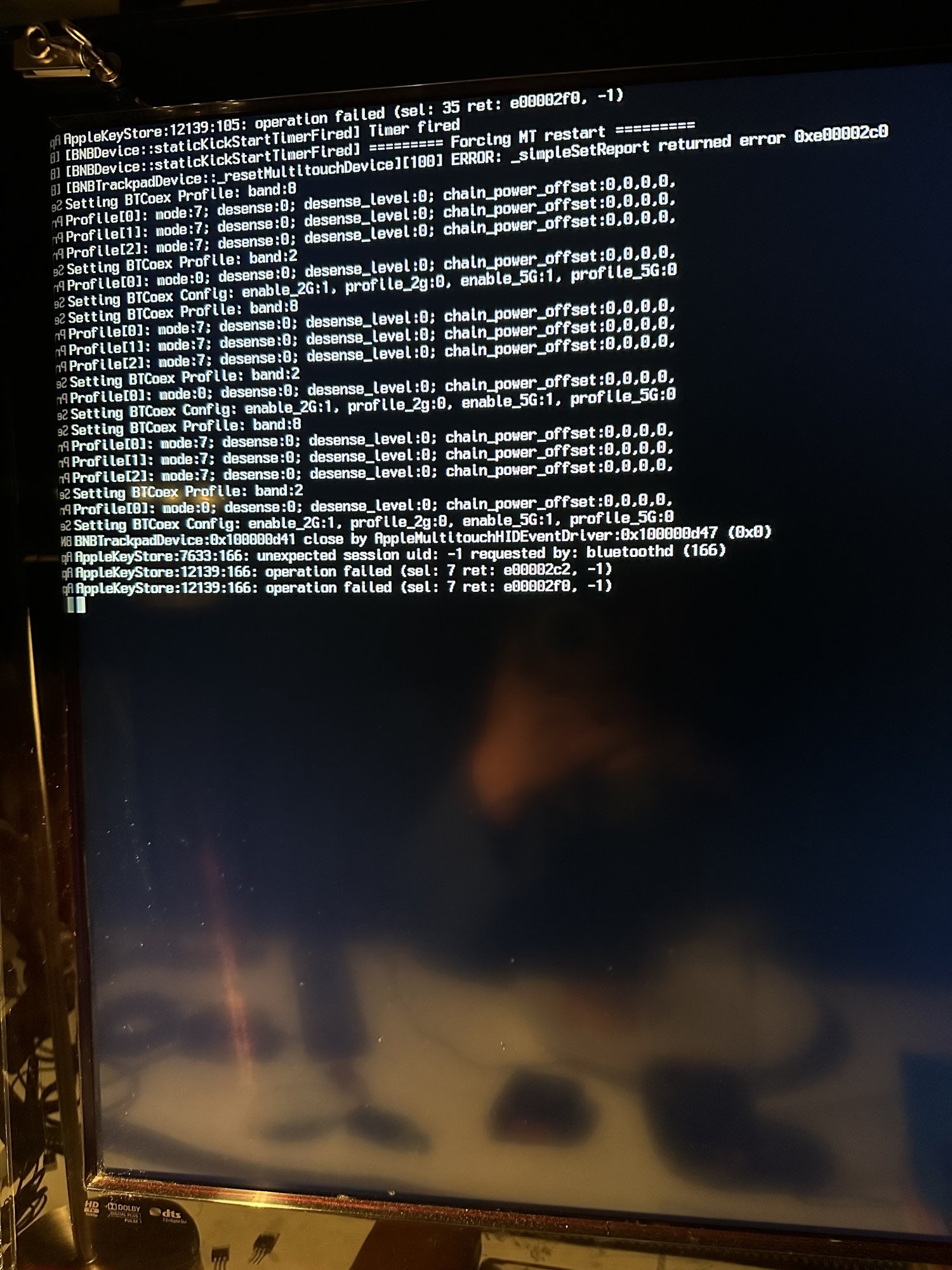

that's gonna be a challenge if there's not a working Mac to plug an new USB into - 14.1 and 14.2 are still throwing up lots of issues with the OCLP builds 1.1.0 and 1.2.0 (nightly) I've managed to get my 2016 15' MB Pro 13,3 working nicely with 14.1 beta (23B5067a) and I'm not even attempting an update during the current state of play. I've finally got a MacBook Pro 12,1 running 14.2 beta (23C5030f) but that was a nightmare journey of repeated USB builds of installer disk and multiple attempts to install, and one out of a dozen safe boot attempts that worked and suddenly it worked - still no idea what the magic sauce was but its running sweet now. Attempting for probably 10th time to update 2013 15" MacBook Pro but so far it hangs every time I attempt to log in - worked a treat on 14.0, but forgot to turn off the auto update of the OS and so it updated itself to 14.1 and broke itself. Now on a new USB build and we shall see if 14.2 and 1.2.0 might work from a fresh download of everything... progress bar 1/3rd along, cursor on screen and active, keyboard shift lock responsive so it's not died ye...t well there she goes - screen blanked - went to boot picker and restarted on the boot disk but 5-10% progress bar and temperature rising, fan noise and what looks like an unresponsive Mac - cannot get safe boot :/ bootefi-last-snapshot trick also not taking this now forwards..

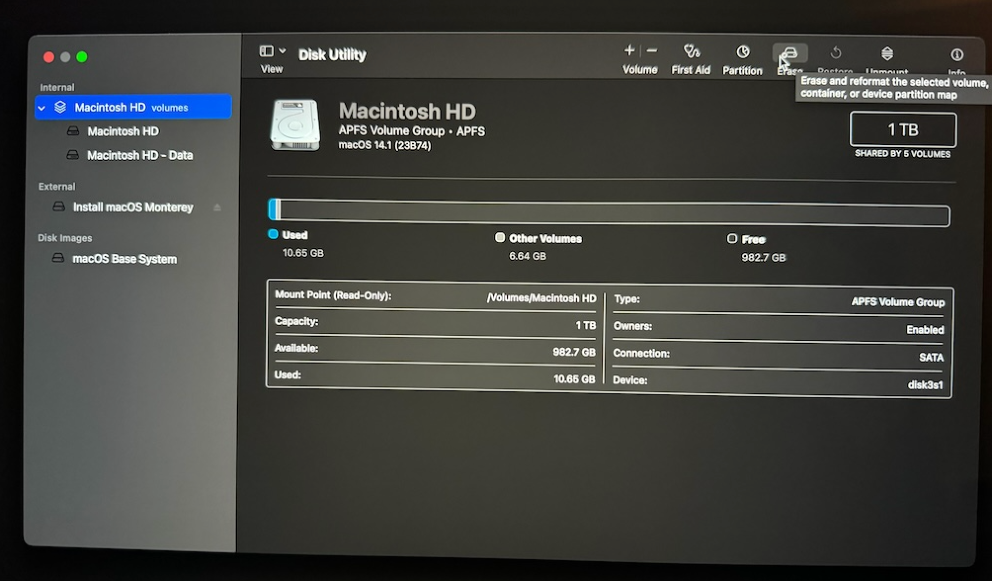

Just checking back in with more (bad) news. Still no luck getting Sonoma on my Mac Pro 5,1 even with OCLP 1.1 and 14.1 official built straight from the same machine running Monterey. I did several PRAM resets. I can get most of the way through the Sonoma install, even the second count-down black screen with xx minutes left. But it always ends up hanging 1/3rd of the way through the black screen/white Apple progress bar. Basically some of the very last steps hang at the same spot every time.
Monterey = works every time, very stable. I haven't tried Ventura.
After the failed Sonoma install, you can see in Recovery how it got most of the way there. I stuck a Monterey USB back in there, because I'm going to have to head on back to 12.7, unless you guys have other ideas?

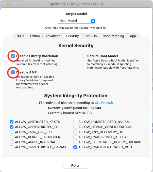

Please send me CONFIG.PLIST.
First, you tick these as shown in the screenshot. And check it out.
Just curious - why?
well if there are problems in the previous configuration that could have caused the failure to update or other problems in macOS, you could find them in the new update with critical consequences, possible malfunctions, etc...
