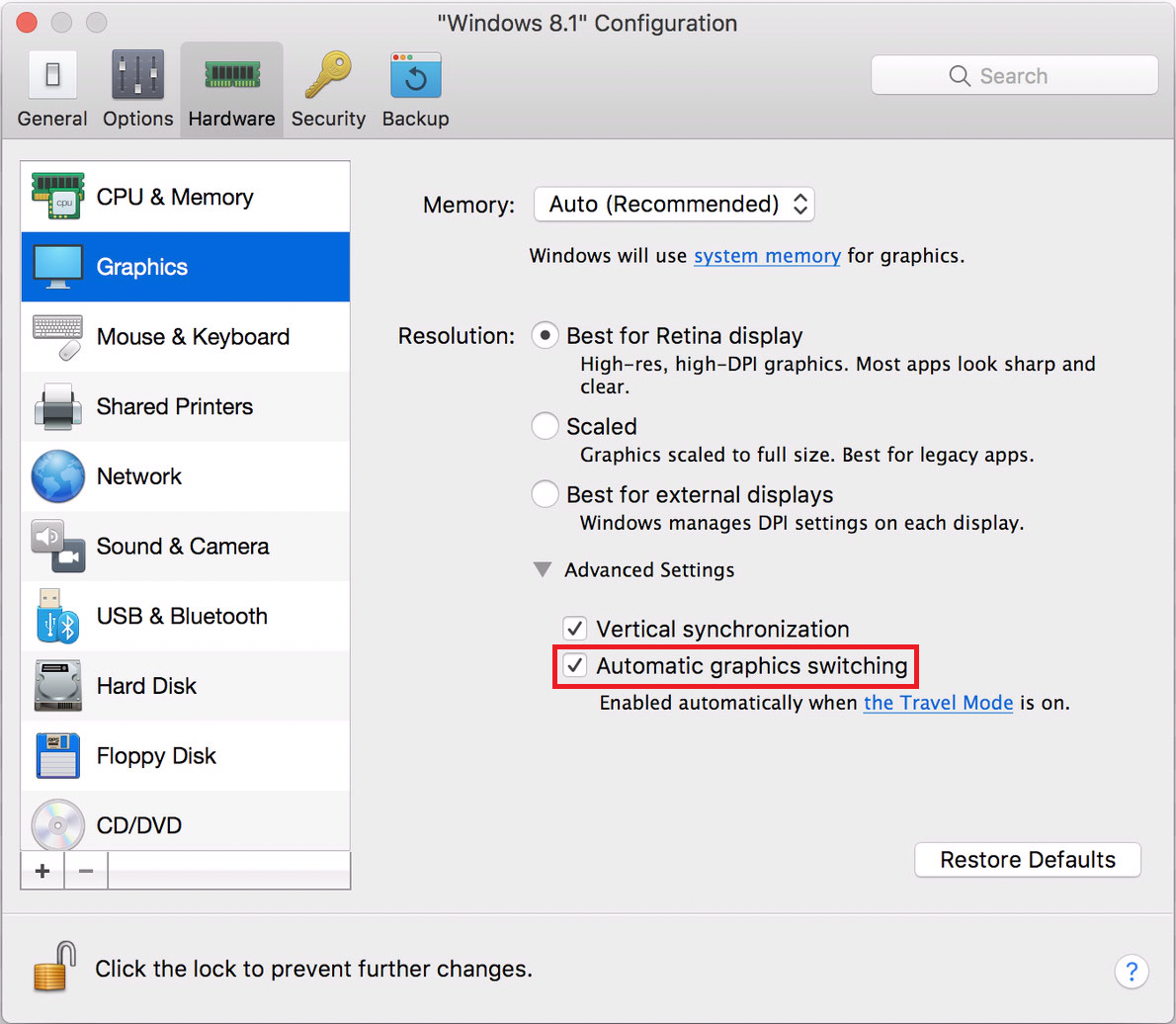

Still facing problems with Parallels on my MacBook Pro 11,5 from mid 2015. Using Sonoma 14.2 and Parallels 19.2.0
Has anybody had success with same Mac?
Icons are showing in Menus and dropdown, but without any text. Files on desktop are showing icons and text. Edge is black screen.
Was working fine in Ventura.

I still use Parallels 18 and have almost no issues. Sometimes menus are not accessible and hide behind the open application or info boxes open in the background and I first need to use Mission Control to see all open windows to select the info box. But I have a different machine.
Thank you for the reply. I suspect it has to do with drivers for the GPU´s, but I have not cracked it yet. Fall back is to reinstall Ventura and use my backup from Timemachine.

Possibly Parallels 19.2 and/or the Windows 11 graphics driver under the VM aren't handling the discrete graphics switching properly on the MBP 11,5. First thing I would check is the setting shown in this tech note.
EDIT - it looks like there have been some issues with the AMD driver under Windows 11. Most recent release was December 5th. Next thing I would try is a running Windows update in the VM and see if it finds a new driver from Microsoft. If not, then download the latest AMD driver from their site.
Thanks. I will try that.

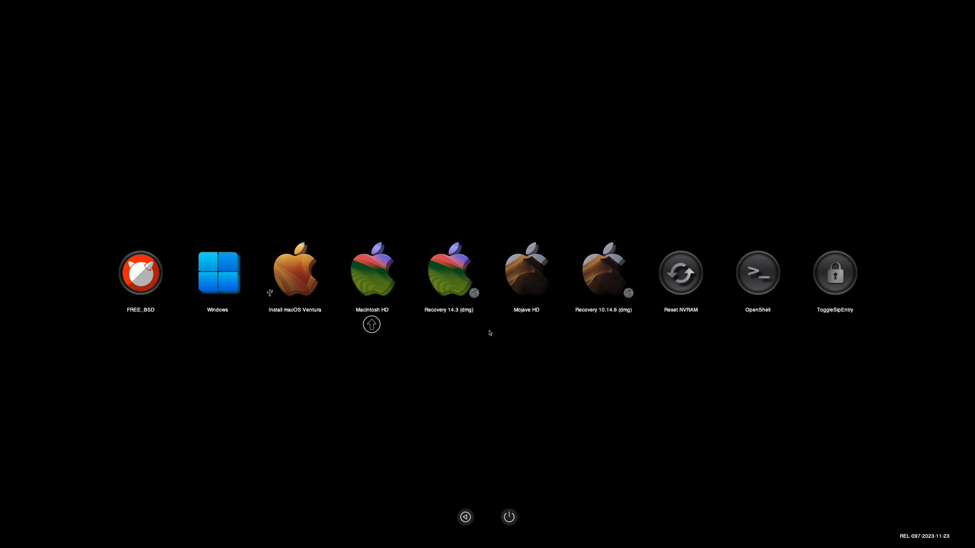

New Icon set Flavours-Apple3D for macOS Sonoma 14
Enjoy :D
Setup Flavours-Apple3D themes in config.plist ⬇︎​
  • Misc -> Boot -> HideAuxiliary: false
  • Misc -> Boot -> PickerVariant: chris1111\Flavours-Apple3D
  • Misc -> Boot -> PickerAtributes: 145
  • Misc -> Boot -> Picker Mode :-> External
  • Misc -> Boot -> Timeout -> : 5
  • Misc -> Boot -> ShowPicker: true
Attacing theme here
Edit 18 dec 2023
Correction Windows11_Alt1.icns icon for the Flavours-Apple3D theme
attaching the correct icon here
  • Flavours-Apple3D.zip
  • Windows11_Alt1.icns.zip

I have now tried all possible settings without luck. I retried installing Ventura on external SSD. Worked fine with Parallels and Windows 11. Then I updated Ventura to Sonoma 14.2 which involved download of new KDK 14.2. I suspect something is wrong with this KDK, but I am not smart enough to figure out what. Have to wait to see if the OCLP team will solve it? Thanks anyhow for your comments.
