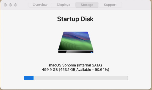

That's my question...
Did you try to open it again ? The first time I also had nothing displayed (monitor, storage), maybe it took some time to gather the info or just to display it, but now it shows. So maybe it's just about waiting a bit as the app is probably not very optimized.
I would suggest you post on the OCLP Discord where the developers are active.
Thanks for replying, but I'm hoping someone can confirm this is expected/common behaviour or not - don't want to waste time on OCLP Discord server if it's not already identified as a common issue with cMP users. If there are others without this issue, I can start to problem solve with them first.
I suggested the Discord because I never had those issues either with a RX580 or a Vega 56 nor did I see anyone have those issues.
Like you said, there is no display first time, now it shows, but until now there is no storage evne I open it a lot of times.

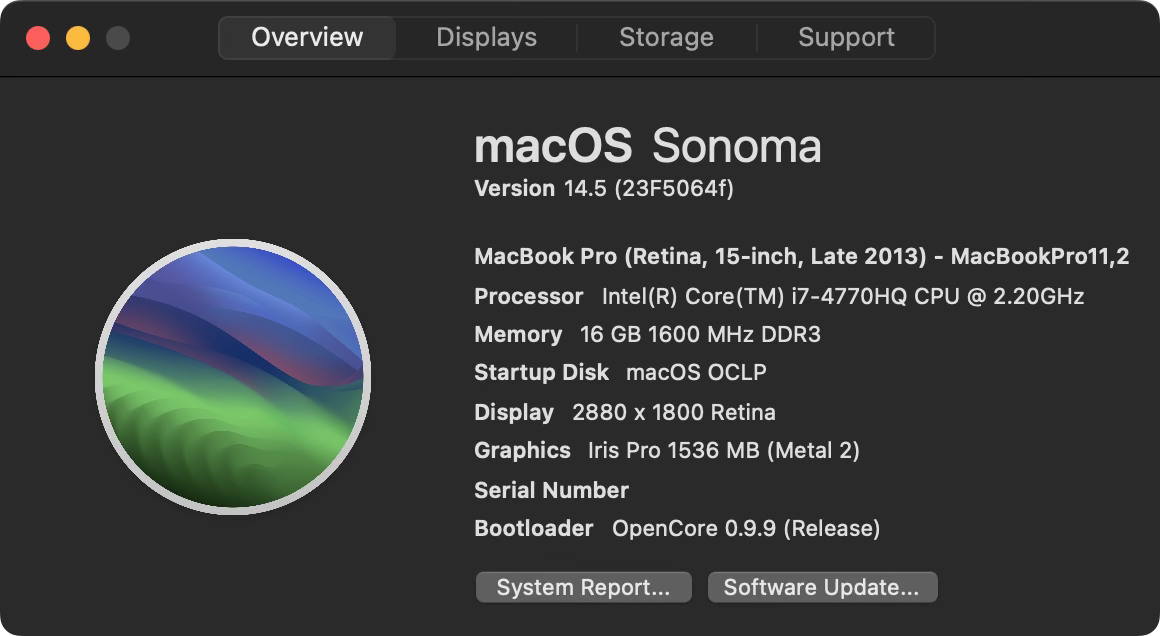

Short story: OTA macOS 14.5 bp3 (23F5064f) then "Post-Install Root Patch" (OCLP 1.5.0n) – good so far, will update if having issues
