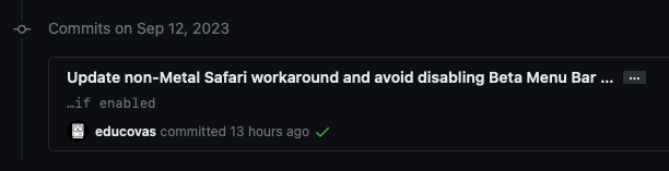

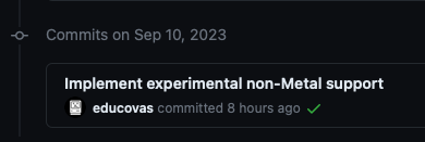

The Sonoma branch of OCLP has been updated; dated 9-10-23.
The Regular Ventura, etc. branch has been updated too, dated 9-9-23, although the date and info on the page is still not up to date, which should follow in good time.
Am I reading correctly that the change is the addition of experimental non-metal support?
I downloaded and built the latest Sonoma-development branch (I built it myself since I wasn't sure if the pre-built nightly build contained the non-metal changes). I am running Sonoma 14.0 Beta 7 and posting this in Safari over Wi-Fi on my MBP6,2 (non-metal NVidia Tesla). Well done, Devs!

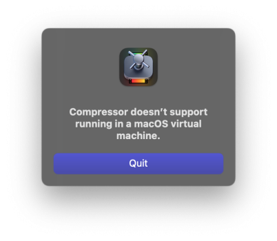

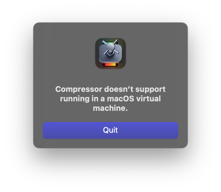

Had almost forgotten about this glitch, but it is fixed in the latest OCLP 0.6.9 for Sonoma developer beta, and Compressor now works correctly, without giving this error message:

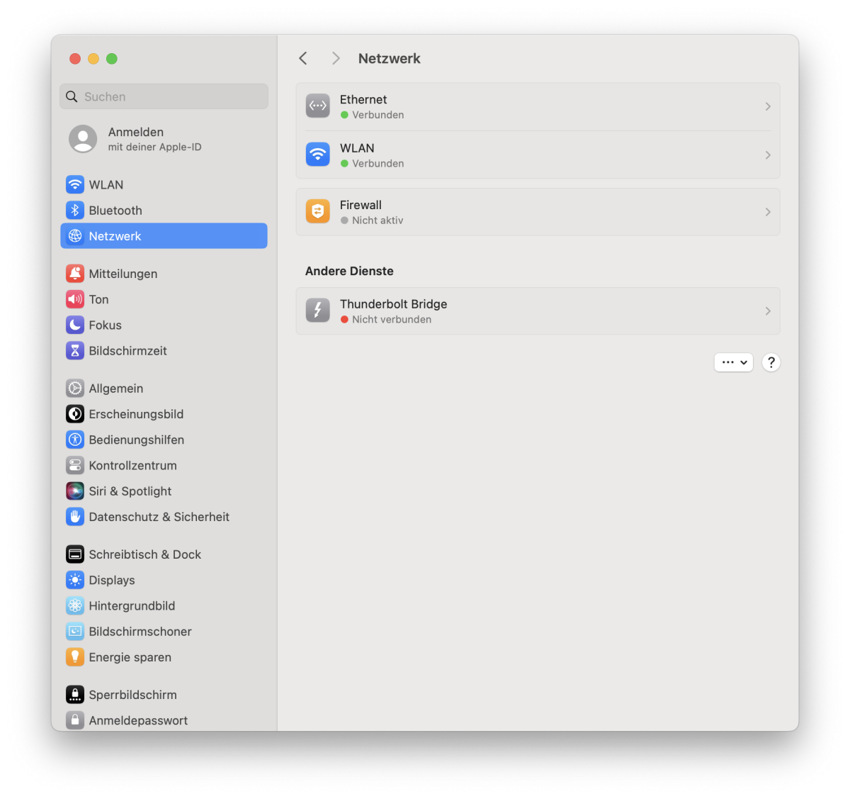

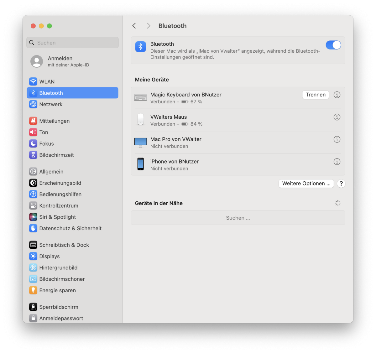

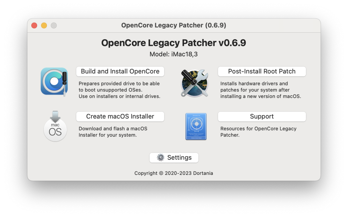

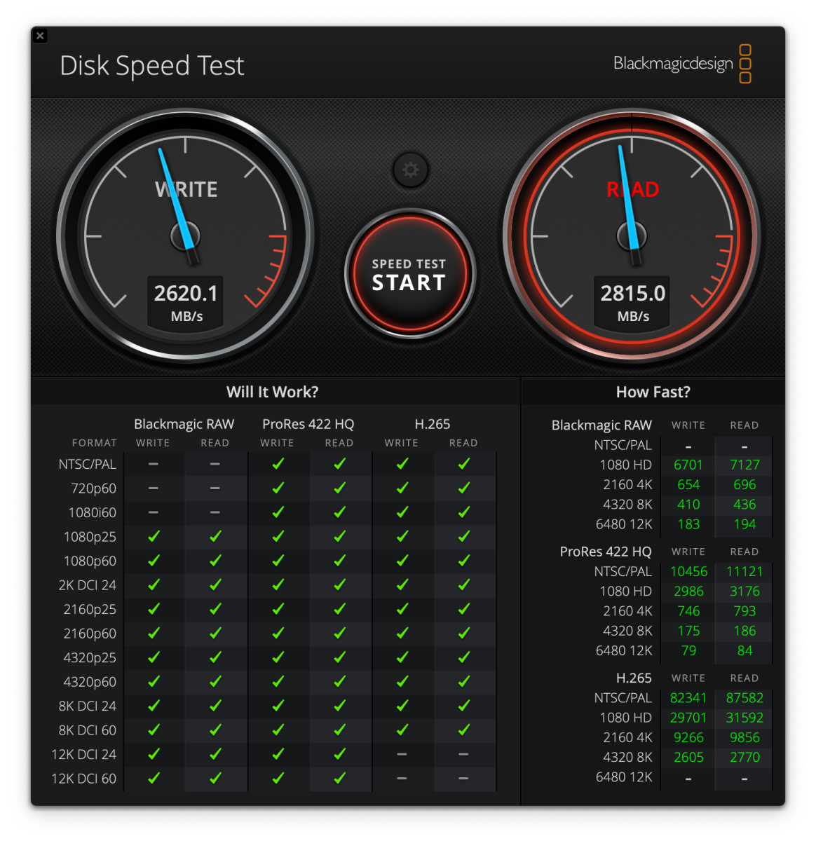

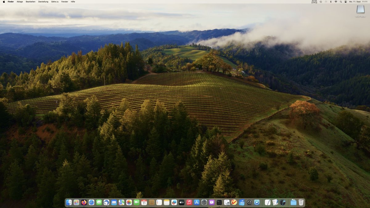

The current status of my iMac 18.3 @ sonoma is as follows:
As far as I can tell, everything works and you can't call it "lame".
In this respect, it is definitely a device for 2023 and longer and you don't have to worry about the "loss" of security updates. This will work for quite a long time. ;)

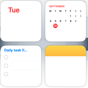

Out of curiosity, not a problem, but perhaps someone has a quick fix for this one:
Most widgets on this MBP show as completely blank. This is one exists since Ventura. Issue can be reproduced in freshly installed system and a new user, in both light and dark mode. Maybe it's unique to this MacBook 9,2?
No, I have a MacBookAir7,2 I've had the same issue since Ventura.
I have a 9,2 and can confirm all widgets are blank. OCLP 0.6.9. Mac OS Sonoma beta 7.
On my MacBook, trying to edit widgets results in never ending beachball and hang. Requires a restart.
