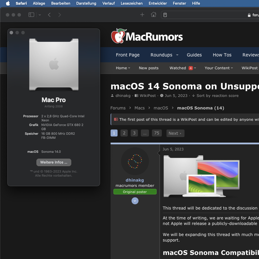

I'm officially on Sonoma - with a 15-year-old machine, which is insane! 😱😀👍
Thanks for report on success with cMP3,1. Two questions: 1. Do you have the reboot bug causing a reboot about 30 seconds after soft shutdown? 2. Does the Fenvi T919 AIC require a cable from the AIC to the BT connector on the cMP 3,1 motherboard for BT functionality?

Thanks for report on success with cMP3,1. Two questions: 1. Do you have the reboot bug causing a reboot about 30 seconds after soft shutdown? 2. Does the Fenvi T919 AIC require a cable from the card to the BT conector on the cMP 3,1 motherboard for BT functionality?
I was hoping that someone with your config would answer. Since I don't see a response, I'll take a harmless guess. I have seen in hackintosh forums that your Fenvi Bluetooth does require a cable to an internal USB port. No guarantees that the same is true for your Mac, but I think it is a reasonable assumption.

Thanks for your input deeveedee; I don't have a Fenvi card but am considering buying one and need to know if I need this cable too, but which goes not to a USB port but to the connector on the motherboard for the old (removed) standalone BT card.
