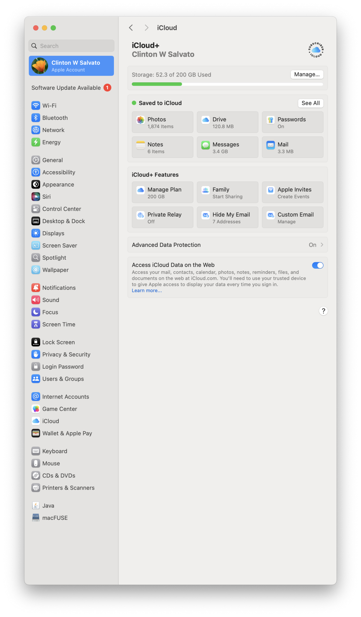

Just out of curiosity, does Advanced Data Protection work on patched macs? I have all compatible devices, so it should turn on in all respects, but I haven't tried it, in case there were any known issues.
I was able to turn on Advanced Data Protection, after setting up a recovery key. Everything seems to be working as it should. The changes are also reflected on the iPhone, does this carry over to Apple TV as well?
