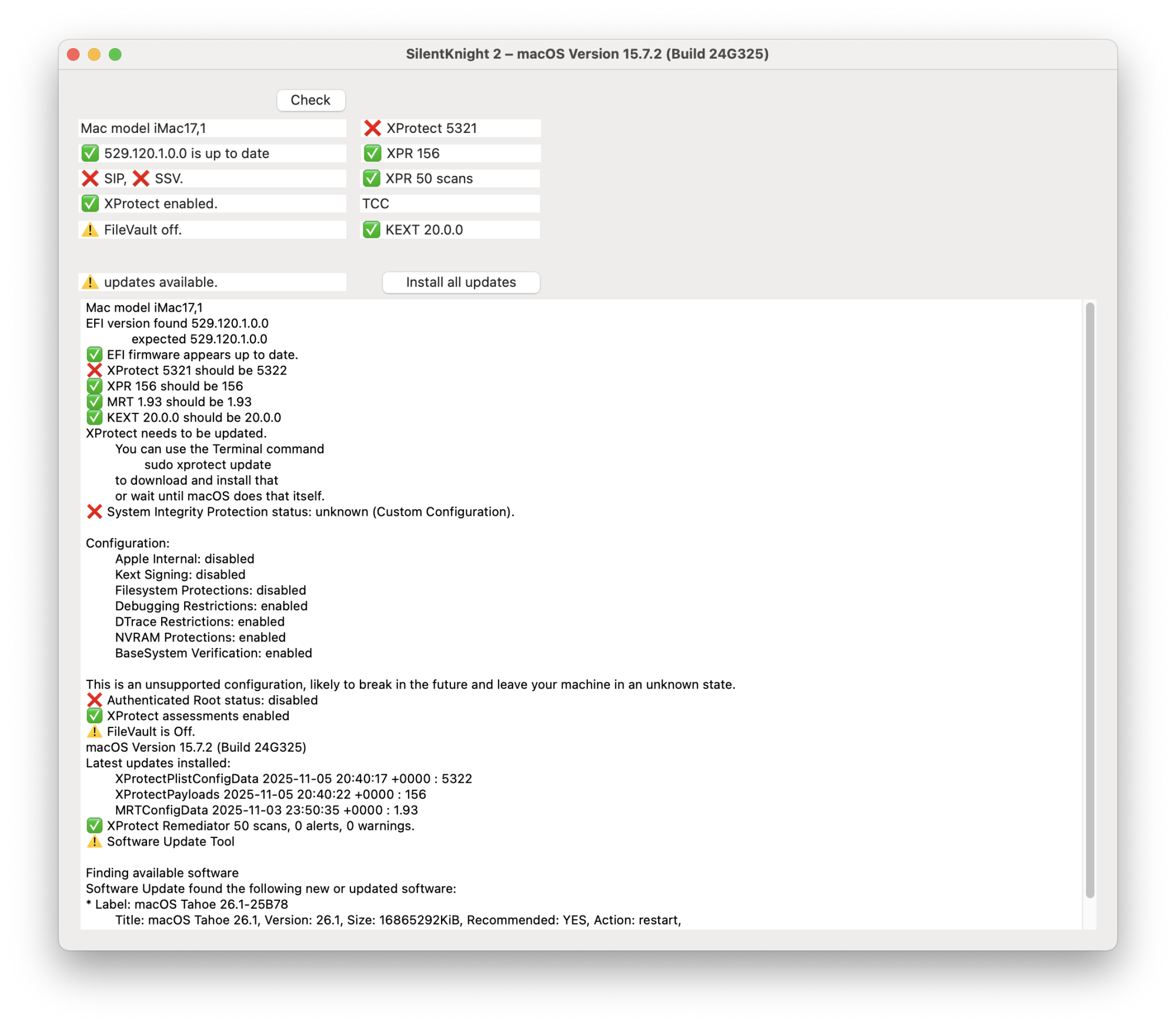

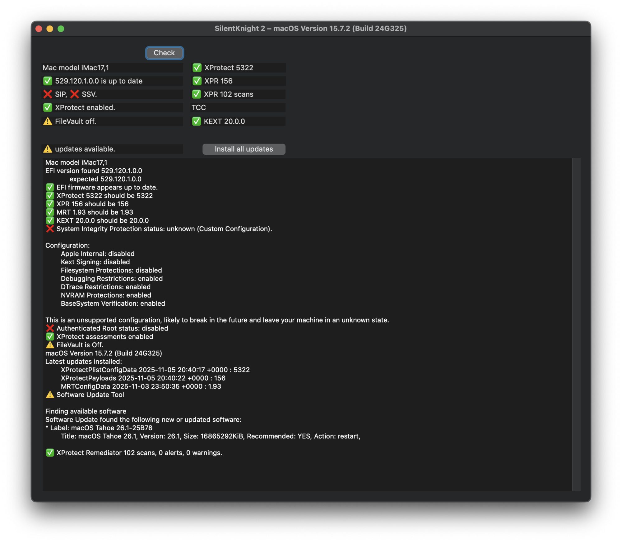

Is Xprotect having more issues? It showed out of date last night, and the terminal commands said it was up to date. So, I gave it overnight until today, and it still says up to date in terminal, but Silent Knight is still saying it's not up to date. Running sudo Xprotect update in terminal still doesn't install any updates. Usually the terminal command fixes it, and usually waiting a day, also fixes it.
Edit: I checked this morning, and XProtect finally updated itself, so everything is green now. It was just really strange the manual update didn't do anything, it usually does when Silent Knight reports it's out of date.
