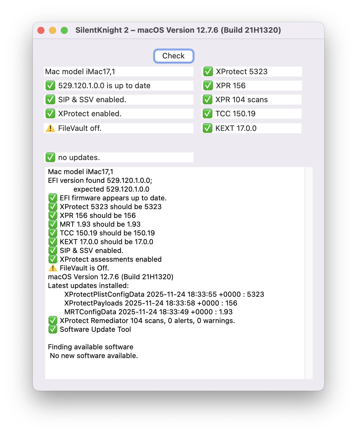

Well, Silent Knight has given it's blessing that my setup is functioning as it should, and everything is normal. I'm no longer going to use OCLP. After re-evaluating my needs. I don't need it. Everything I use works on a supported install. I used Mist to create an ISO of Sonoma, and Ventura to put in VM(s), for the few things might need a newer version for eventually. It's been an interesting learning experience, but to be honest, I think my setup tends to be too specific to fit into this community anymore and instead of frustrating myself, and everyone else, I'm going to just use what works regardless of what other people say, or try to fit into a community, when it's not me.

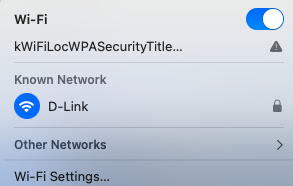

Why is this happening suddenly?

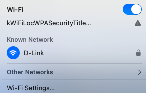

Why is it saying kWiFiLocWPASecurityTitle?! My house had a problem with Wi-Fi today so we had to get it sorted. Could that be the problem?
It's trying to tell you that you're using an insecure version of WPA (v1) but due to the WiFi patches (I think?) there's a bug with localization strings. Configure your router to use WPA2 or newer to get rid of it.

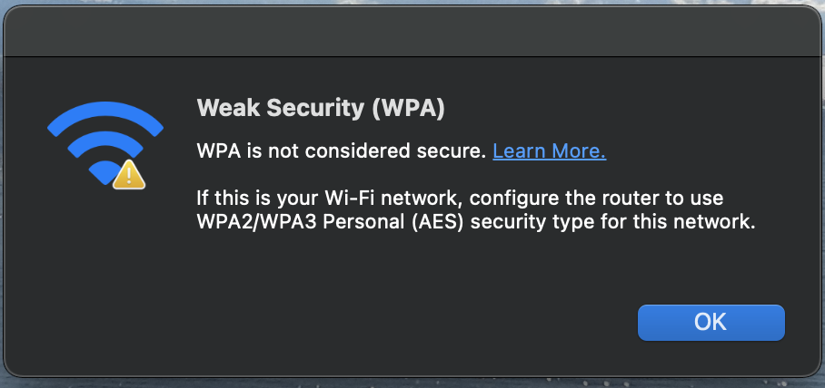

Here's the proper dialog of what it's trying to tell you:
weak security (WPA) - Apple Community
