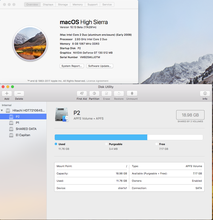

*********** UPDATED 6th July ***********
Apply APFS post installation
1. Make 2 Partitions and install dosdudes patched High Sierra Public Beta
I Called them P1 & P2
Boot into P1
Last login: Thu Jul 6 00:16:32 on console
Toms-iMac:~ tom$ diskutil list
/dev/disk0 (internal, physical):
#: TYPE NAME SIZE IDENTIFIER
0: GUID_partition_scheme *640.1 GB disk0
1: EFI EFI 209.7 MB disk0s1
2: Apple_HFS P1 30.4 GB disk0s2
3: Apple_Boot Recovery HD 650.0 MB disk0s3
4: Apple_HFS P2 19.0 GB disk0s4
5: Apple_Boot Recovery HD 650.0 MB disk0s5
6: Apple_HFS SHARED DATA 410.4 GB disk0s6
7: Apple_HFS El Capitan 178.1 GB disk0s7
8: Apple_Boot Recovery HD 650.0 MB disk0s8
Toms-iMac:~ tom$ sudo diskutil cs convert /Volumes/P2
Password:
Started CoreStorage operation on disk0s4 P2
Resizing disk to fit Core Storage headers
Creating Core Storage Logical Volume Group
Reviewing boot support loaders
Attempting to unmount disk0s4
Switching disk0s4 to Core Storage
Waiting for Logical Volume to appear
Mounting Logical Volume
Core Storage LVG UUID: B2F6CD2B-75D8-4721-B73E-12D0B3B3D202
Core Storage PV UUID: 993503AE-B4BF-4000-80CA-F4E83ED422A5
Core Storage LV UUID: 8DE6146D-24B6-4C65-A6CF-FD3004455423
Core Storage disk: disk1
Finished CoreStorage operation on disk0s4 P2
4: Apple_CoreStorage P2 19.0 GB disk0s4
/dev/disk1 (internal, virtual):
0: Apple_HFS P2 +18.6 GB disk1
Logical Volume on disk0s4
Unencrypted
Toms-iMac:~ tom$ diskutil cs list
CoreStorage logical volume groups (1 found)
+-- Logical Volume Group B2F6CD2B-75D8-4721-B73E-12D0B3B3D202
Status: Online
Size: 18978709504 B (19.0 GB)
Free Space: 18882560 B (18.9 MB)
+-< Physical Volume 993503AE-B4BF-4000-80CA-F4E83ED422A5
| Index: 0
| Disk: disk0s4
| Status: Online
+-> Logical Volume Family 105E5247-989B-43C9-8283-017048496797
Encryption Type: None
+-> Logical Volume 8DE6146D-24B6-4C65-A6CF-FD3004455423
Disk: disk1
Status: Online
Size (Total): 18607505408 B (18.6 GB)
Revertible: Yes (no decryption required)
LV Name: P2
Volume Name: P2
Content Hint: Apple_HFS
4: Apple_APFS Container disk1 19.0 GB disk0s4
/dev/disk1 (synthesized):
0: APFS Container Scheme - +19.0 GB disk1
Physical Store disk0s4
1: APFS Volume P2 11.8 GB disk1s1
From DISK UTILITY go to EDIT/CONVERT to APFS choose P2
Toms-iMac:~ tom$ sudo nvram boot-args="rd=disk0s4"
Toms-iMac:~ tom$
OK - after doing this it didn’t work wouldn’t boot into P2
Then I reset the NVRAM :
Shut down your Mac, then turn it on and immediately hold down these four keys together: Option, Command, P, and R. Keep holding the keys for about 20 seconds, during which your Mac might appear to restart. (If you have a Mac that plays a startup sound when you turn it on, you can release the keys after the second startup sound.)
That appeared not to work
Then I Booted into P1 - Fine Boot but its HFS so expected
Restarted Again
Booted into P2
P2 Booted ????????? Don’t know why but it did.
Then I get this as output from diskutil list within P2
Last login: Thu Jul 6 15:52:23 on console
1: APFS Volume P2 11.6 GB disk1s1
2: APFS Volume VM 20.5 KB disk1s2
Toms-iMac:~ tom$
Reference: http://enterprisemac.bruienne.com/2017-02-27-apfs-boot-quickpost/
Reactions: TimothyR734

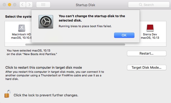

Tried to boot to High Sierra APFS disk, still the same error.
So converted to Core Storage, successful, converted to APFS successful.
Please show screenshot of
Diskutil list and
diskutil CS list

Are you on High Sierra public beta
Repair the disk permissions
turn off mac completely
Turn On
The problem seems to lie in the BLESS
open Terminal and enter "man bless" and you'll get the manual for the command
Ok, my first post and thanks to dosdude1 for his patch.
1. Make 2 Partitions and install dosdudes patched High Sierra or Sierra on Both
2. Prepare for APFS conversion
Although the volume you’re working with (I’d recommend using a VM) is already HFS+ formatted, you do need to make sure it is also part of a valid CoreStorage (CS) LVM group. A quick way to determine that is by using diskutil list from the Terminal (all of the conversion process will be done in the Terminal):

3. Boot into either then run DISK UTILITY
4. From DISK UTILITY go to EDIT/CONVERT to APFS choose the other installation and convert to apfs.
screen-shot-2017-07-03-at-4-41-01-am-png.706978
screen-shot-2017-07-03-at-4-41-23-am-png.706979
screen-shot-2017-07-03-at-4-41-41-am-png.706980
That makes no sense at all. You can't magically boot a converted APFS partition on an unsupported Mac, the support in firmware simply isn't there by default.
Additionally, the part of the instructions you posted were ripped from Pepijn Bruienne's article, which is noted to be the incorrect method.
[doublepost=1499110769][/doublepost]I followed the instructions from http://enterprisemac.bruienne.com/2017-02-27-apfs-boot-quickpost/
but couldn't then carry on as i was running high sierra from the drive I was trying to convert.
So I split the partitioned HS driive and installed another copy of HS then booted to that drive and converted the original installation to APFS.
It boots from the Drive Directly when i reboot see pic
It worked - Im only sharing what I did because it worked.

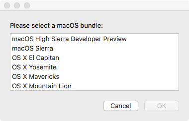

FetchMacOS v1.0
An utility to download macOS directly from Apple. It does not require an Apple ID and works on unsupported Macs and PCs.
http://swdist.furcode.co/bin/FetchMacOS-1.1.zip
SHA1 = 1d7e636342dd73ea2b611c7021eb3f286361bb95
FAQ
What can I download with this?
You can download macOS High Sierra developer and public beta builds, in installer format, only as they become available. It does not use third-party servers.
Can I get earlier versions of macOS (Sierra, El Capitan, etc)?
No. If you'd like to do that, you can use DownloadMacOS (after purchasing the related macOS version).
Does it work with unsupported Mac patchers?
Yes and no. It works with newCore v0.1/v0.2, and will be integrated in v0.3. It does not work with dosdude1's patcher, as that only accepts application bundles.
Can I use it on other operating systems?
Yes, partially. It works on Linux, but only in compressed format (you'll have to move the downloaded data to a Mac to extract it). Same goes for Windows.
I can confirm that @Opusden's method effectively doesn't work, tried it my self... I tested it with little faith, but I tried it anyway...
Booting via small HFS partition with com.apple.boot.S is not an option? Booting from non standard devices (core storage devices, old software raids) boots this way. I don't see anything that prevent booting via Apple_Boot/Boot OS X partition. I can boot single user mode from APFS with this method. (why single user? Because i create only a very small APFS to test the boot only, currently i don't want to use APFS anywhere on my macs for years)
You can boot with a helper partition, but it's incorrect in the sense that it isn't the native way of booting from an APFS disk. For example, you'll have to update the kernel and boot files on the helper partition on every update manually.

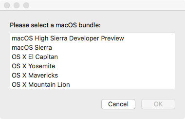

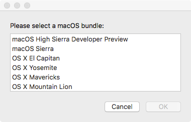

FetchMacOS v1.0
Where can I find "DownloadMacOS"? I've searched the internet, but didn't find it.
