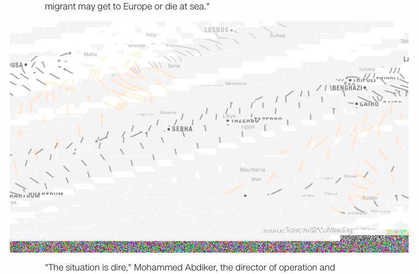

Another example of the nVidia 9400M glitch. Check out the 4th image of this (depressing) CNN article:
http://www.cnn.com/2017/11/14/africa/libya-migrant-auctions/index.html
Interestingly, this glitch in the CNN article doesn't happen in Firefox. The video in the CNN article I'm talking about is mid-article, and is the video that shows the map of the region.
However, Firefox does show the 9400M video glitch if you directly play the iPhone X video:
https://images.apple.com/media/us/i...0c34a926a7/overview/primary/hero/large_2x.mp4
I wonder what the difference is.
