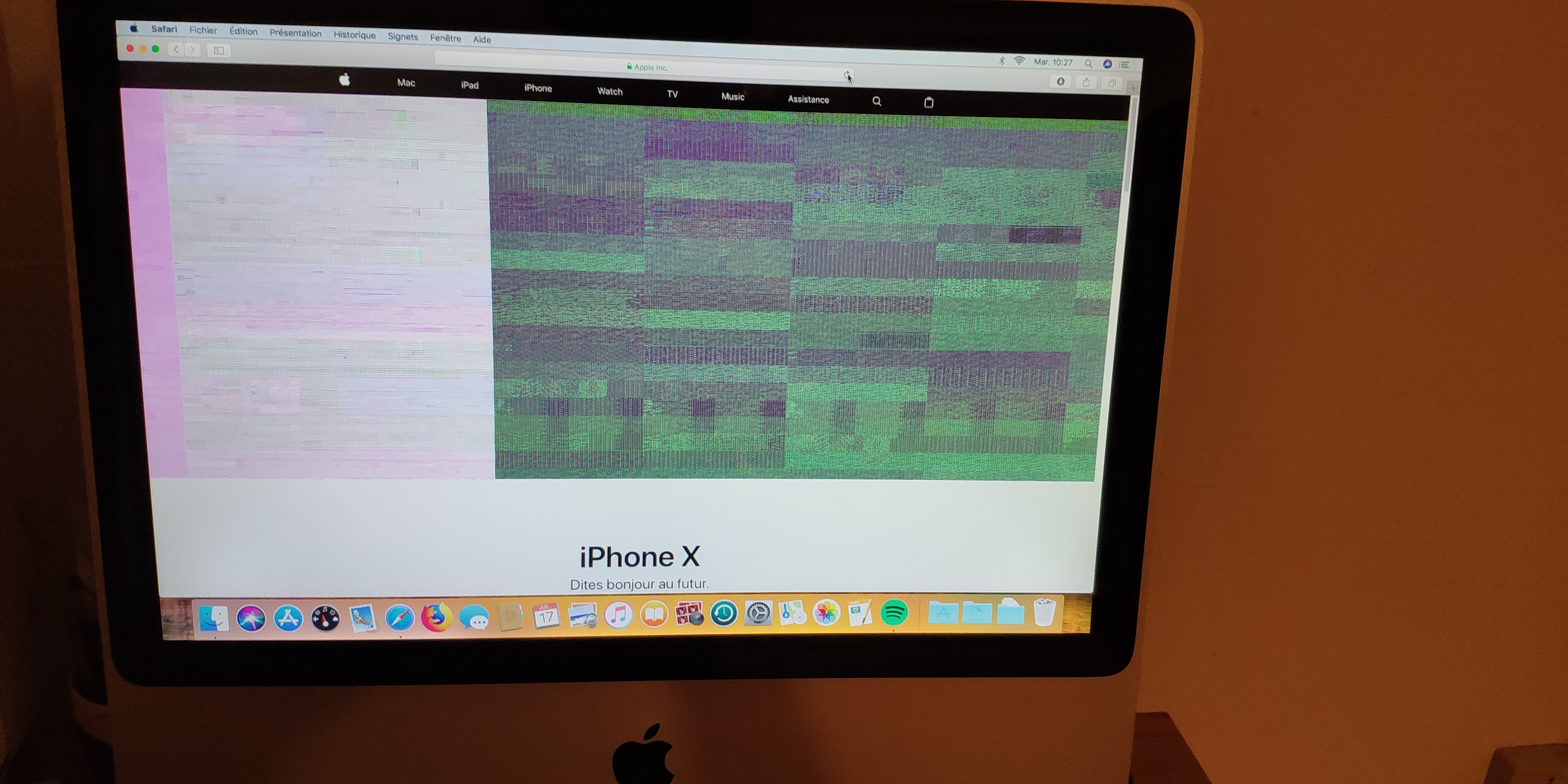

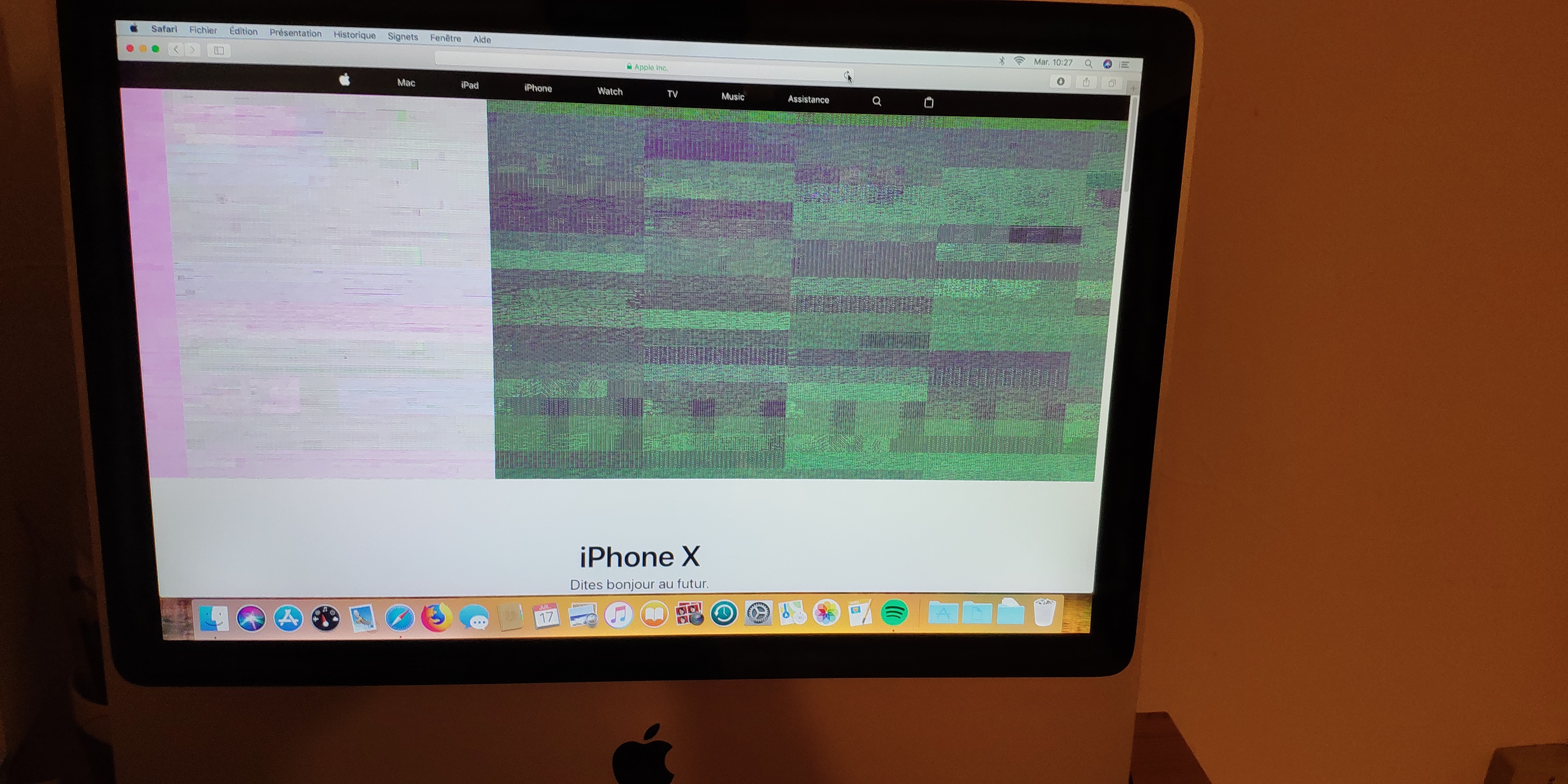

Hi,
I have an iMac 9,1 (Early 2009) with Intel Core 2 Duo (2,66 GHz) and Geforce 9400 (256 Mo).
Updated from El Capitan to High Sierra (10.13.5) without issue.
But since the 10.13.6, I have a problem when I go to the Apple website (main page) : there is a system glitch (see attachment). I did a clean install with High Sierra Patcher and run post-install script for my Mac.
If I wait a little time, it disappears and the webpage display again correctly.
The patcher proposes to me to install an update of Backlight Control Patch and if I accept (after reboot), the problem on Apple website appears again and iMac freeze (I can move the mouse but all the UI is frozen and I can't click anywhere).
Is this a known problem ?
Thanks in advance ;)
Have a good day / night.

Hi,
Is that just happening when loading the Apple site? Not others?
FWIW, I have the same iMac as you (iMac 9,1) but mine has the GT120 GPU, running 10.13.6 and I'm not seeing that.
To me, from that pic you posted, it looks like a GPU hardware issue.
