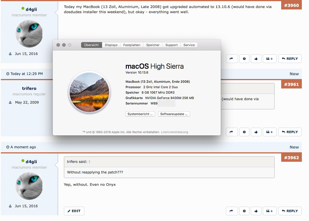

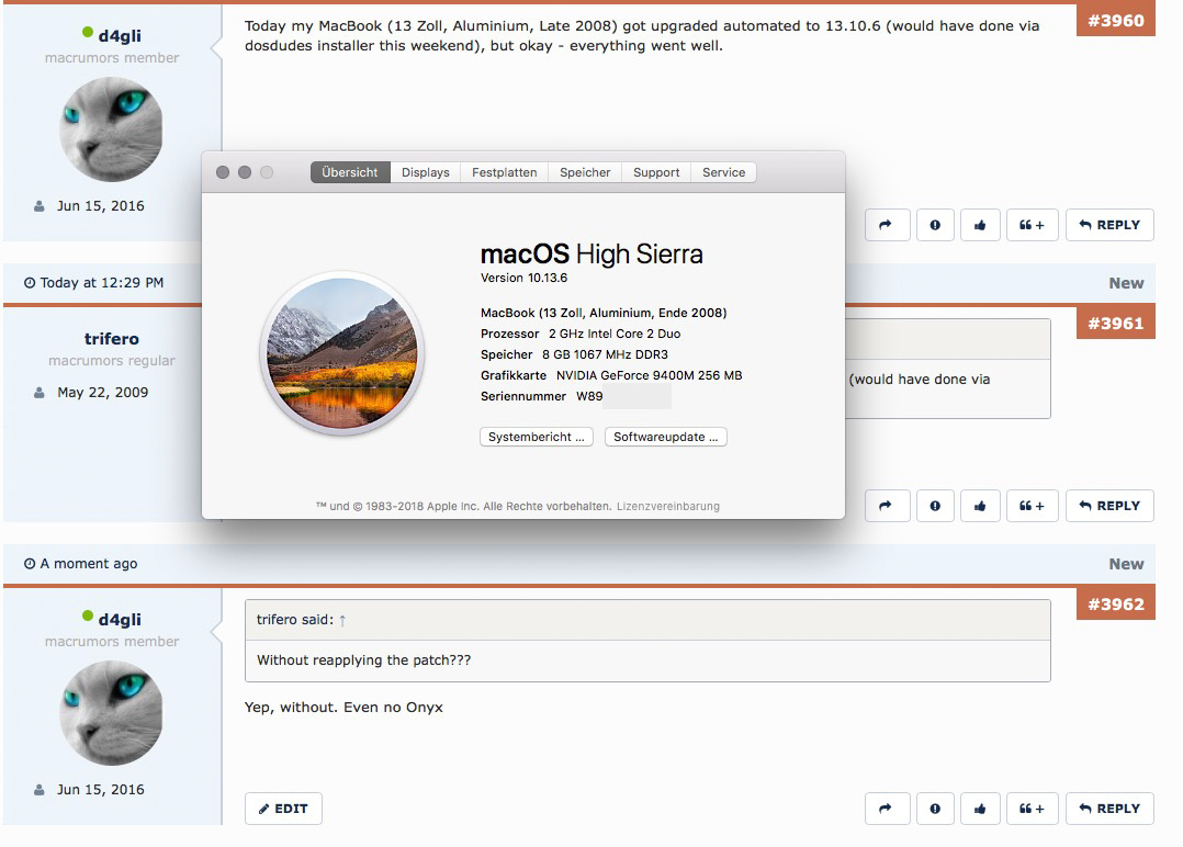

Today my MacBook (13 Zoll, Aluminium, Late 2008) got upgraded automated to 13.10.6 (would have done via dosdudes installer this weekend), but okay - everything went well.
