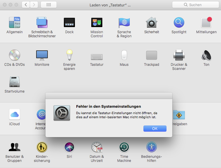

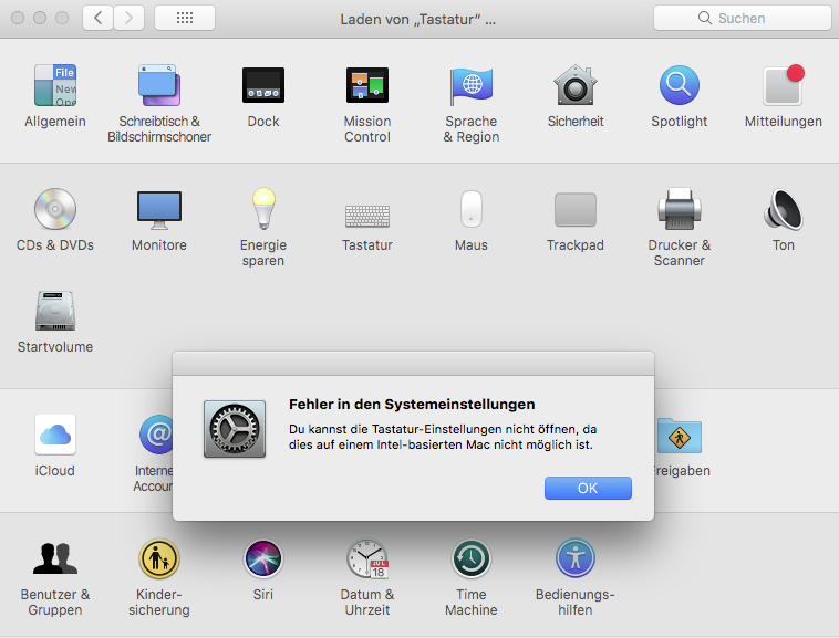

@dosdude1
I have the following problem:
I can not use the "keyboard" + "mouse" + "trackpad" menu in the settings.
What I have found out is that it works fine after reinstall but it stops working after i update 2 patches with the patch updater. the patches which got updated are "night shift" + "backlight"
I reinstalled to confirm and it happend again. I do not want to reinstall. Please help me find out whats going on.
Night Shift works fine but backlight is buggy, it gets reseted after I switch tabs in the monitor menu.
iMac 7.1
High Sierra
the error is in german, in englisch it means "error in the system settings - you can not open the keyboard settings because it is not possible on a intel based mac"
Reactions: TimothyR734

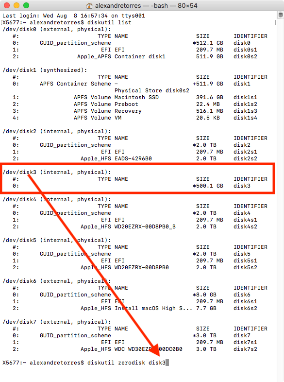

Let's test something different this time. Could you please fully erase your HDD like this?
1) First list your disks with:
Code:
diskutil list
2) Find what's the disk number of the HDD that you're gonna erase/install High Sierra, like on my screenshot:
Replace diskXX on the command below to zero disk your HDD:
Code:
diskutil zerodisk diskXX
You don't need to wait until the end of zero disk, 5% and you can terminate it, unless you suspect that your disk have some bad sector or another defect.
Code:
3) Now shutdown your Mac Pro and remove your OWC SSD, put your createinstallmedia created 10.13.6 pendrive, don't use dosdude1 one since your Mac Pro is a supported one.
4) Boot from your createinstallmedia pendrive and install 10.13.6 on your HDD without restoring your TimeMachine.
