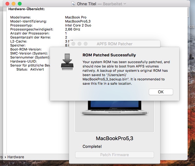

Hi i got HS installed on my Macbook Pro 2009 15", 5.3 with the informations here and great work of dosdude1´s HS patcher. I use HFS+ on my SSD.
Also last security update -03 worked - only the recovery partition update failed. System updated (Build ID) OK.
Question:
For the future (if HS sec updates stop because of new 10.16) i want to convert / come to APFS Filesystem and Mojave update.
1. Is it possible / or better to use APFS also in HS? Perhaps no probs in with sec updates if they stay comming in 2020/2021?
2. My Macbook Pro 2009, 5.3 has no APFS EFI support with orig. EFI ROM - for my knowledge.
To see that "verbose" Screen if APFS EFI is used by some efi script - by the HS Patcher? - (not using the APFS ROM patcher!) would be OK for me. But if possible i would prefer native EFI support by using APFS ROM patcher.
What i collected about that in the internet i found:
1. An video which tells that secure usage of APFS ROM patcher is only if Chipset is Intel an not NVDIA.
How to Flash Your Unsupported Intel Chipset Mac For Native APFS Booting!
2. Most information found here is, that it depends not on the Chipset but on which EEPROM type is used on the mainboard and this EEPROM type must be exact selected in the APFS ROM patcher - if the app shows/asks which EEPROM type should be flashed.
Is it correct that - my Macbook Pro 2009 5.3 has an NVIDIA Chipset - using APFS ROM Patcher is unusable with NVIDIA Chipset?
Or does the risk depends only on selecting the rigth EEPROM type - can be done by opending MAcbookPro and look on the mainboard after the excact epprom type.
EDIT: My EEPROM type is: SST 25VF032B (company is SST, not MX like i seen on an screenshoot)
Has anyone with MacBookPro 2009, 5.3 already used the APFS ROM patcher with success and can give hints to use it?
Thanks
PS: I dont have any need to do that fast ;) - i am very patient with this APFS ROM patcher and sure would check my EEPROM Type by opting the case if needed!

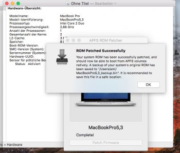

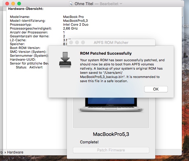

EDIT: I tried the APFS Patcher.
1. Step was backup / read out the ROM ... takes at least 7-8 minutes
2. step was writing patched ROM . takes even longer ;) - i think around 15 Minutes
Then success Message:
Reboot worked - i cant test APFS because i am at HFS+ but i believe the success message.
Could i try to boot from an APFS USB Stick for tests?

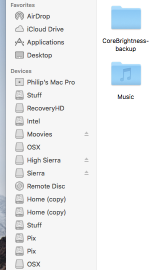

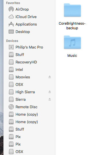

I tried High Sierra again using the HDD enclosure I mentioned. The installation seemed to go OK with the minutes ticking along like minutes do. But once I reached the stage to set up the OS (wifi etc) the system did not recognise the bluetooth keyboard and trackpad. A reboot sorted that so I could complete the setup.
Problems remain with bluetooth. At the login screen the system does not recognise the keyboard and trackpad. Also the screen will time-out to black and can't be activated because of the lack of connection to the keyboard and trackpad.
In addition, the system still renames drives in the Finder sidebar when I move them. The system also won't let me arrange the drives like I want; frequently 2-3 drives are grouped together and move as a bunch. I have copies of several drives and they suddenly have the same names which makes it impossible to know which drive I'm working from.
I tried install the security update etc through the App Store but got an error (pkinstallerrordomain error 112) and a message that the installation did not complete. Upon reboot the keyboard and trackpad refuse to work, however through Screen Sharing I managed to access the computer and press Install on the desktop message that the update didn't install. However that didn't work, the computer didn't reboot. I then checked the App Store and, weirdly, there it says there are no updates to be installed. When I check System Information it says that the OS has, nevertheless, been updated to 17G13035.
This doesn't feel too stable to me and I'm going to wipe and try Sierra instead. I give up on High Sierra. This is my main machine and I need it to be more reliable than this.
Reactions: TimothyR734
