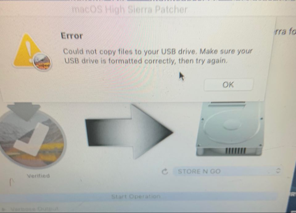

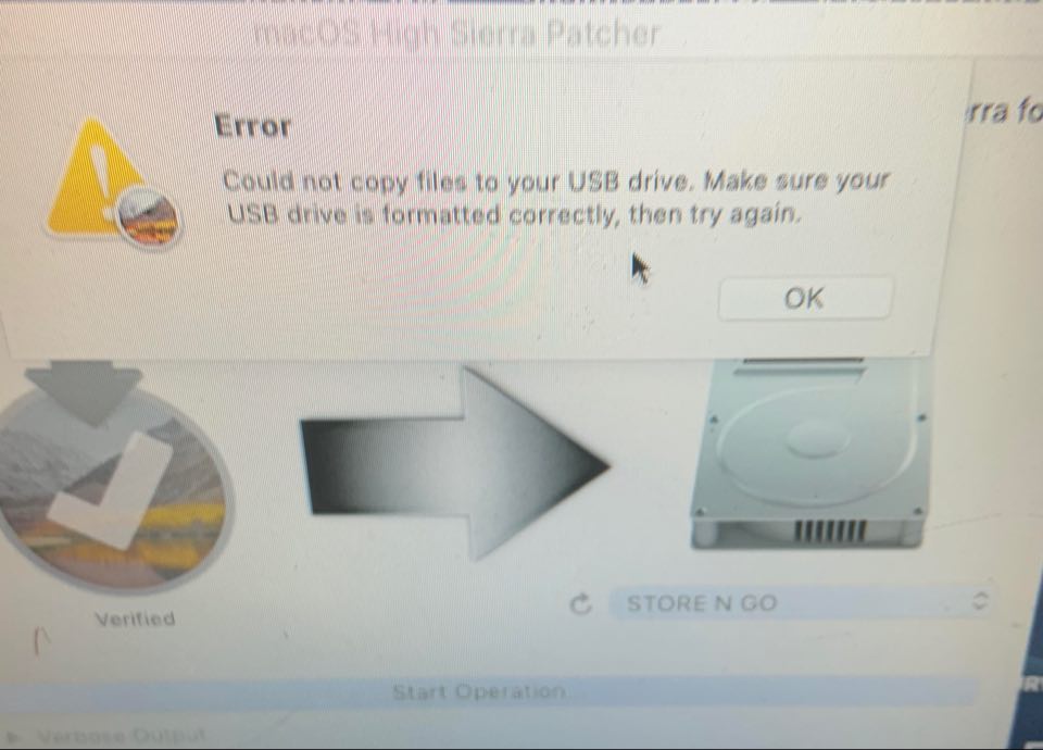

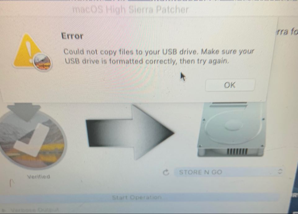

Good morning, was wondering if anyone else here has been having issues with the USB failing to copy files when running Dosdudes High Sierra patcher. Tried two different macs and but tend to get this error each time. Any suggestions? Error.jpg
Good morning, was wondering if anyone else here has been having issues with the USB failing to copy files when running Dosdudes High Sierra patcher. Tried two different macs and but tend to get this error each time. Any suggestions? View attachment 943141
What version of macOS are you running it on? I had success making a patched USB installer on Mojave with the latest security update but I know someone who had nothing but problems trying to do the same on Catalina 10.15.6
As Macs are unable to boot to an OS earlier than what shipped, wondering if the patcher can be employed on a 2019 iMac that shipped with 10.14 Mojave in order to install 10.13 High Sierra?
I had the same error, make sure your usb drive is named OS X Base System.
I know that renaming the usb drive should work, but for me it didn’t.
