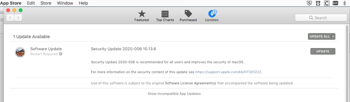

Anyone knows how to apply the Security Update 2020-006 (see picture) ?
It came up in the App Store (under Updates) but I can not find it as a download on Apple sites.
Any success to run this update on unsupported machines (after getting HS on there with the patcher/instructions as to post #1) ? [would like to keep a MacBook 5,1 updated for a moment longer ... :) ]
