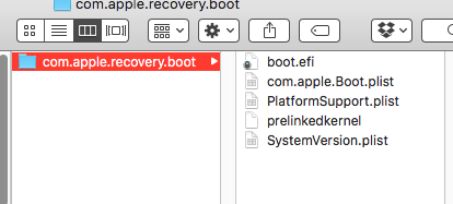

Booting from APFS can be enabled without any extra partition. The key is the "com.apple.boot.S" folder on the recovery partition with the correct settings.
Really? Can you elaborate a little more? It’s not like I understand a lot about it but just out of curiosity ;)
What is this "com.apple.boot.S" folder? I only see
What is this "com.apple.boot.S" folder? I only see View attachment 714050
Fusion drives and encrypted drives boots with helper partition. The files from the helper partition can be copied to the recovery partition. To make com.apple.boot.S working, you need to copy the patched prelinkedkernel and modify the configuration plist to point to the real root filesystem.

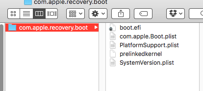

Recovery can be host on this partition too. Simply copy the files and it will works.

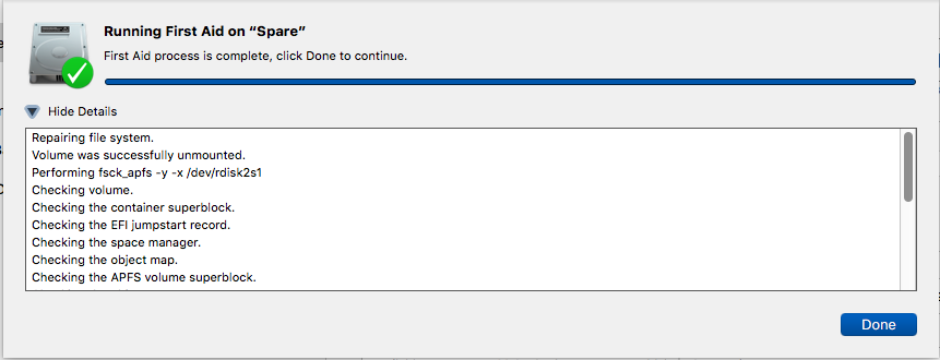

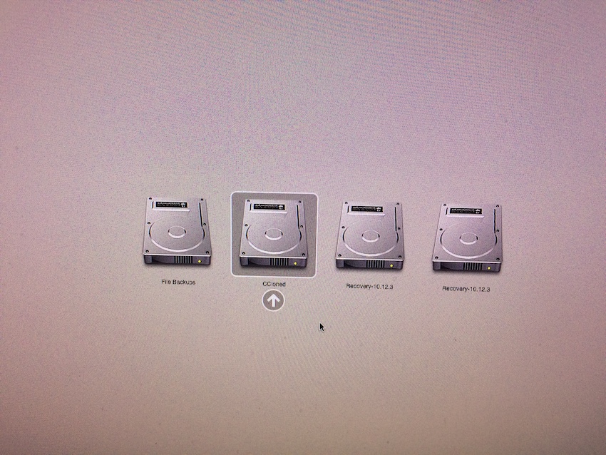

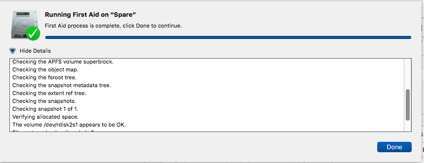

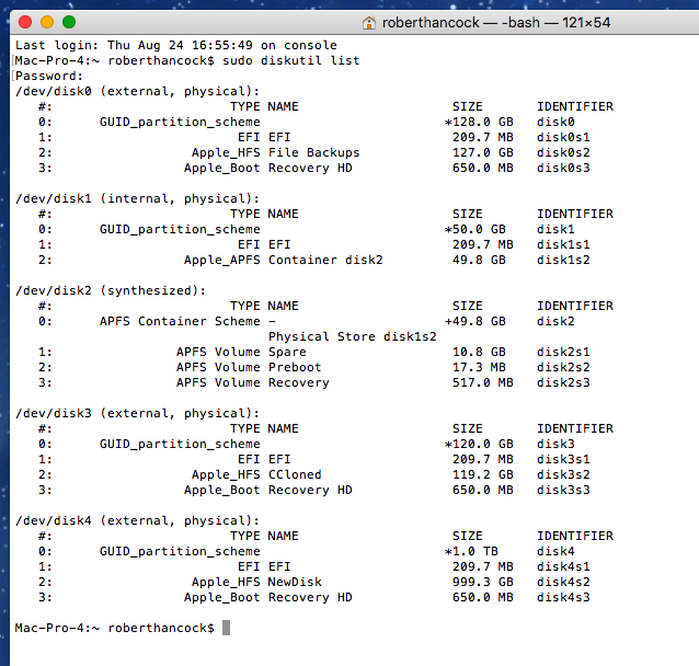

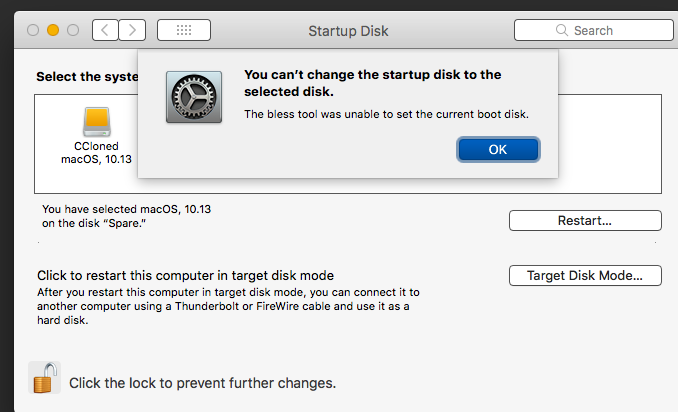

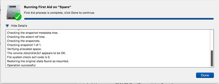

Tried it and does not work to boot. The patcher built the USB installer with the beta 7 download no problem and the USB installer booted the MacPro 3,1 no problem and completed the install to a newly formatted APFS SSD called "Spare". The post-install patch seemed to work properly but at the next boot from Spare, it defaulted back to my regular 10.13 HFS+ install on CCloned.
Disk utility shows that Spare has the right structure (enclosed screenshot). However, when I tried to selected Spare at the efi boot screen, it does not appear (see screenshot). When I use DU in 10.13 on CCloned to check Spare, it seems OK. When I boot back into 10.13 beta 7 on CCloned, and use System Preferences-Startup Disk to try to set Spare as the boot volume, I get a message about the disk not being blessed.
So something is not quite right with the current procedure.
