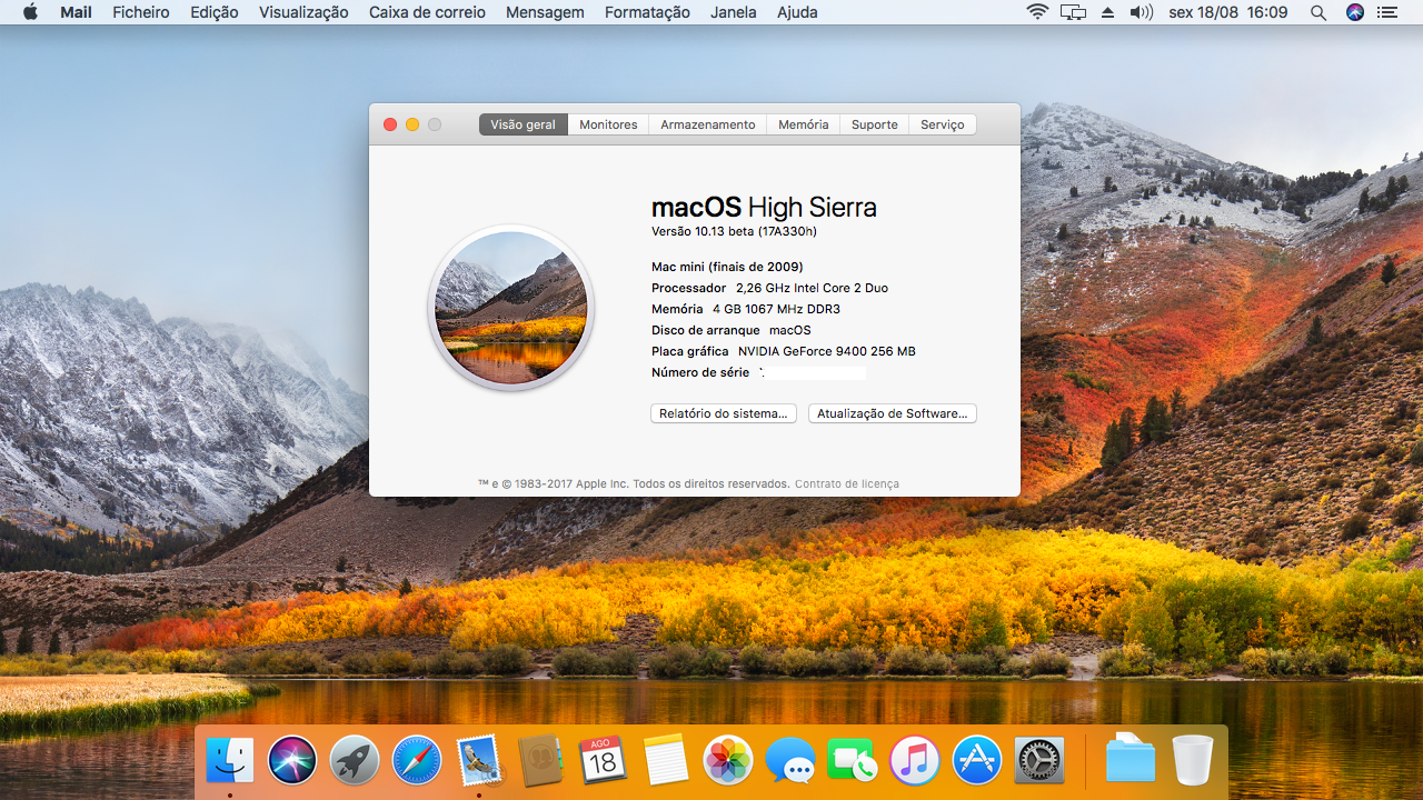

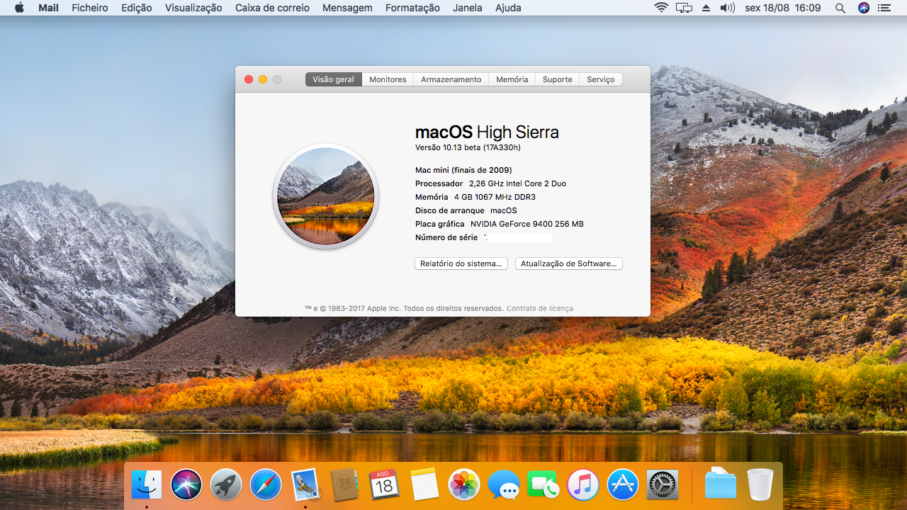

My Mac mini late 2009 is working High Sierra Beta Developer 6
but Original WIFI card is not Working
Please tell me method to recognize Swapped WIFI card

The number of your Beta release in the attached photo is for DEV BETA5
Apple Seeds macOS High Sierra Developer Beta 5 Build (17A330h)
Apple Seeds macOS High Sierra Developer Beta 6 Build (17A344b)
Ups my bad, I really thought I had developer beta 6...
