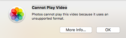

When I try importing a 4K HEVC video into Photos on my MacBook5,1 with High Sierra, it imports fine, but if I try to play it, it says this:
However, the file plays in QuickTime (with stutters). Also, HEIC files in Photos display fine too. Or, if I record 1080p HEVC videos, they will play fine.
Is this just an intentional limitation by Photos / High Sierra, or is this a bug?

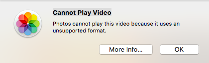

It may be related to this:
https://support.apple.com/en-us/HT207022
On some older devices, support for HEVC is also affected by the resolution and frame rate (fps) of the video:
    • iPhone 6, iPhone 6 Plus, and iPad Air 2 work with HEVC video that was captured at no greater than 1080p/240 fps.
    • iPhone 5s, iPad Air, and iPad mini (Retina models) work with HEVC video that was captured at no greater than 1080p/60 fps or 720p/240 fps.
    • Mac models from mid 2015 or earlier work with HEVC video that was captured at no greater than 1080p/240 fps.

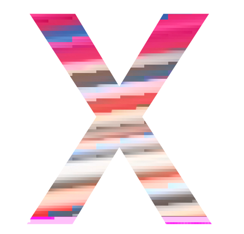

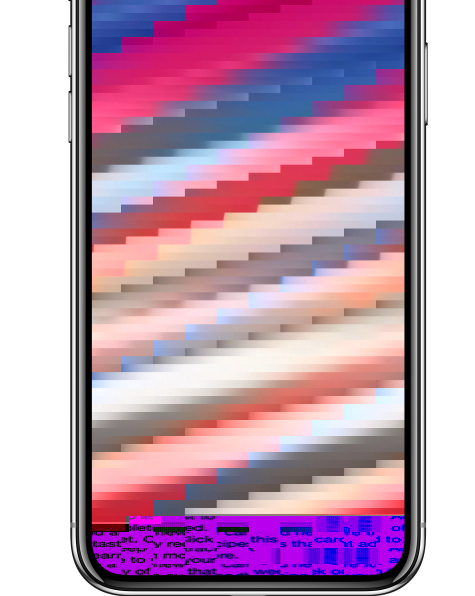

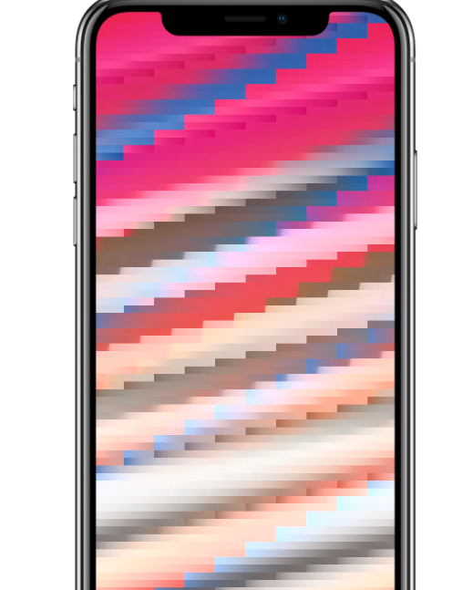

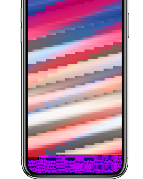

Quick question for those who've put High Sierra on their old MBP's, particularly those on MBP5,5's.
Is the X & the phone under it at the top of https://www.apple.com/de/iphone-x/ corrupt for you in Safari or Firefox?
I would say its fine in Chrome but the animated X doesn't appear at all and the phone under it is a static image (where its animated in Safari)
First two images Safari
View attachment 719361 View attachment 719360
Firefox:
The actual source video shows the corruption for me in Safari, in Preview and Quicktime ( I downloaded it from https://images.apple.com/media/us/i...0c34a926a7/overview/primary/hero/large_2x.mp4 ),
But video plays perfectly in both Chrome and VLC.
Other random videos I've checked work fine. Also the low & medium versions of that phone video work fine in Safari.
https://images.apple.com/media/us/i...0c34a926a7/overview/primary/hero/small_2x.mp4
https://images.apple.com/media/us/i...c34a926a7/overview/primary/hero/medium_2x.mp4
According to this user...
https://forums.macrumors.com/thread...e-try-this-safari-test.2069901/#post-25208868
...the iPhone X garbled colours glitch also occurs with MacBook6,1 (which also has 9400M). This is a fully supported machine for High Sierra.
