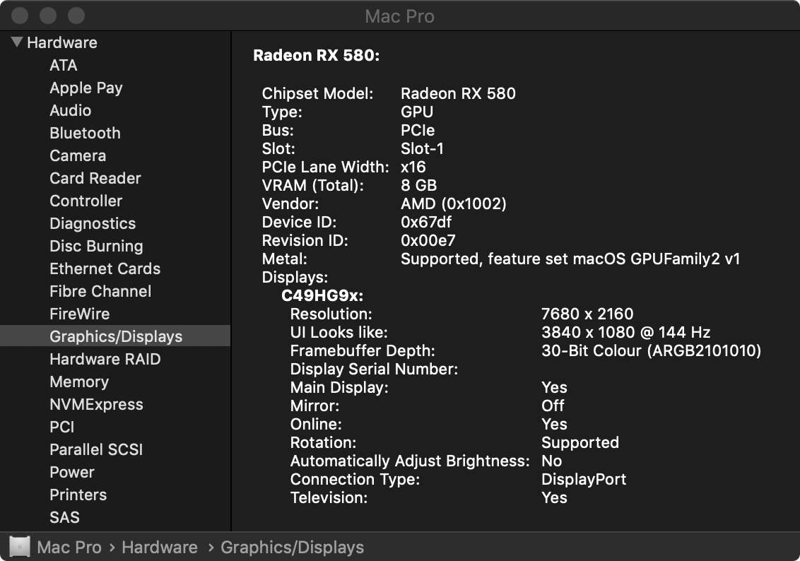

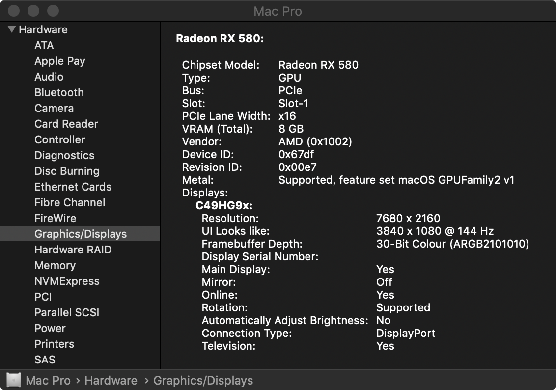

That GPU ident is irrelevant, you can hex edit the kext to make it shows whatever you want.
For UI, may be Sierra still use CPU to process some UI animation / effect.
I never use RX580 in Sierra, and no plan to try that as well. So, don't know the difference.

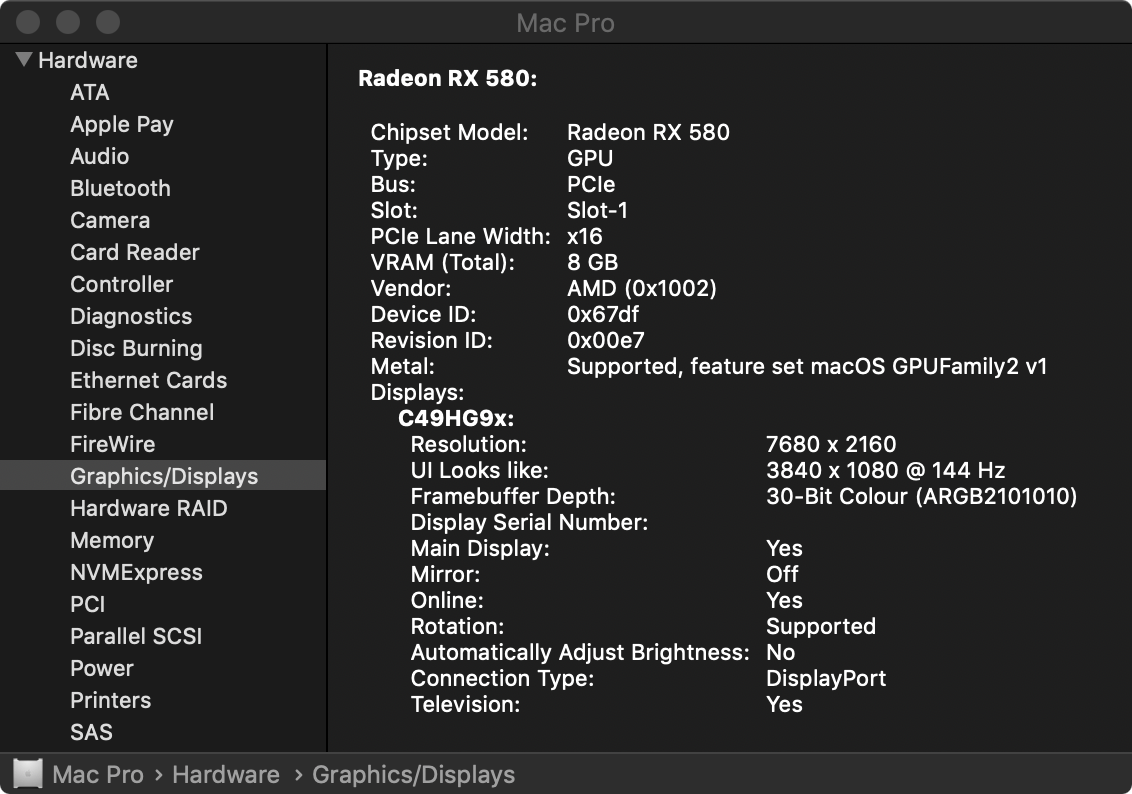

But for Mojave, RX580 drive the UI really very well. Extremely smooth even it's rendering my Ui at 2x 4k HiDPI @144Hz.

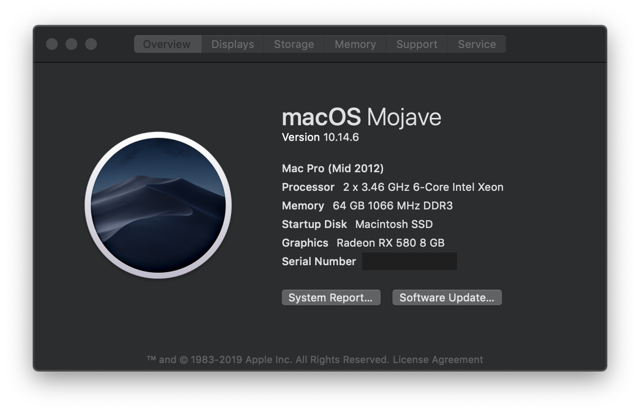

I am running Digital Performer 9.52 with two displays, one of which is a 4k TV. My GPU is an RX460 4gig by Gigabyte. Other hardware includes a MOTU AVB interface (USB-connected) and UAD-2 PCIe card.
Under Sierra 12.6, I had to use a Display Port to HDMI active adaptor and SwitchResX software to get 60Hz from the 4k display (running in Gaming Mode to minimize latency). Although all other apps' UIs responded without perceivable lag, DP's UI was quite laggy, response to zoom commands was slow and irregular, and the display lagged real time by a fraction of a beat. Not unworkable, but less than pleasant and occasionally frustrating to use.
I just migrated to Mojave (14.5) and am now able to run the 4k TV directly from the GPU's HDMI port. No more laggy UI in DP, and audio and video are now time-aligned. The update from Sierra took a little doing, but with the help of Alex's guide (a Wiki at the top of the Mac Pro forum), I got the firmware updated and Mojave installed. I had to start with a clean Sierra install, migrated thru High Sierra and to Mojave, then used Migration Assistant from a clone of my old Sierra boot drive to get my apps and data installed. So far, everything is working really well. The only software I had to re-install was the UAD-2 driver (for which UA has detailed instructions on their website) and uBlock Origin for Safari.
Since getting everything set in Mojave, my Mac Pro has not crashed despite mixing several heavy-duty productions. Although I will save my Sierra boot drive clone for the foreseeable future, I plan on cloning the current Mojave boot drive immediately as a backup. Life is good!

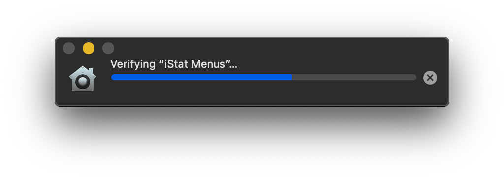

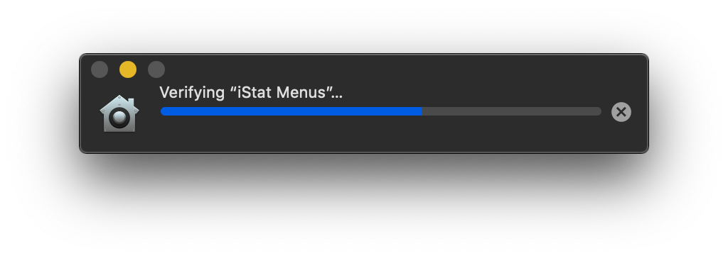

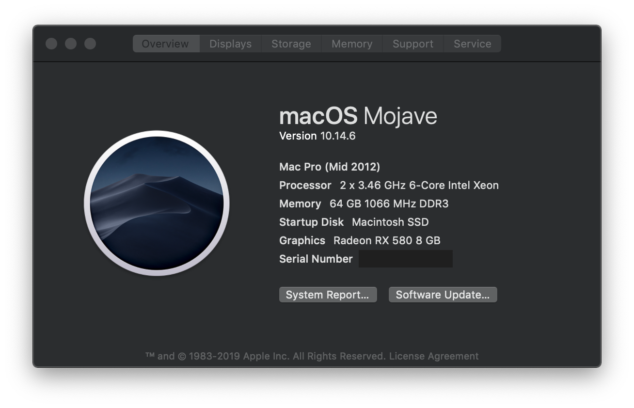

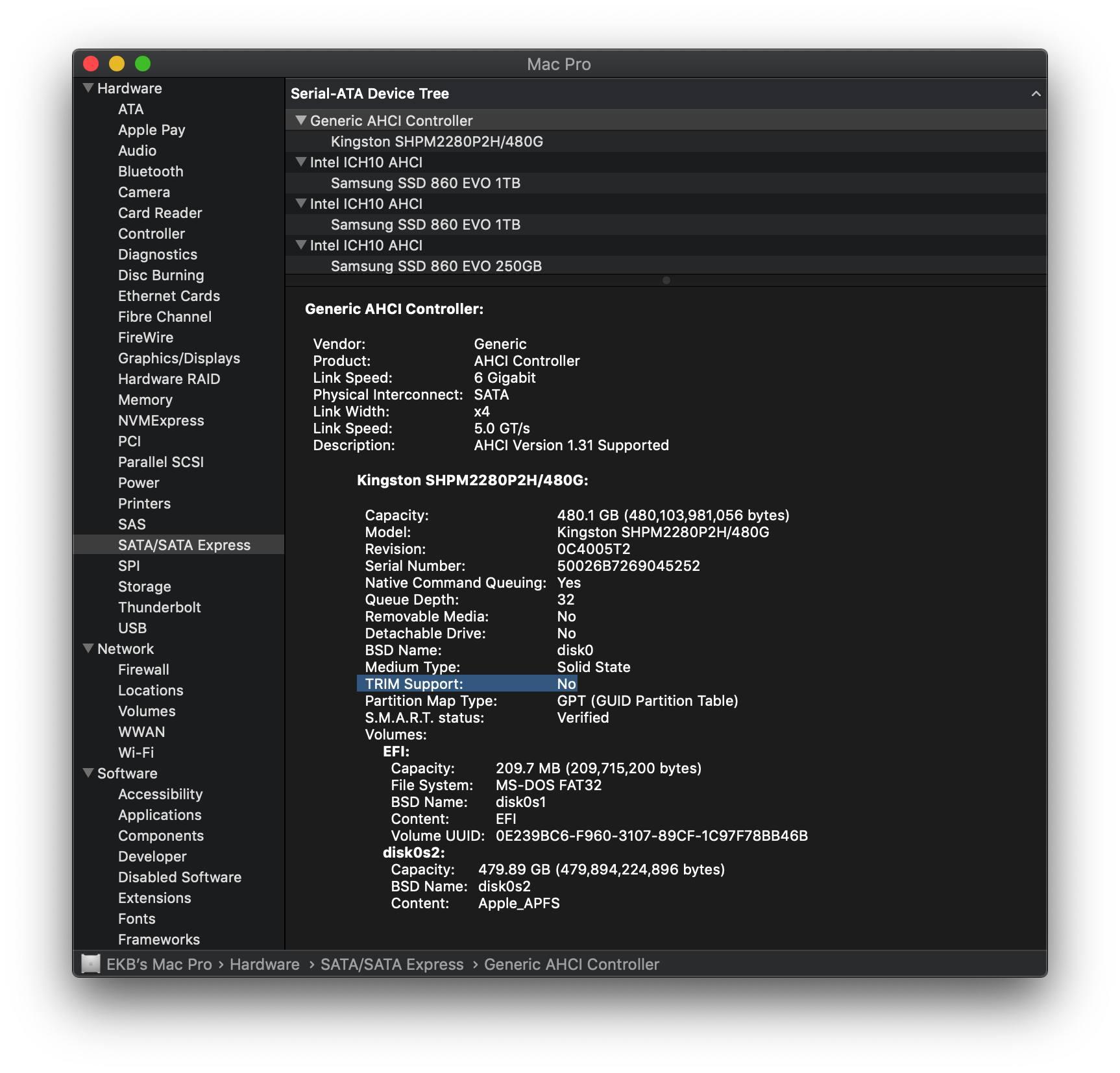

finally I installed macOS 10.14.6 .my impression is rather good so far but there are some minor problems that I think they are solvable so I'm tying to address some , I would be appreciated if you could help
1 : spinning color wheel on verifying apps (I think it take too long to verify them) and on some other stuff like opening Installer on some occasions , ....
(I have Disabled Gatekeeper and SIP)

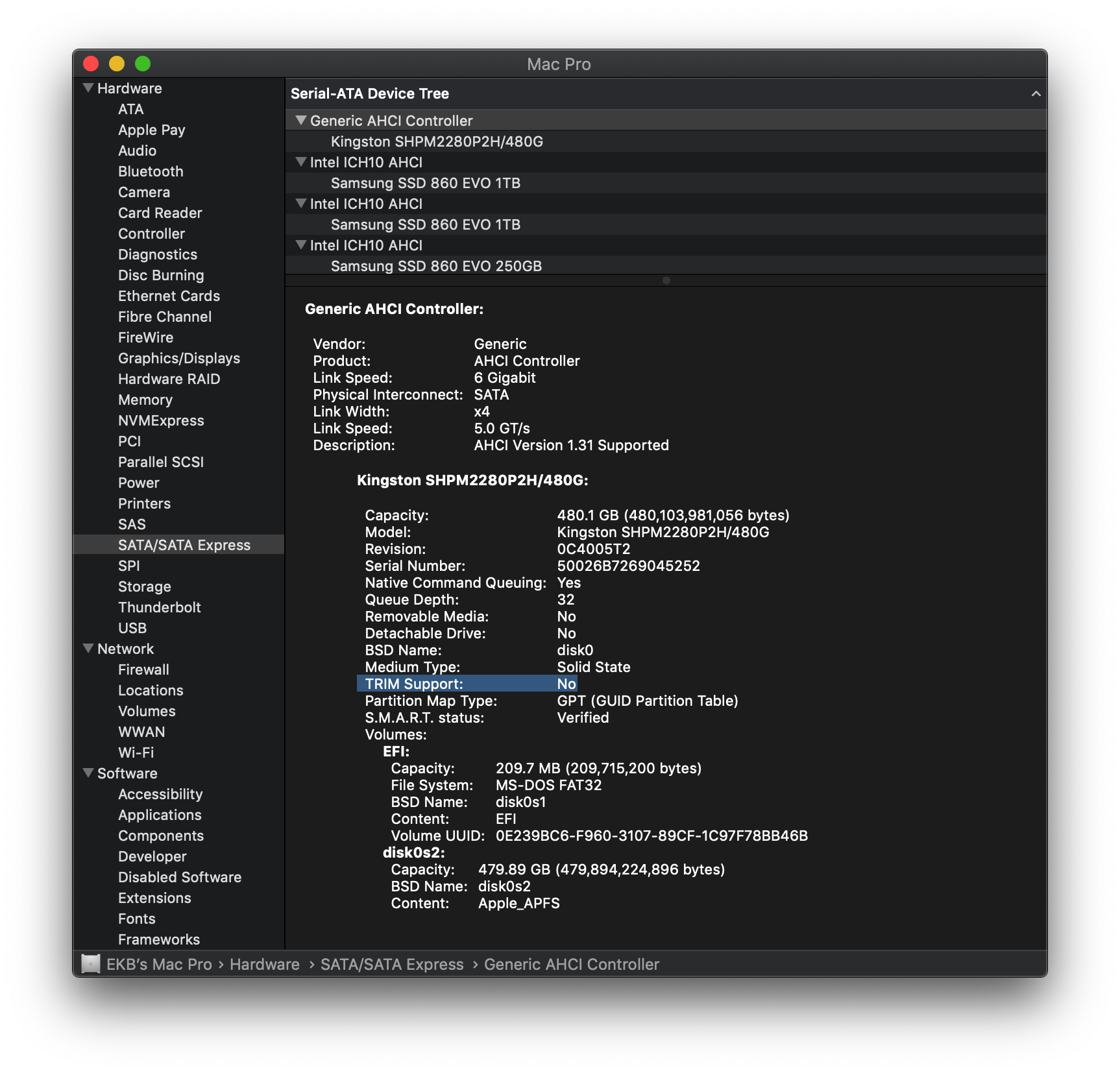

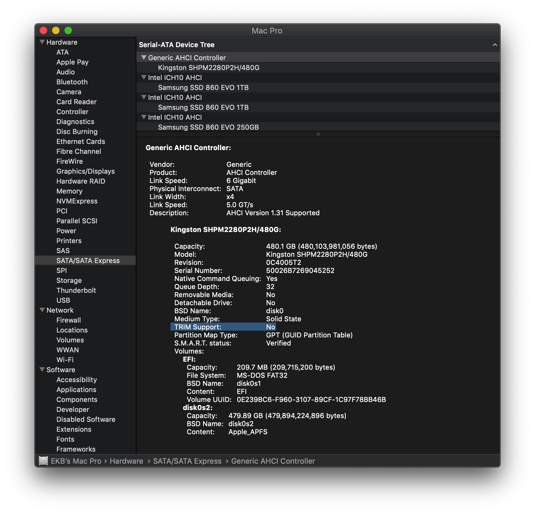

2 : TRIM is not enabled even on internal SSD drives (I have PCIe SSD that show as external device) I don't know if there is a way to make it show as internal drive

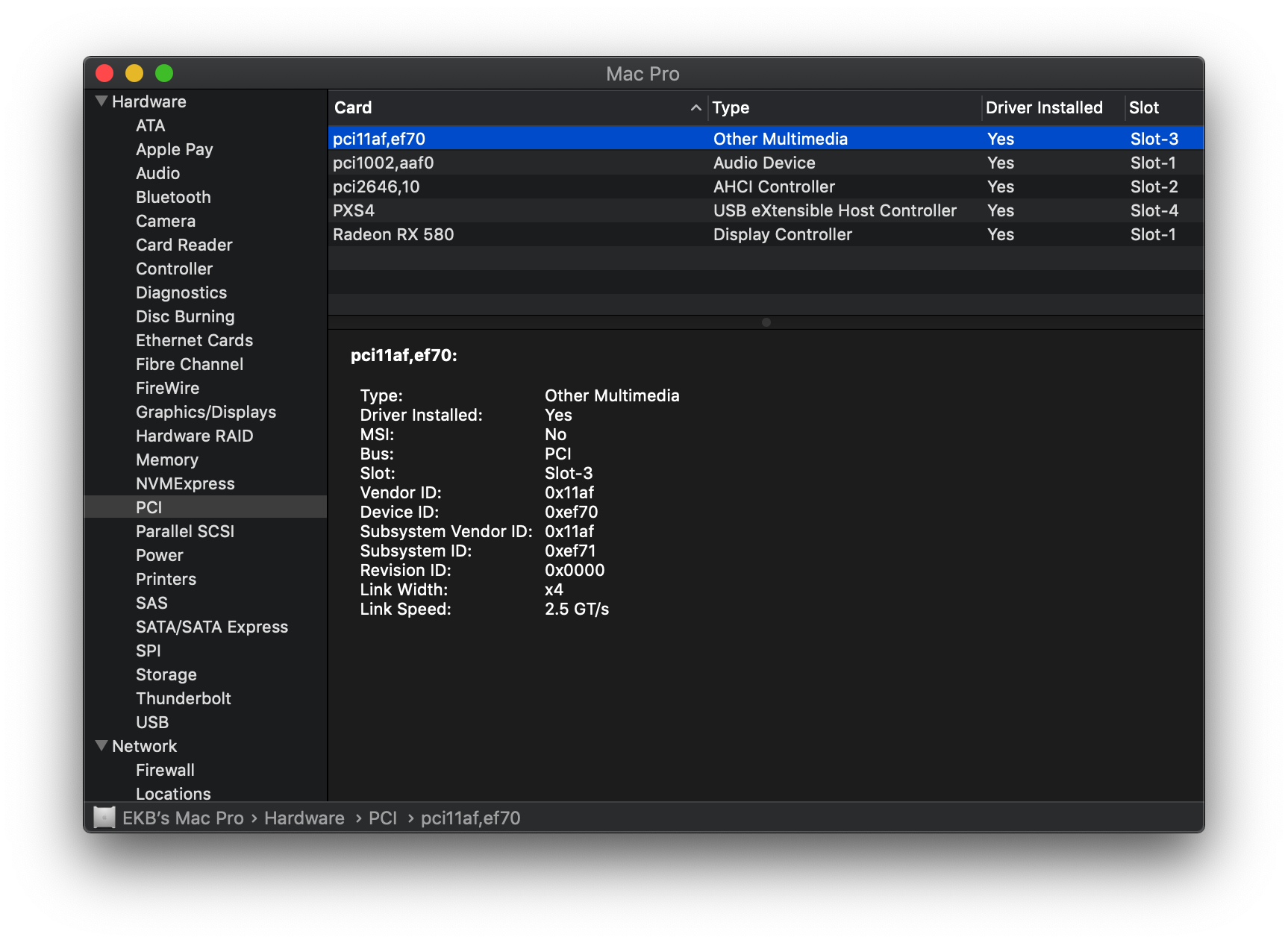

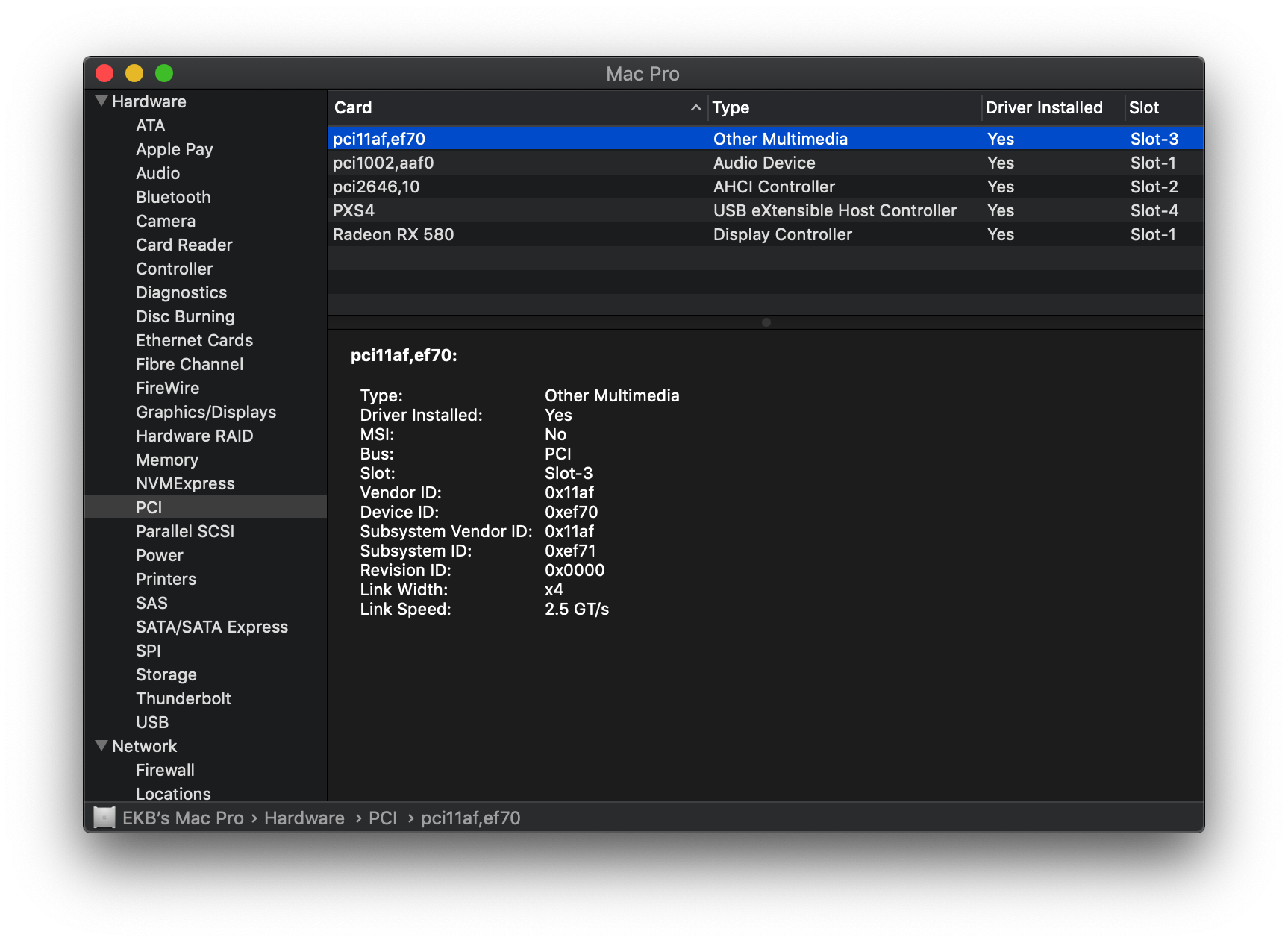

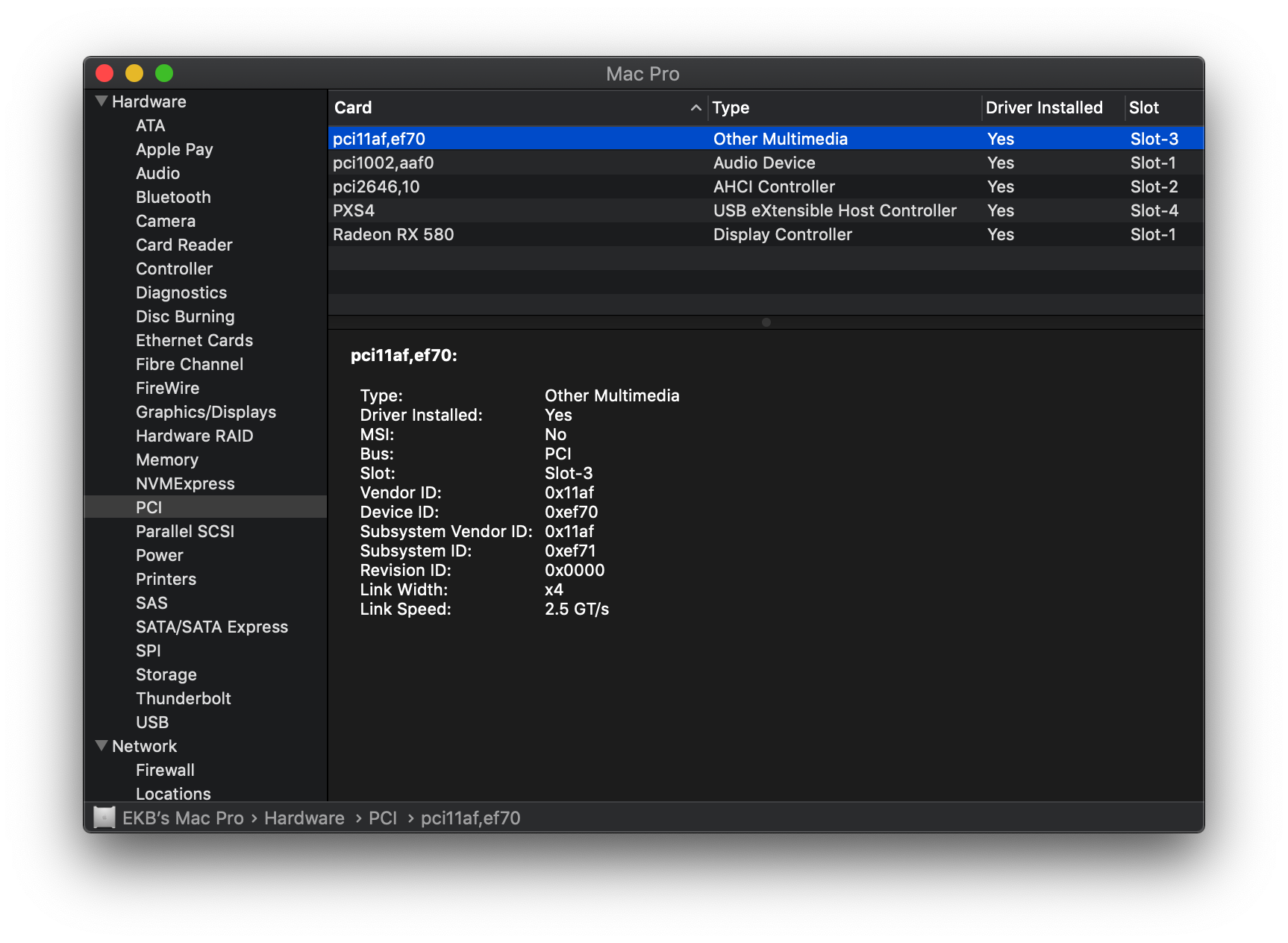

3: link Speed on my PCIe Slot-3 is 2.5 GT/s (I suppose it should be 5 GT/s after BootRom 144)
While Slots 1 , 2 and 4 are 5 GT/s

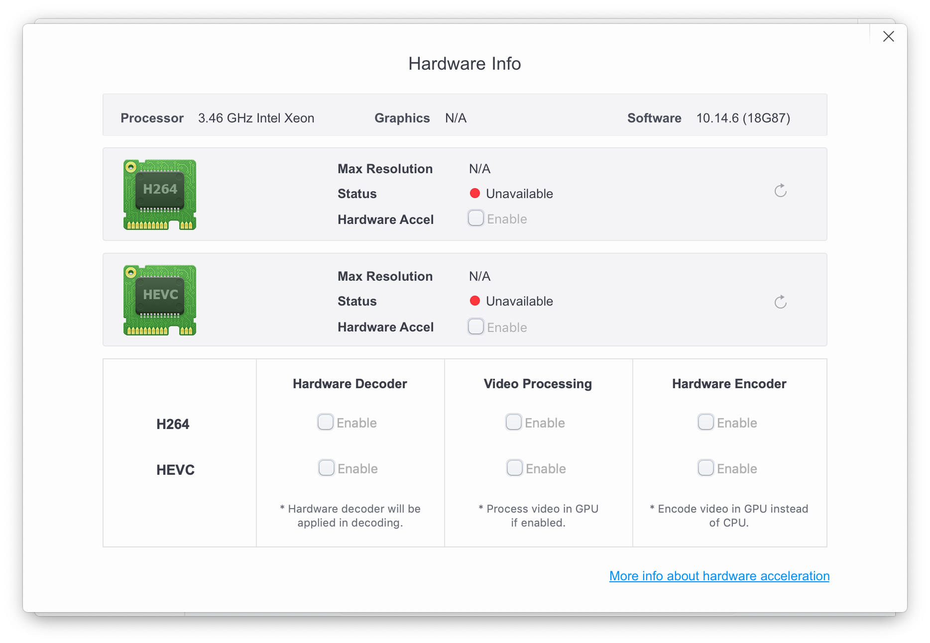

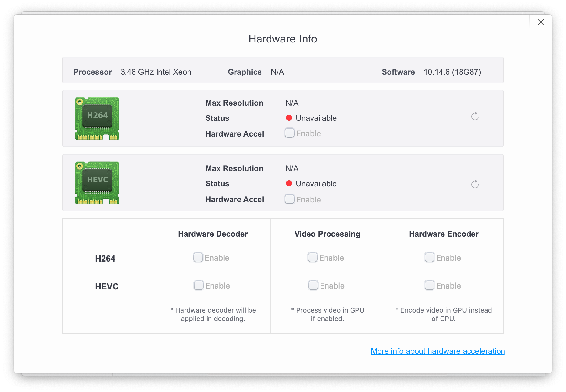

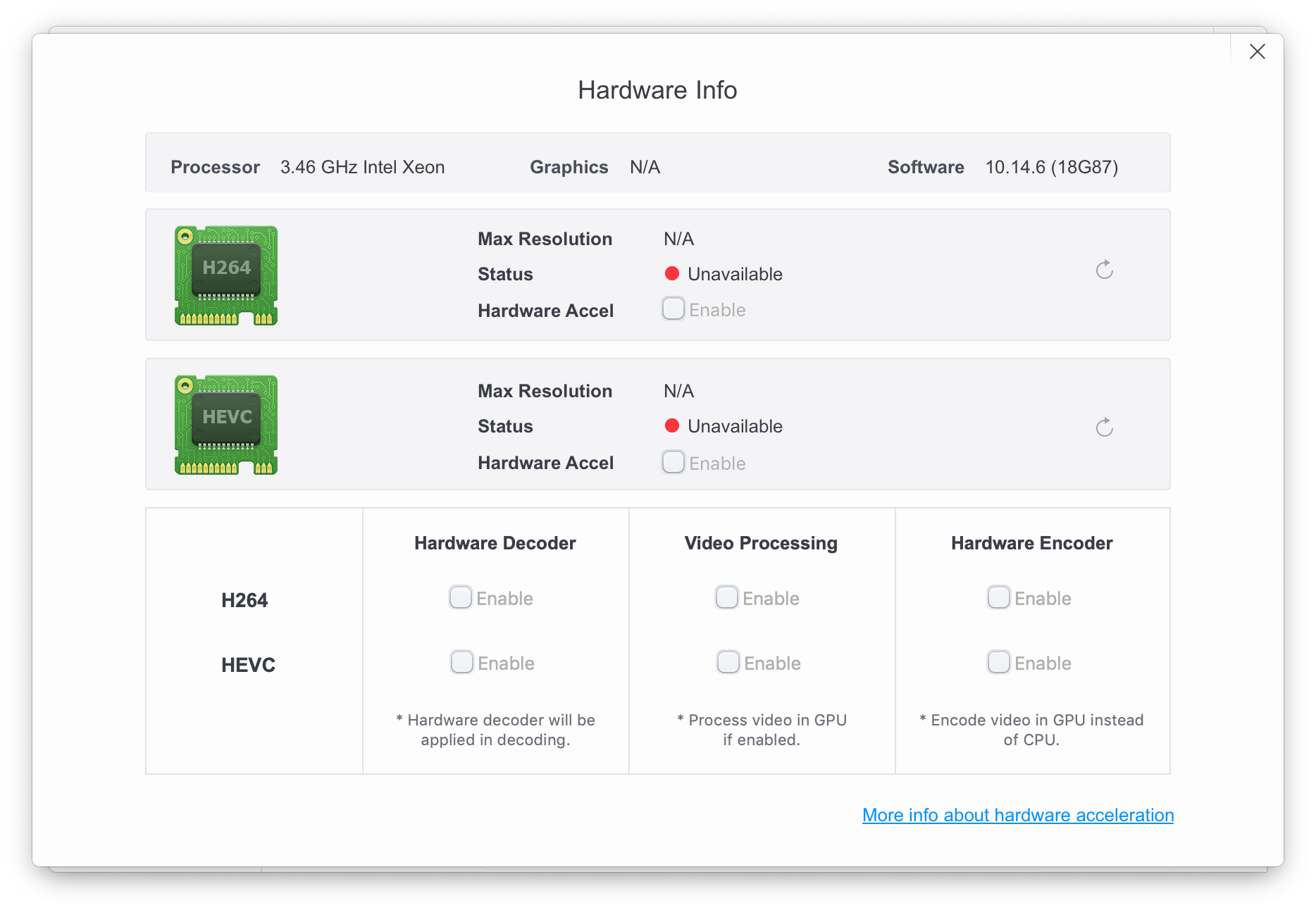

4 : Hardware acceleration is not activated, I know it is normal as I didn't apply kext method
my question is if it has positive impact on general use or using Final Cut Pro and is it safe to do in macOS 10.14.6?

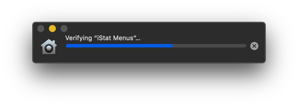

Mojave 10.14.6 is really slow on loading login items, I've already minimized them but there are necessary ones
like iSat Menu, ...
login to OS itself is so fast but loading third party programs at startup sometimes take about 5min!!

It looks like you don't have TRIM support turned on. That changed my hard drive write times from 125Mb/sec to almost 500MB/sec here on my Mac Mini with SATA III. (sudo trimforce enable <- turns it on, although there's a small chance it might not work with certain SSDs).

Oh, I missed this post. Sorry for the very late reply, hopefully you already sorted out the problems.
1) This is the command to avoid those annoying verification.
Code:
defaults write com.apple.LaunchServices LSQuarantine -bool NO
2) You need to enable TRIM manually by yourself
Code:
And innie can make them ident as internal drive (so that SWAP can work again)
3) Slot 3 can always negotiate at 5GT/s correctly regardless firmware version, however, that only happen if the PCIe card itself can support 5GT/s.
4) HWAccel is not activated by default for Mac Pro 5,1. You may follow my guide to apply Board-ID injection. Or patch the AppleGVA.framwork to achieve H264 HWAccel, and HEVC hardware decode. But for full HWAccel, so far, I can only achieve that via OpenCore. If you make the system ident it as iMac Pro, pretty much all new functions can work on the Mac Pro 5,1.
