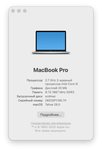

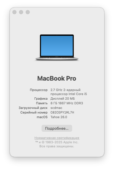

Tahoe 26.0b2 on MBP12,1 (Pro 13 2015 A1502), using OCLP 3.0.0n (no patches). All is working, expect graphics acceleration, Wi-Fi & BT and audio.
Cannot patch system by OCLP 3.0.0n or OCLP-mod, but keep trying;)

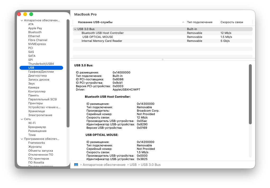

OCLP 3.0.0n is generating OC EFIs that include a separate USB map for Tahoe. Those who have already modified their existing USB map (adding usb-port-type and usb-port-number to each port definition) will only have a single USB map for Big Sur through Tahoe.
OCLP 3.0.0n USB Map Kexts
Reactions: sinbad21
Yes ist correct the OC 1.0.5 make this Automatic and create this Usb-tahoe.kext in kext-Folder
