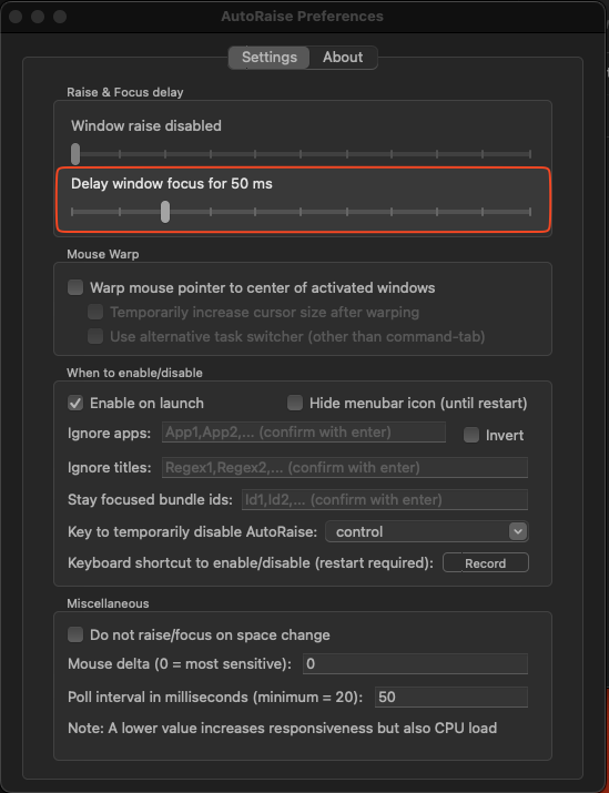

I recently experienced a very nasty situation with Macos, I have never had it before. I was on the latest beta of macOS 15 Sequoia. During a work meeting, my screen and all monitors went dark - the computer became unresponsive and then turned off. After a reboot, it boots me into the boot menu of Macos. Basically everything got wiped, thankfully I had all critical data backed up in the cloud. So I guess don't use Beta versions for work (one of the reasons I am using Beta versions is due to this bug discussed in this thread. Alas it is still not fixed.)
Long story short - I reinstalled Clean Sonoma 14.6.1. Guess what? Without any additional software, just a clear system - the bug is still there.
So don't waste your time searching for the app that is causing it—it's a fundamental issue introduced by Apple at the base software or even firmware level, and they refuse to fix it for some reason.
It is the most annoying issue I have experienced with MacOS, and the only solution that helps me get by daily is
With those settings:
Perhaps anyone else has some updates? How do you guys get by? I'm still baffled that YEARS later, the issue is still there. I wonder how Apple developers work with their system - all use one-screen laptops?
