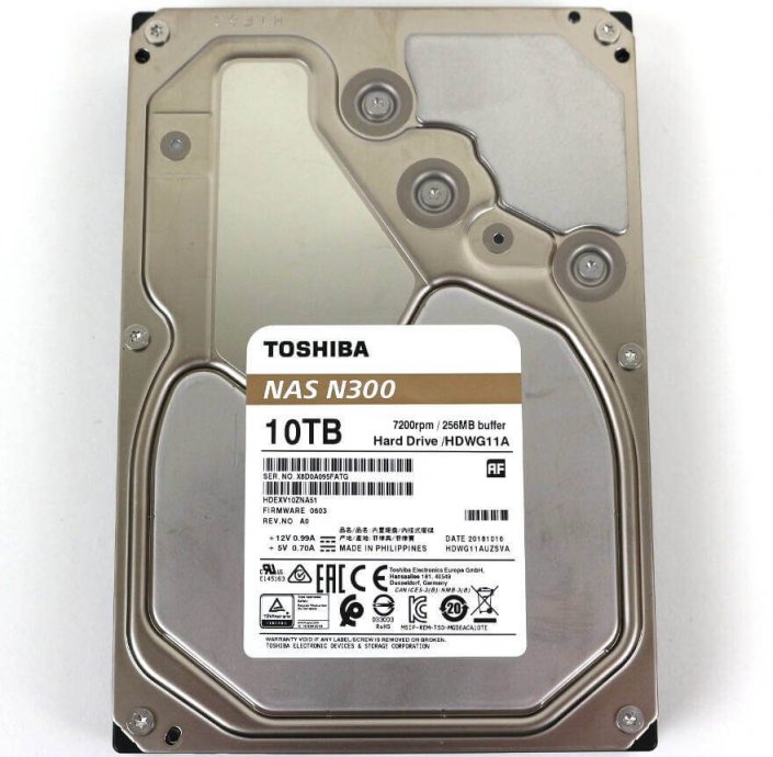

Hi guys. Has anyone tried there 10 TB drives (TOSHIBA HDWG11A)?
Will they work without issues seen in this thread?
I'm also running N300 6TB drives (TOSHIBA HDWN160) without problems, but these seem newer.
Thanks :)
EDIT: Bought these 10 TB models and they do work with no problems, both in MacPro2,1 and MacPro5,1 :)
